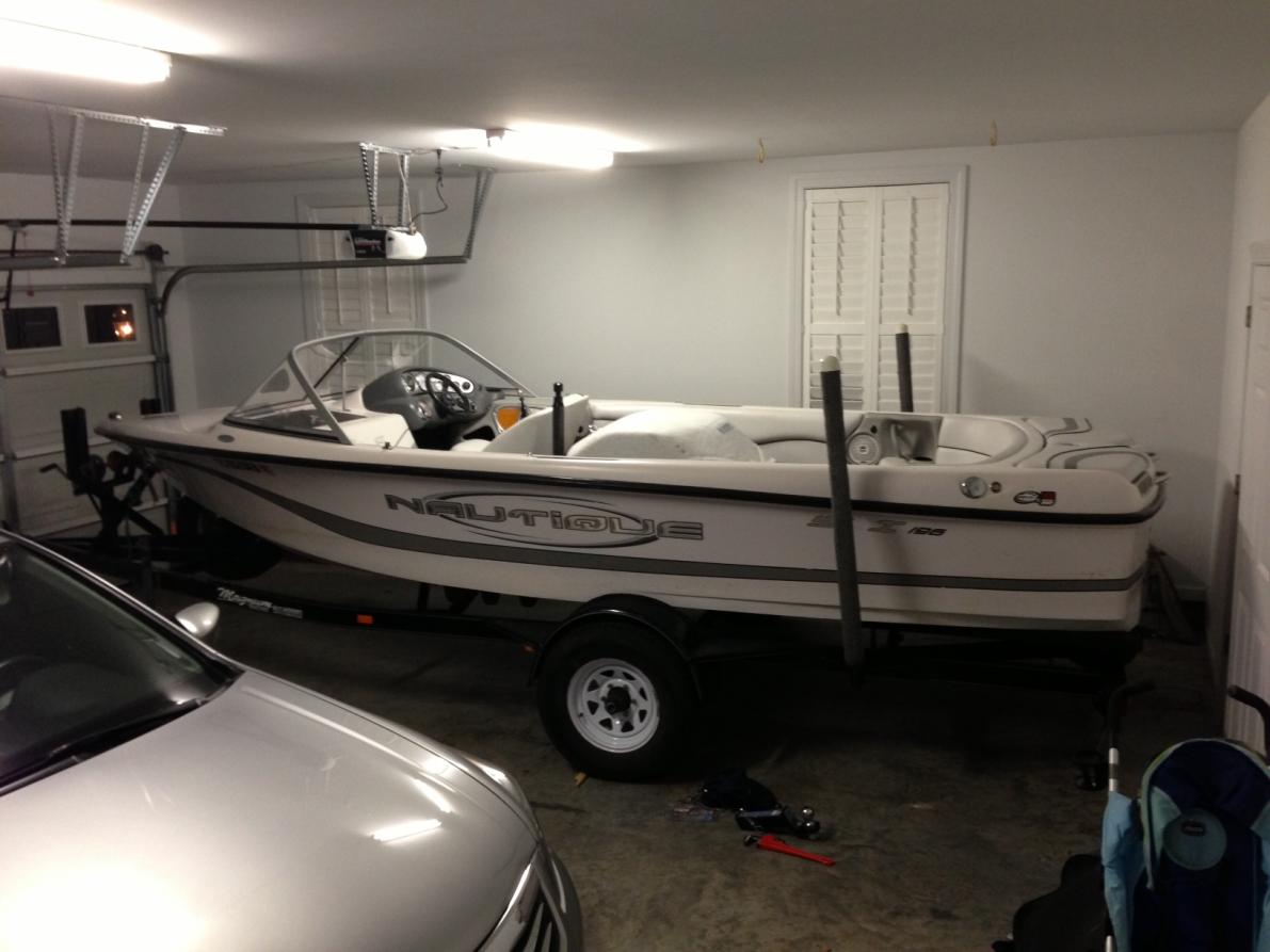

    Always wanted a closed bow Nautique, found a great deal last summer. Needed a bit of work...

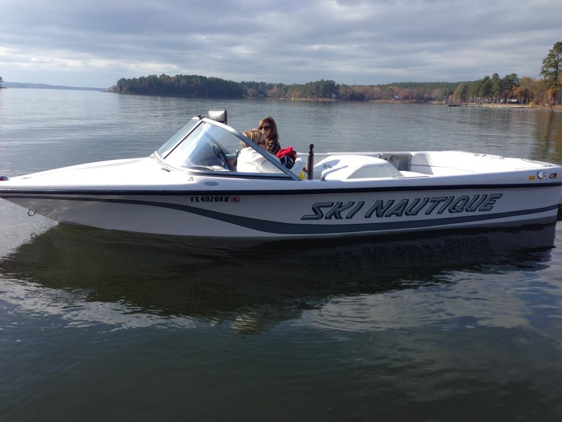

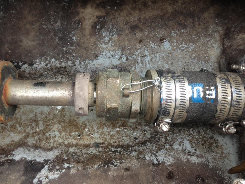

    Took it to West Point Lake on the way home to SC. The shaft log was pouring water into the boat. Luckily, simple adjustment and it's been fine since.

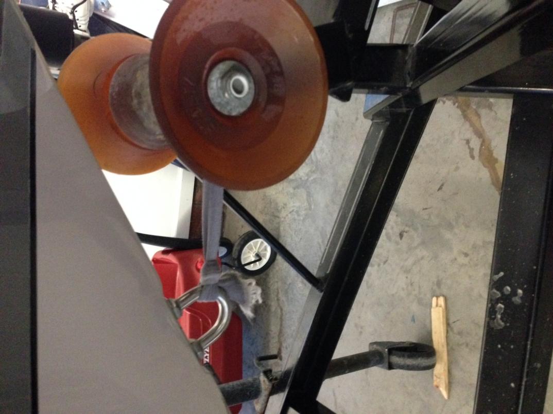

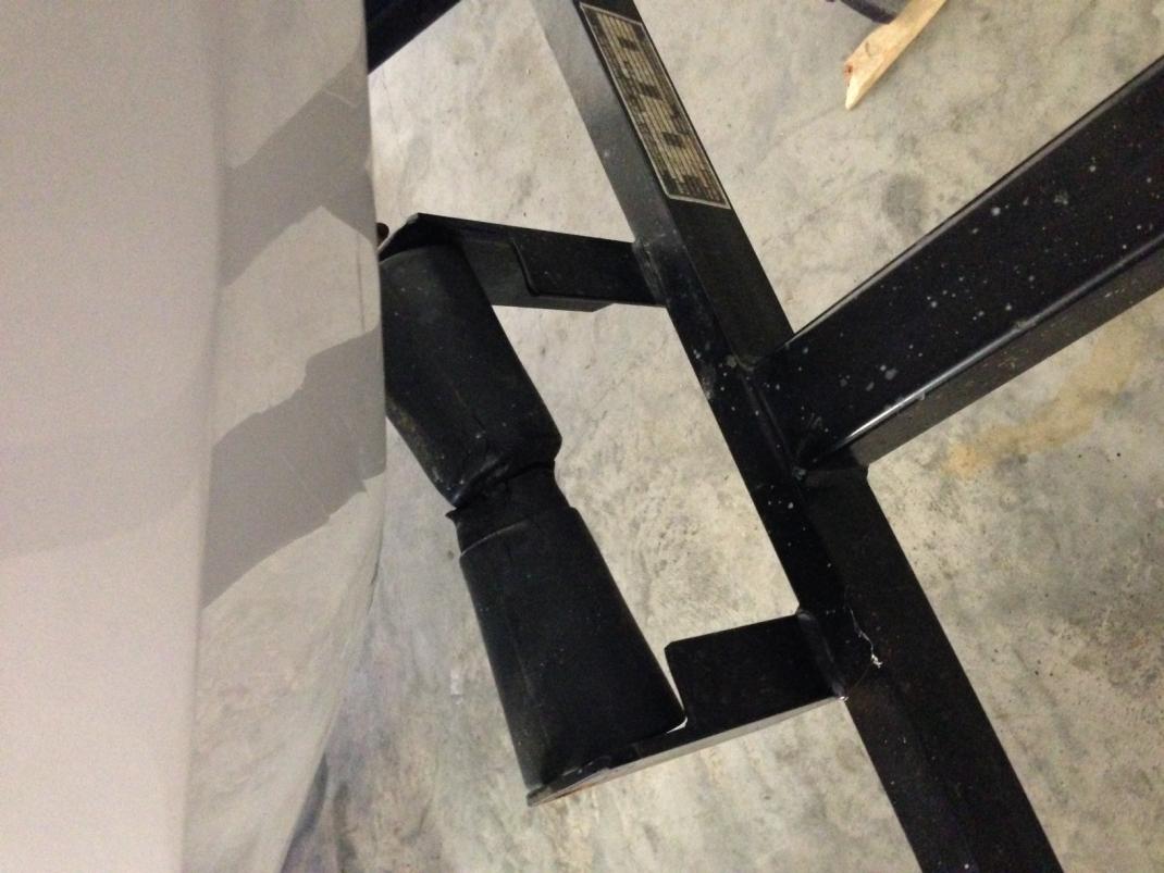

      Trailer needed a bit of work. Tires were original, 10 years old. Bearings hadn't really ever been lubed. None of the lights worked. As the picture shows, the winch was a little sketchy. The bow roller was broken so the boat rocked up and down about a foot while trailering.
      • Viper driver
        • Aug 2013
        • 21
        • Columbia SC
        • 2004 SKI 196
        once the trailer was safe....

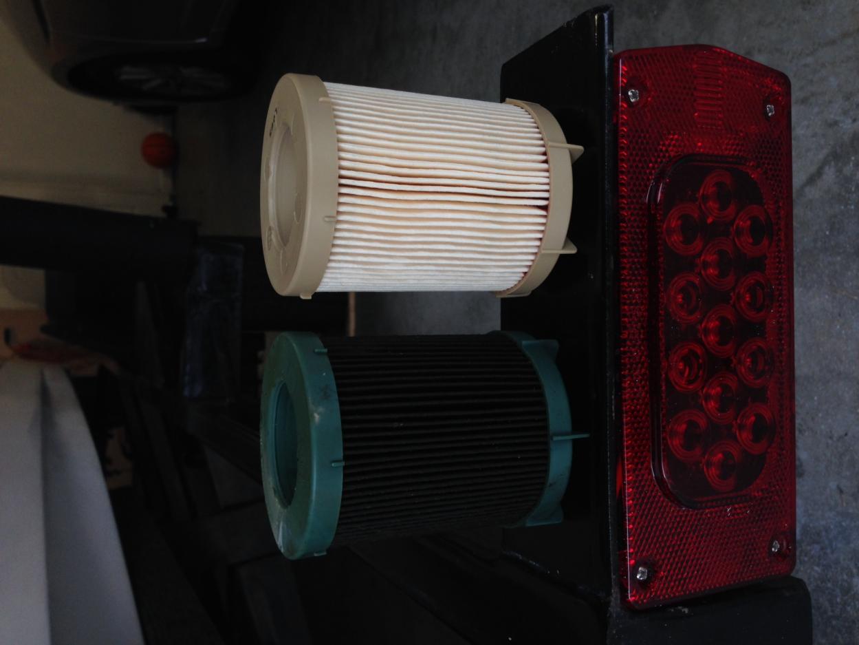

        after the trailer, and once the stream of water running in was stopped, on to other stuff. First changed all the lubricants and plugs. Changed the fuel filter, sure looks better if nothing else.

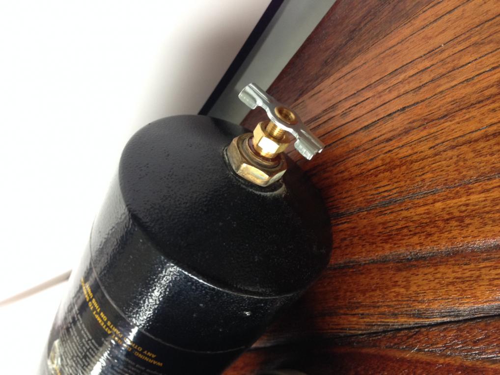

        Added a petcock on the bottom of the water trap so I could drain it without taking the whole thing apart.

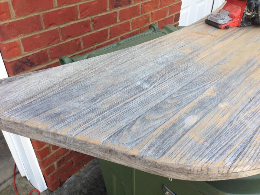

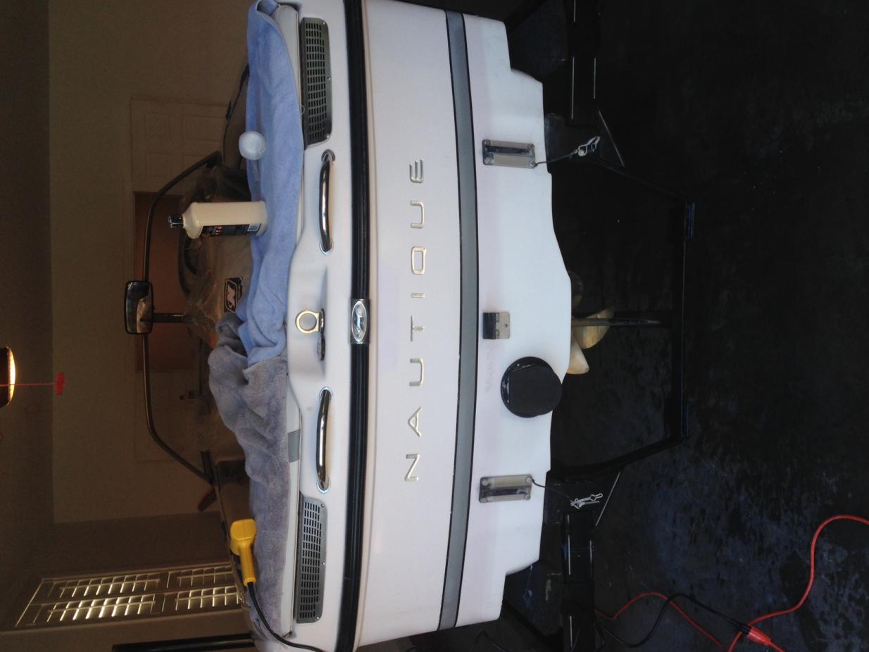

          cosmetics
          now on to the cosmetics of making it look better

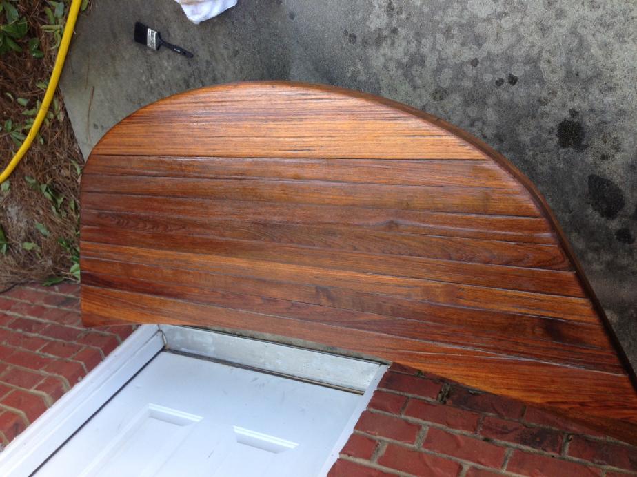

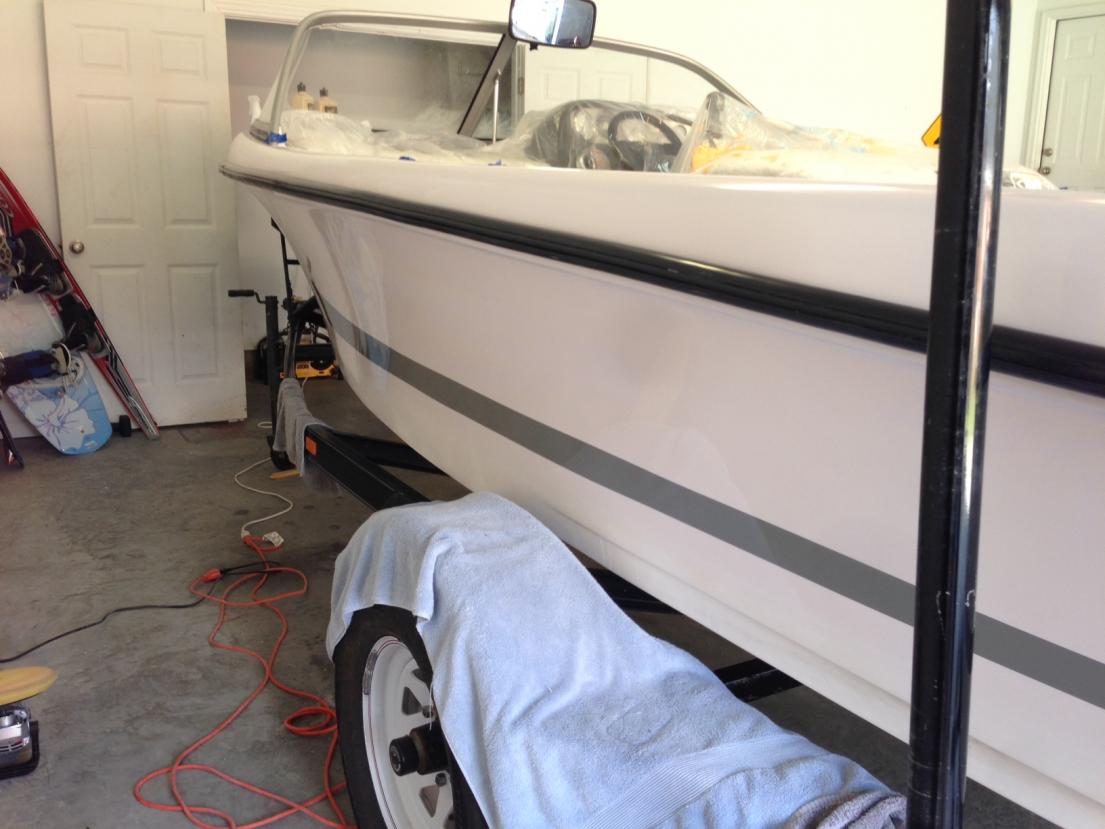

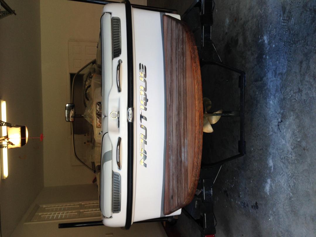

          removed all the decals and striping, wet sanded the entire boat. Refinished the platform. Added new decals and striping.

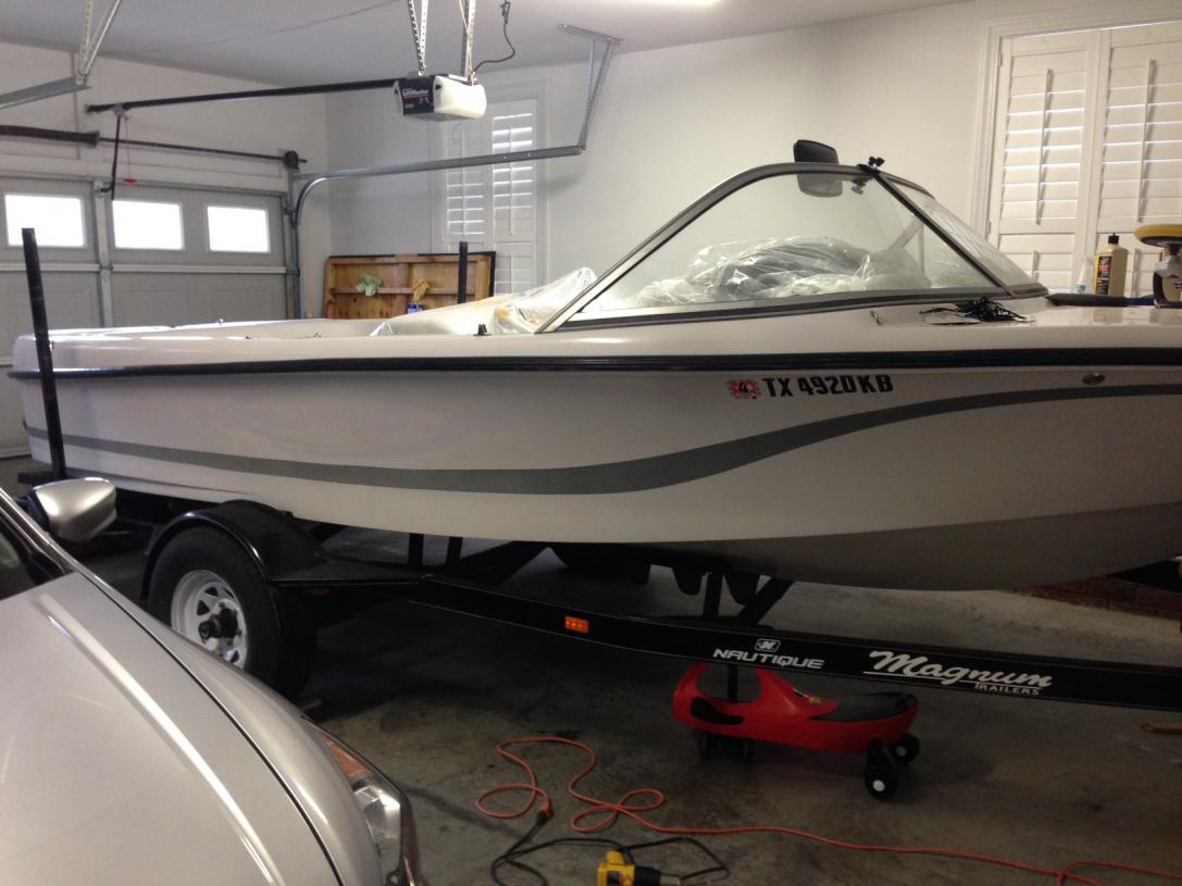

            new decals
            new decals

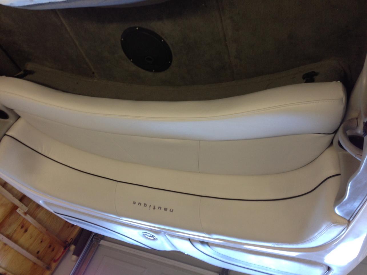

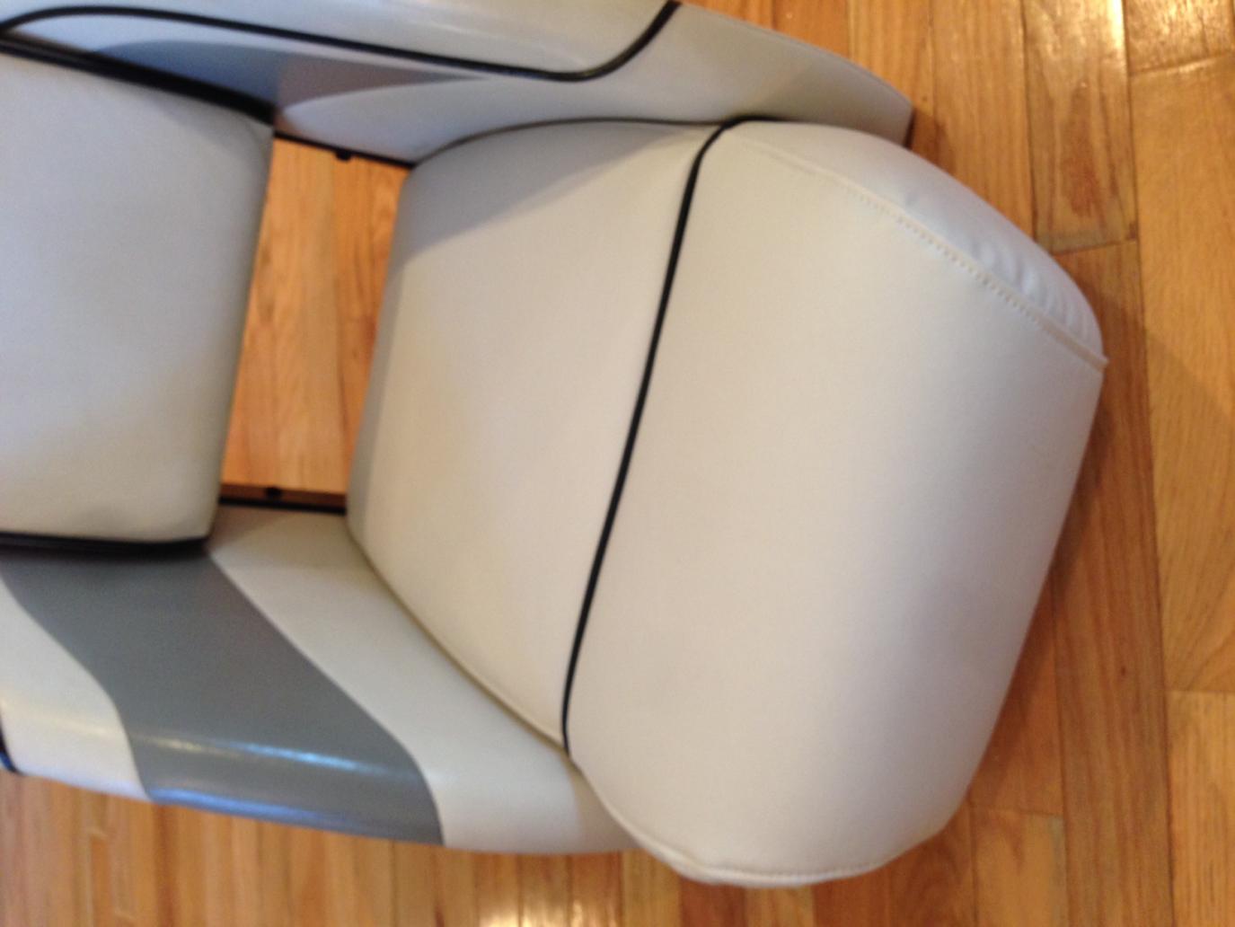

              new vinyl
              went with nautiqueskins and did it myself. outstanding product, and I'd have someone else do it next time. totally not worth the hassle, and took a lot lot longer than I thought it would.

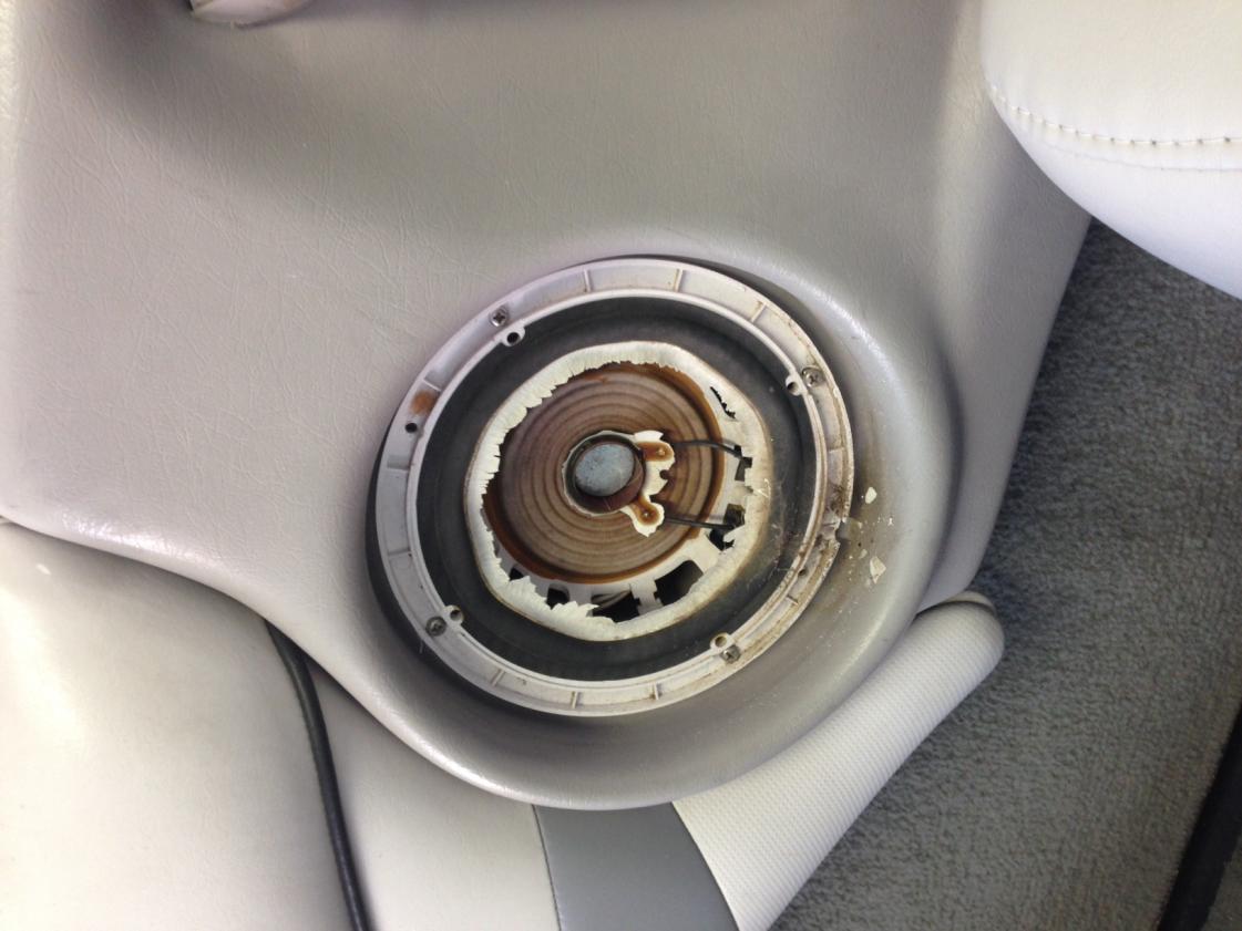

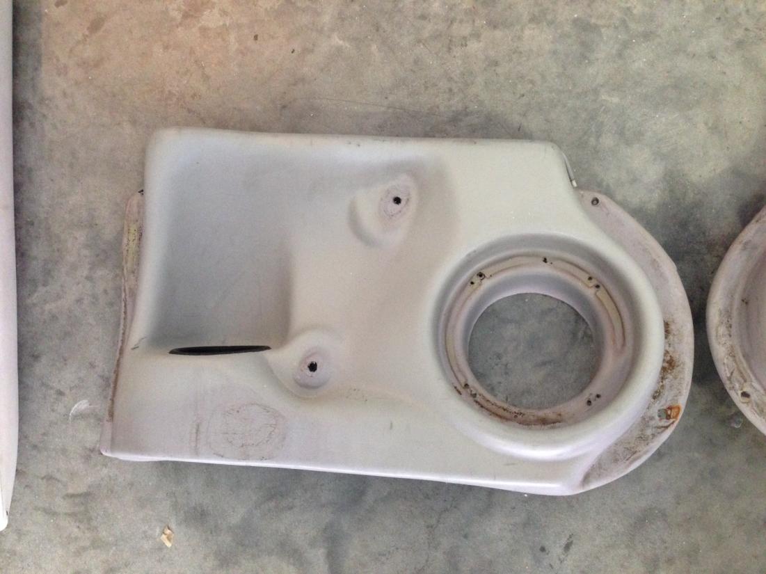

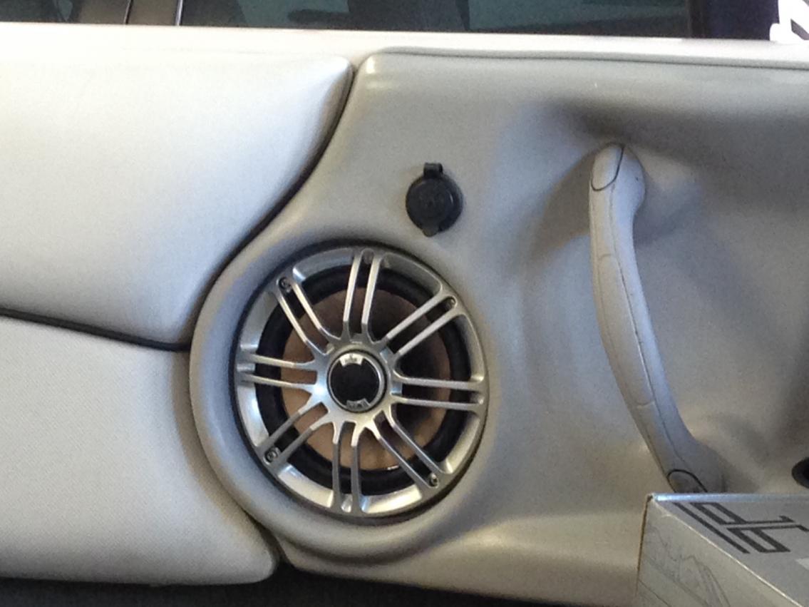

              The speaker surrounds were a mess. I had to rebuild them using fiberglass. Obviously needed new speakers as well.

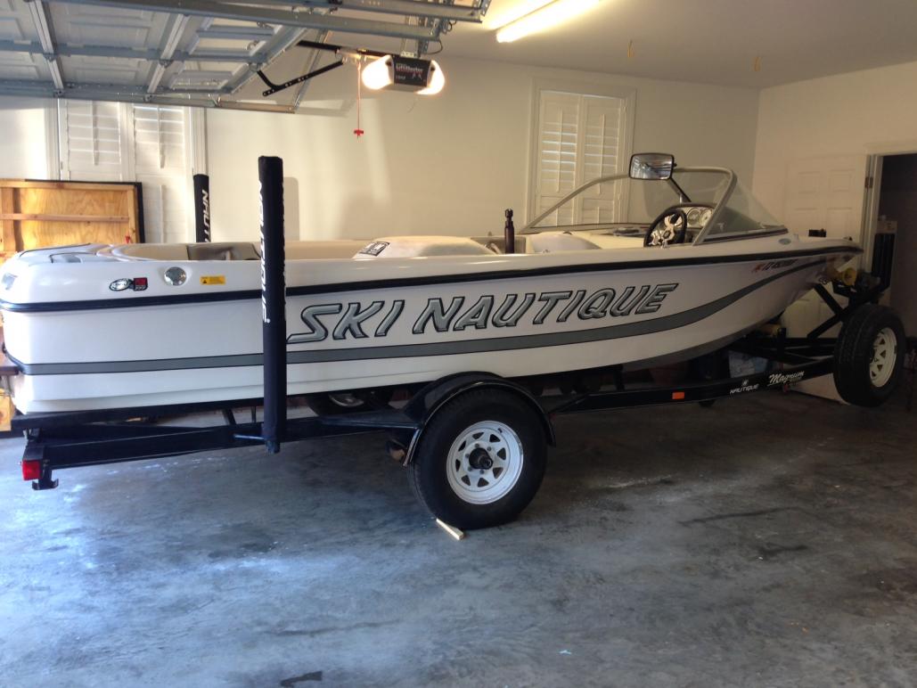

                other new stuff
                looking good.
