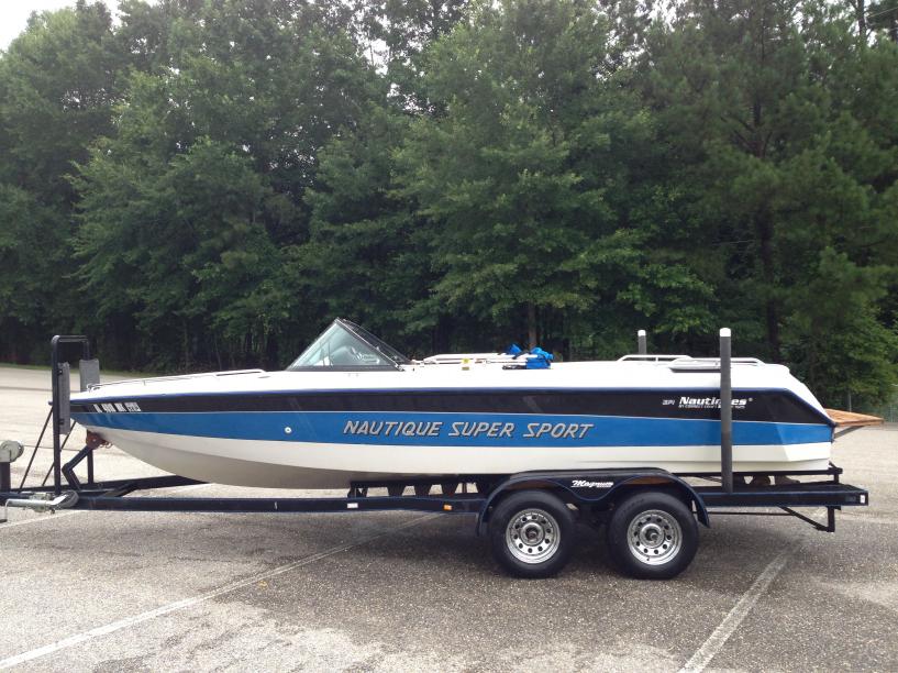

    My first Nautique, very excited to build it up!

    Congrats on your first Nautique! That is a fantastic blank slate to work from. Keep us posted on the progress.

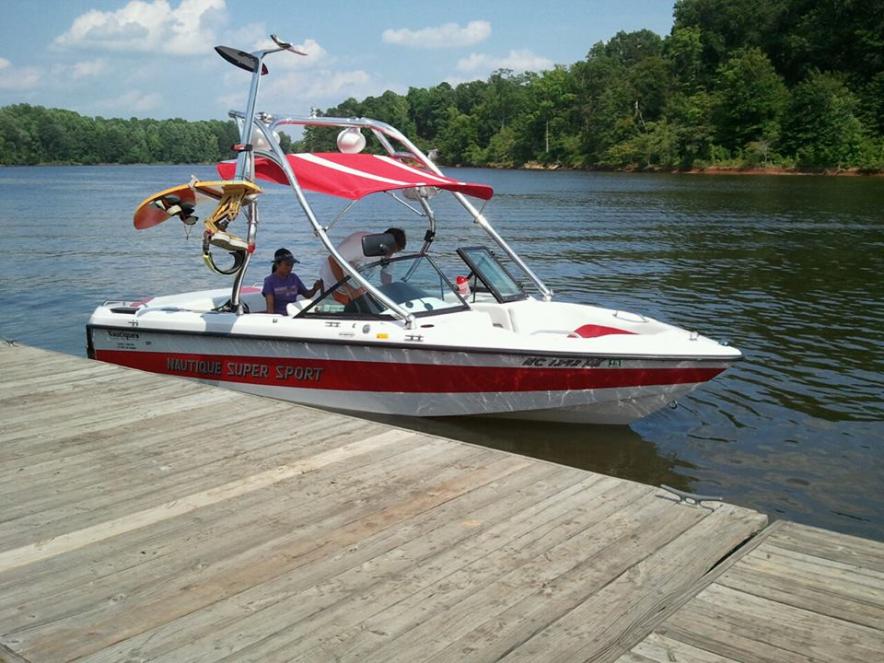

      nice! just finished my 99 super sport I bought last year. awesome boat

          Nice looking Super Sport, looks very clean. What are your plans for it? They are a little pricey but if you are thinking of adding a tower you should check out New Dimensions because they have an FCT clone that will look great on your boat.

            Thanks Shawn! You are correct, very clean with 567 hrs. The interior is excellent. I plan to put a black powdercoated New Dimensions FCT tower, ballast system, wet sounds stereo. Of course all this will be over a period of time. Tower will be first, not sure if I can do the install of the tower myself though.

                      Hey brichter, I was very lucky. I have been looking for a long time as well and come across a listing on boat trader from a dealership, called and they still had it, two days later I had the paperwork done. There is some cosmetic things I need to do like polishing light oxidation, touch up paint on the windshield, paint the trailer, then other things like getting all the gauges working properly, more teak oil on the platform, but very happy overall!!!
