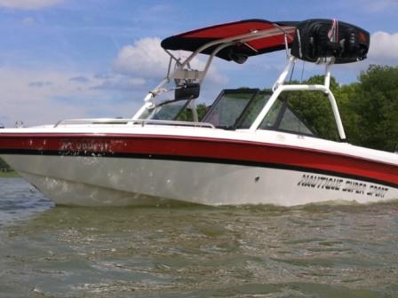

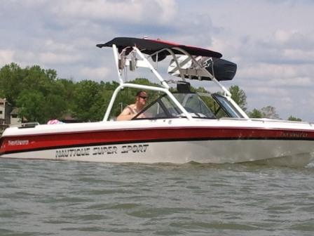

    Three year project complete! A special thanks to Brandon Cruse at Central Ky Inboards and alll the people on here that post DIY threads!

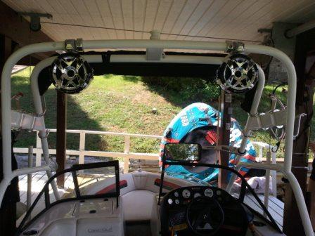

          Installed tower, bimini, tower mirror, flight clips, Exile XM7 tower speakers spin 360 degrees, ballast system, Ipod ready head unit, Exile amp, 10" Kicker Solo-Baric & Kicker amp, GPS Perfect Pass, new stearing cable, reskinned rear seats, stainless steel cup holders, stainless steel Nautique step pads, Pergo switch & second battery, buffed, polished & waxed! Ramlin trailer got new wood & carpet. Actually it was done last summer and I am just getting it on here so it was just over 2 years.

            Also added a tower navigation light that is folded down.This is all the pics I have til spring Click image for larger version

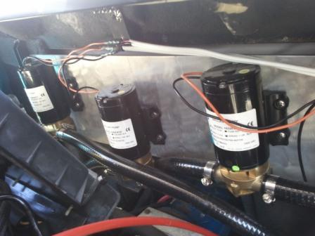

                  I was able to build it the way I wanted. More ballast, quicker fill and empty in the '96SS than the '02SAN, better tower speakers, new GPS PP holds the speed better especially around turns. I also like the over the tower bimini giving you more headroom. I never did like the pylon behind the rear seat on the '02. The SS has a heater which my SAN did not.

                        Your boat looks great! Just curious but is that a real FCT or an NDT? Either way it looks really good, I love white towers.

                          It is an NDT, I don't think FTC made one for the '96 as they have cup holders in front of the windshield which changes the dimensions of the tower. I had to put in aluminum mounting plates(supplied by NDT) inside the hull at the front feet of the tower and fiberglass them in for reinforcement.

                          I did replace the cooler drain with SS, but changed it to the center ballast overflow/breather and plugged the cooler drain hole. Also added port and starboard SS overflow/breather and changed out the bilge with SS. The pumps are reversable so they dump out underneath where they fill. SS cup holders were a great improvement also as the old plastic one would fly out when trailering if not removed in front of the windshield, for those I had to open up the holes a bit so they would fit.
