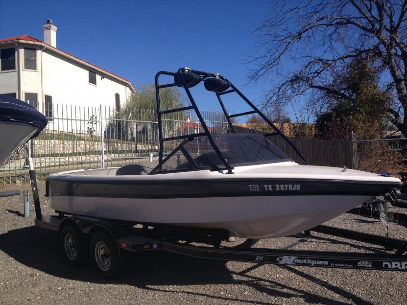

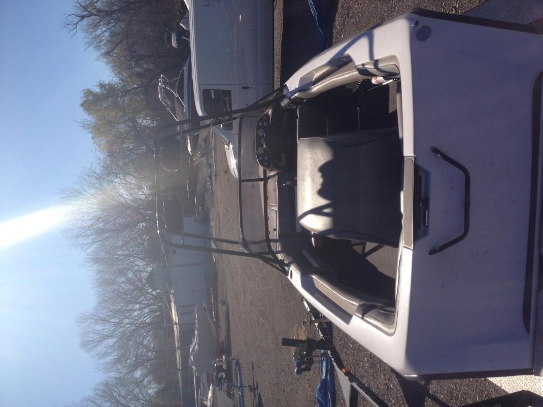

    1st nautique... To my knowledge its a 1996 ski nautique
    First post of my first nautique. Got it dirt cheap and plan on adding some sound and lights and a bimini on the tower. Any suggestions for what brands and location of speakers/lights? Thanks in advance!!!!

    The hull number stamped under the rub rail in the back corner will give you your year. No title?

      Ski nautique fo sho. Not sure it is a 1996 though as they had a clamshell motorbox. Looks to be 94 or 95

        Here's a link or you can search hull number. http://www.planetnautique.com/vb3/sh...ht=hull+number . If you look on the back of the boat on the drivers side under the rub rail there will be a hull number there is a letter that tells you the month of manufacture and the last 2 numbers are the model year. I believe 96 was the first year of no wood in the boat. The search function will answer alot of your questions. If you post more pictures of the engine, and interior it will help with the identity. Welcome you are going to love it.

          When you say "no wood in the boat" are you talking about panels like combing pads, etc? If so then 96 might be right. If you are talking about wood stringers then 93 was the first year they started using composite stringers in all of their boats. The only exception to that might be the Nautique Excel/BFN still had wood stringers in 93 and 94 but I am not sure that rumor has ever been confirmed.

            Ok so it is a '95 model. Just looked at the title. So heres my next question, if budget wasnt an issue what would be some upgrades you would do to this thing?

                      Sweet boat. Really like the color combo. I got a 176 last year and currently working on doing the same upgrades. What lake you planning on going to? I'm in Irving and usually go to Grapevine. Looks like your tower already has speakers. You just wanting to upgrade? My boats very similar to yours and I started a thread in the stereo section titled something like "ground up stereo build" (sorry don't know how to correctly add a like to it) that might help you out. Mines a 96 with a GT-40 and the PO installed Perfect Pass so I know it can be done. I does have the paddle wheel added through the hull and I'm almost positive it has the servo. It's the "DigitalPro" 6.5N by PerfectPass.
