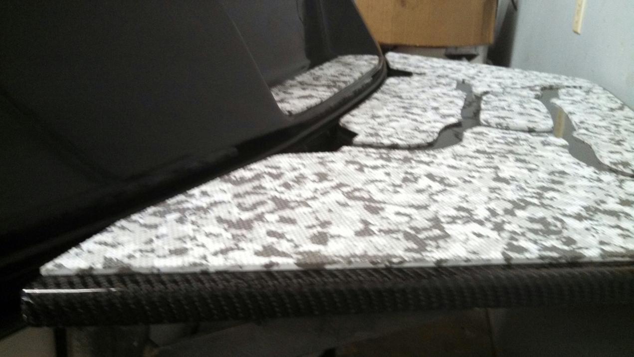

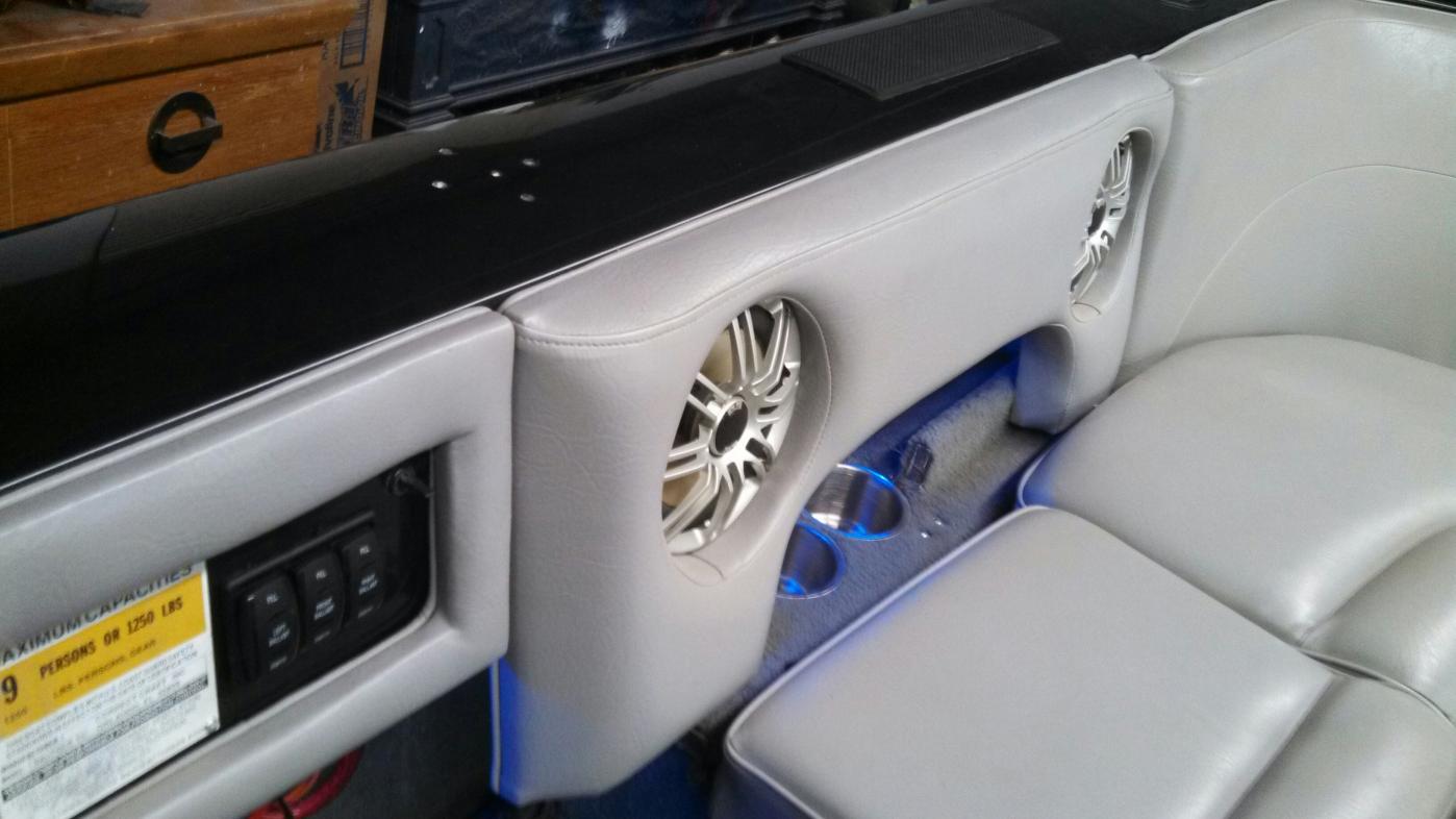

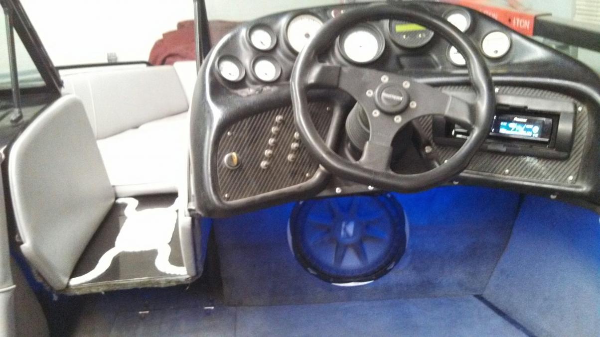

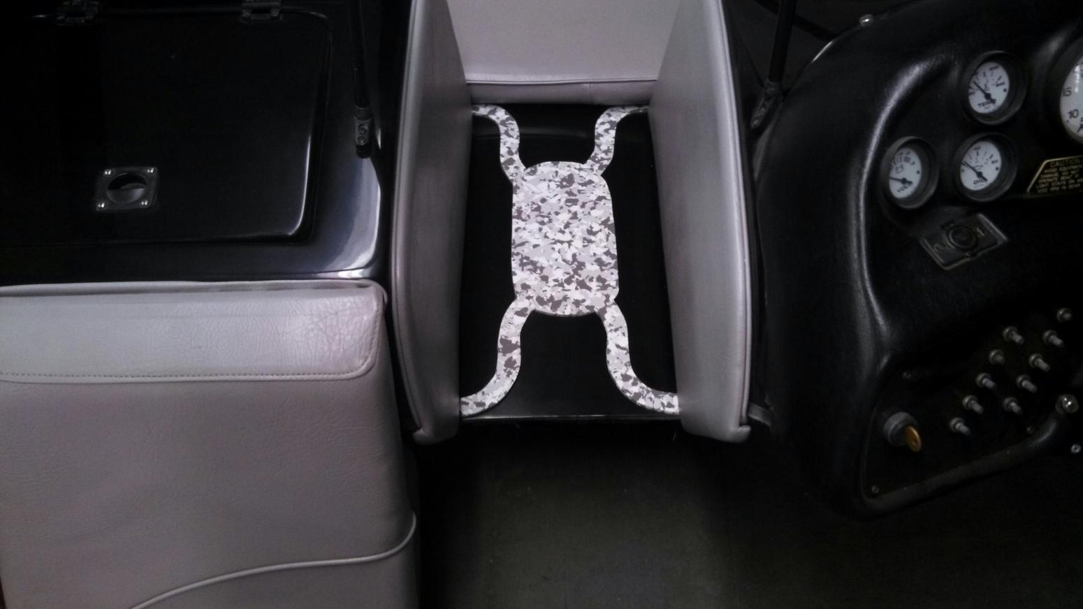

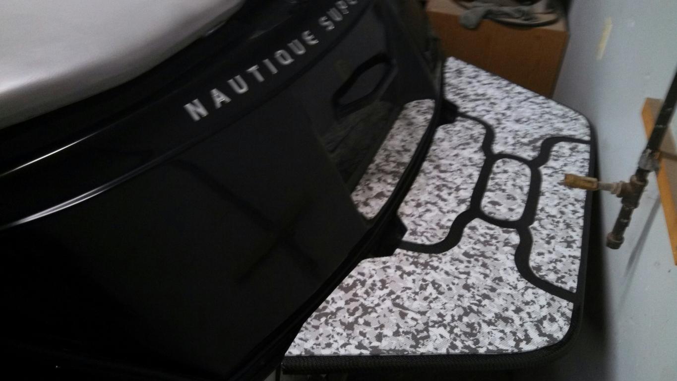

      Got the ballast system all tied up: 900's installed in the back, 650 plumbed in the bow, 3rd pump, switch covers, and new switch pod installed.
      Seadek came in, platform finished up and step pads installed. Waiting on my tower mounts to come back from being welded and then she is done and ready for summer.

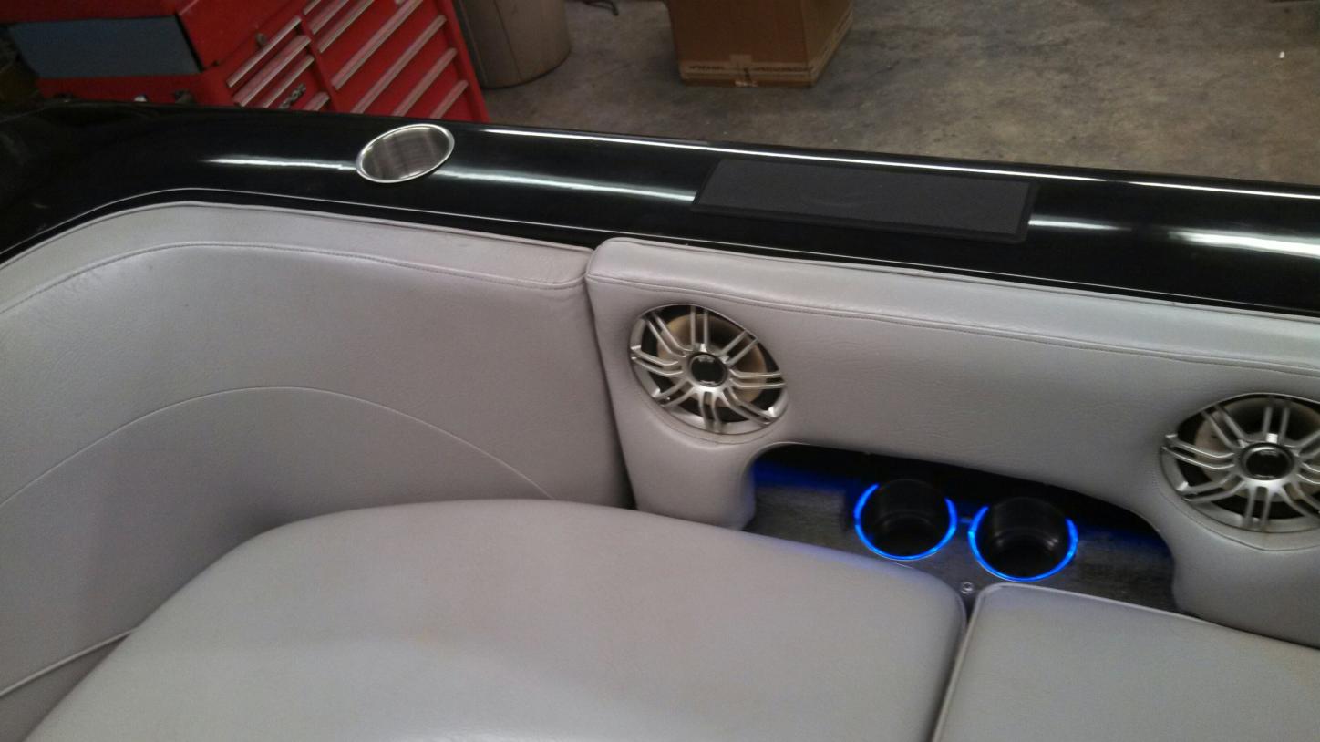

        WOW! Incredible job. That platform looks incredible and the respray looks amazing. I love the addition of the rear cupholders in the deck as well. Pretty sure I might do that this spring.

            One thing on the cupholders in the back is that there is a crown on the top of the deck so the edges of the cupholder are not flush with the boat. I have not determined if I am going to try to bend the lip of them down or just fill in the small gaps with some black 5200.

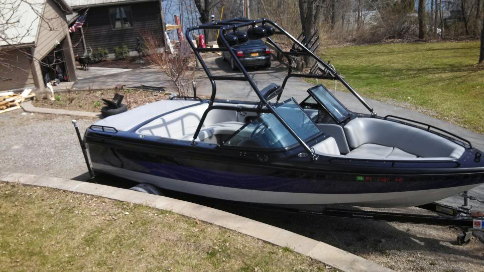

                        #86

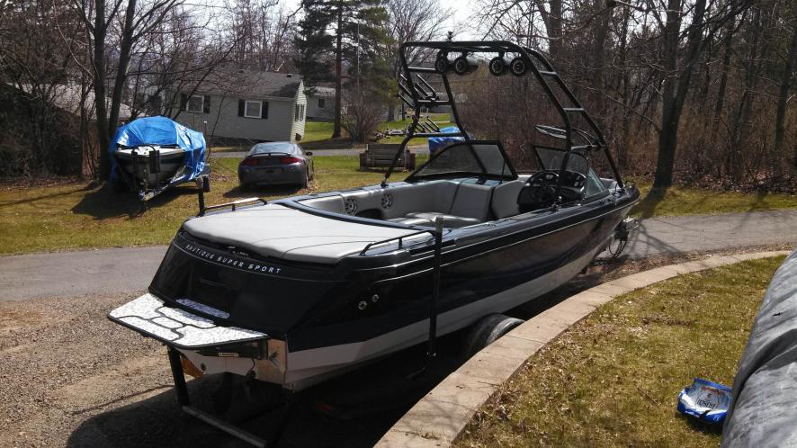

                        So I finally got to pull her out of the garage and give her a quick bath. Found some spots in direct sunlight show some imperfections in the gelcoat, but overall i am happy with how she turned out. I will get some more pics up once I have some free time. Have been scrambling all over with a million spring time projects so its tough to find the time. Anyways here are 2 quick pics of it all back together. Cant wait to see it in the water when the white is hidden.

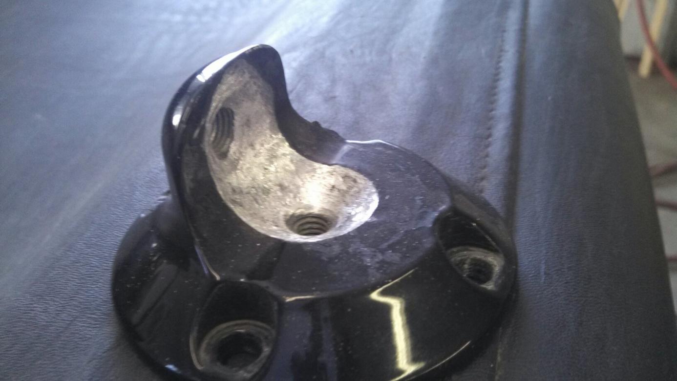

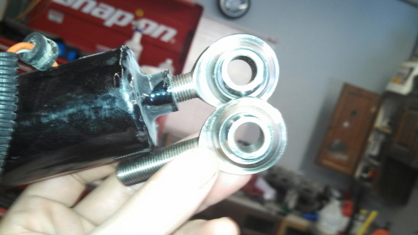

                          #87

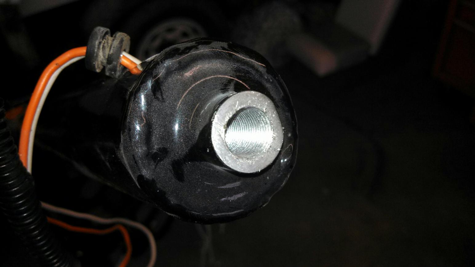

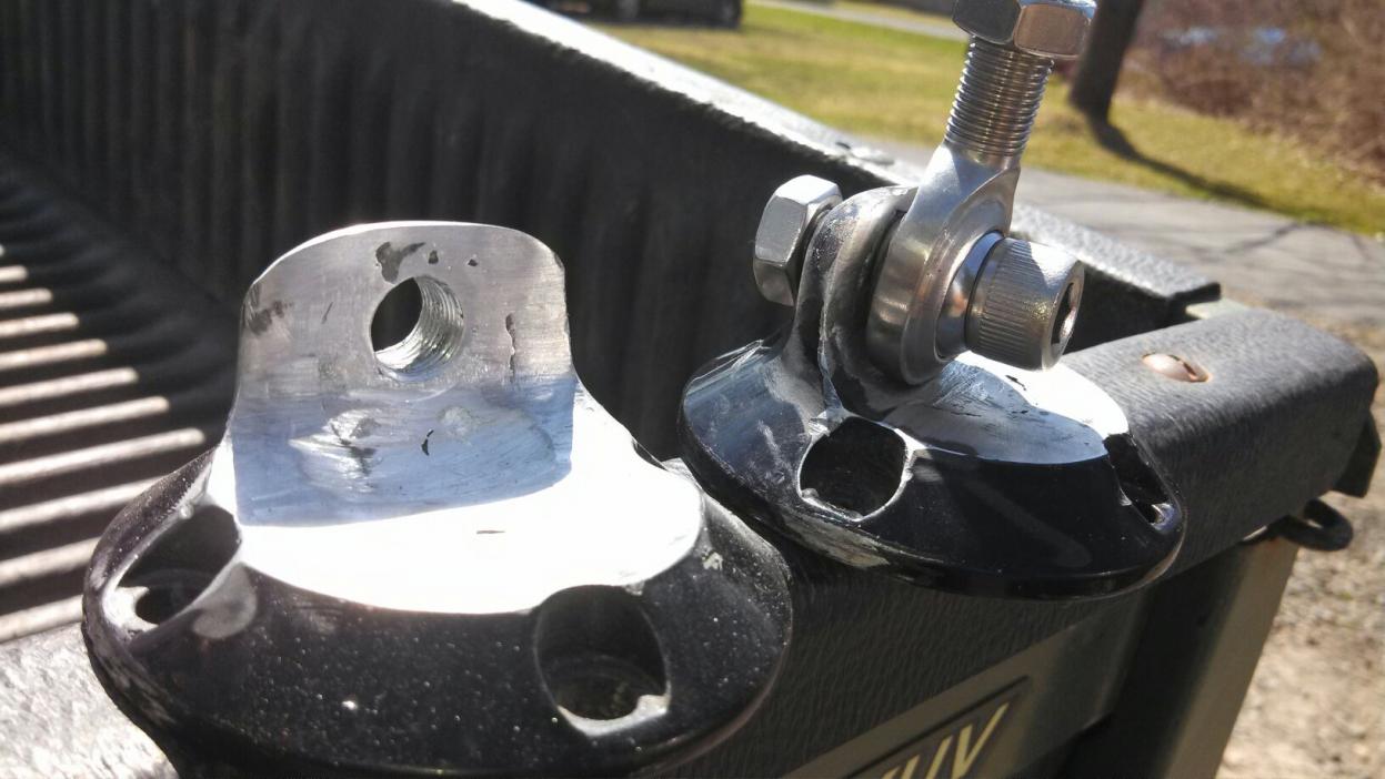

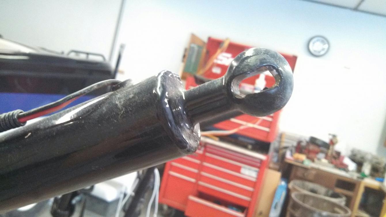

                          Quick little write up of what i did with the tower mounts. The stock mounts were a ****ty ball/socket design. I had the stock socket mounts welded. I then ground them smooth to create a flat surface for the heim joints to mate against. Larger 1/2" holes were drilled/tapped on the bases. I cut off the stock "balls" off the legs of the tower. Drilled and tapped for 1/2" heim joints w/ jam nuts. Heim joints get threaded into the tower legs. Overall I am pleased with the turn out. I still need to fill a little more in on the bases and get them re powdercoated next winter. The tower still sways some but less than it used to. Also the heim joints help take a lot of the stress off the fiberglass and gelcoat. I am happy for $50 in parts + my time.

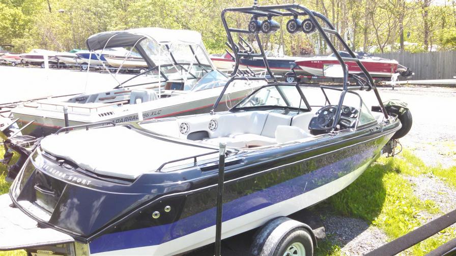

                                #90
                                Getting a custom cover made from the local upholstery guy so i decided to hit it with the buffer again while it was out of the water. This 2nd round really brought out the deep shine to it.
