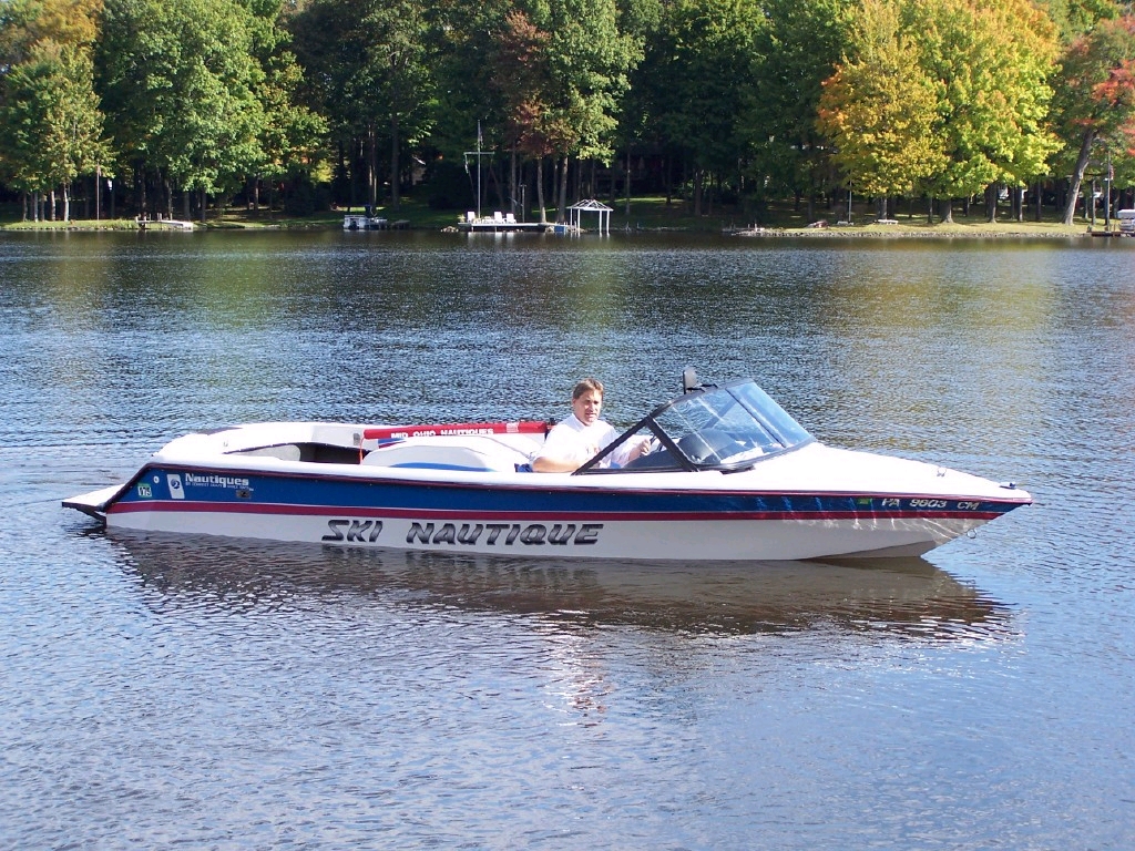

My dad and I bought this boat brand new in 1994. I do a ton of slalom course, trick skiing, kneeboarding, and barefooting. My brother is an accomplished kneeboarder, and a strong slalom course skier. Our boat has close 1400 hours on after the close of the 2008 season. Despite all the use our boat is still in near mint condition. We have the 351 PCM carbureted engine with 240 horsepower and the 1:1 transmission. We just had Perfect Pass Stargazer installed last spring. It works just like they say it does. The main advantages a Ski Nautique has over its competition is it is the most user friendly for the driver, the hull and structure are very solid second to none, best tracking, and its skiability/wake characteristics are less effected by adverse conditions. The key is keeping fresh oil in the engine, winterizing it properly, and detail it on a regular basis. It gets a full detail job before going away for the winter, and then a monthly maintenance detail to keep it clean. A boat lift is a must!

I live in Ohio, but I keep my boat in Pennsylvania. The lake in the picture is in western Pennsylvania. We usually start skiing in April, and ski into mid to late October. Keeping the bottom waxed makes the slalom wakes smaller. A friend of mine has the same hull, and it has a slightly bigger wake. Guys on the lake who have newer ones bust my chops asking me if my boat still runs. I bring it in for a tune up to a marina every 400 hours. The only actual repairs I have had to make are, replacing the alternator at 1300 hours, a couple of seat skins, and one steering cable at 800 hours. The prop is getting its first overhaul.
