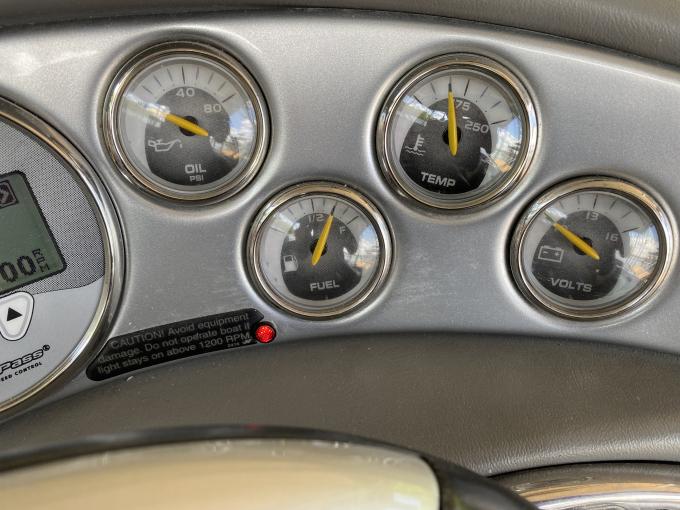

    If you have one for more Faria gauges that have gone bad read on. These are the "analog" gauges generally to the right of the Tach and Speedometer. My 2006 SV211 has 4 of them (Oil Pressure, Fuel, Temp, and Voltage) as shown in the attached picture. I was able to replace the Temp gauge several years ago before they were not available. Now the other 3 have gone bad. These gauges are driven by the Faria Gateway using a proprietary serial bus and are "daisy chained" from gauge to gauge. I think that many failures are blamed on the gateway or bad wiring when in fact the gauges have gone bad. There are "upgrades'' available but if you want to maintain the original look of your boat you CAN fix these gauges.

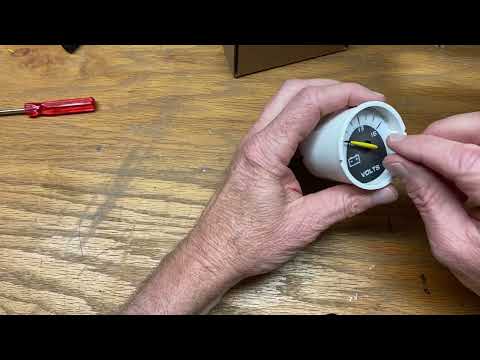

    I have created a short YouTube video outlining the procedure. Please don't make fun of my cinematography skills.....
    Leave a comment or private message me if you have any questions.

              I just wish there was an easy way to get that bezel off and then on. Maybe Faria would sell me their old machine..... :-)
