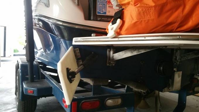

    That’s awesome if that’s an automated set up! Any shots of under the swim platform and how you mounted this equipment?

      Cool. More info would be great.
      What did you use for a controller?
      Are they lenco rams?

          I did use Lenco Rams. I don't have any pictures of the underside of my 210. Here are some pictures of the underside of my old 2005 211 team. This was my first attempt. Worked great on both boats. I'm not using any type of controller just running through the battery and to The Rocker switches

            The hull design on the 210 wouldn't allow me to put the size of high density polyethylene plates under the deck that I used on the 211.

                    Awesome! Thanks for sharing. I’m definitely interested in pics of the wake both deployed and not deployed. Did you sell that 211 without any trouble having that in there? Also, did you bolt those pieces all the way through the hull or just screw into it? That’s a lot of mods to the hull making me nervous right there. It looks nice though

                      You can definitely feel it is deployed, you get used to it. Rams are deployed or retracted in about 3 seconds. If you don't like the drive experience they are easy to pull in and push back out. I leave them out and make adjustments to how I pick up my Surfers.
                              No trouble selling 05 211. they have had it all season last year, never heard anything from them on problems. the hinges and ram are screwed in. pre-drill, fill hole with silicone, stainless screws, done. made me nervous as well (even more so on 2011 boat), cant imagine being without now. had to mount both systems very differently based on hull design of 211 vs 210 both had great results. since then i have plumbed in 3 fatsacs to the boat for additional weight. just keeps getting better
