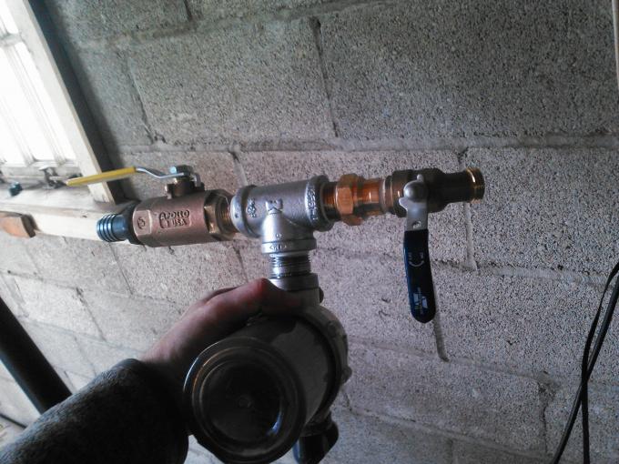

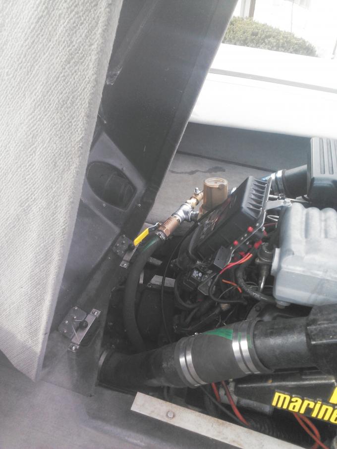

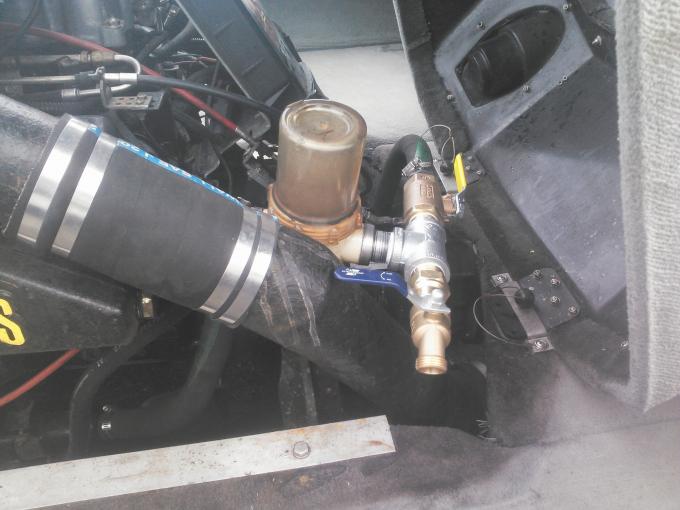

This is my home made engine flush/test connection. With this I can connect a hose directly to the engine and draw water from a spigot or a bucket to run the engine in the driveway. It can also be used to fill the engine with antifreeze in the fall. I do not suggest running the boat from a spigot. The cooling system is not designed for high pressure. The typical automotive cooling system pressure relief valve is 14-18psi, my water pressure is 88 psi. I have a 5 gallon bucket I am going to fit a bulkhead and hose bibb on which is where I will connect to. The hose from the spigot goes into the bucket to keep it full.
After looking up what was available all I found was a plastic check valve, which looked cheap and unreliable. My solution did not save me any money over the $90 check valve available online, but it is never going to break or wear out.
Piping is 1" for this boat. I got all of these parts in the plumbing section of Lowes, cost about $85. Could have been done for a fraction of that price if all plastic was used, but I was going for maximum reliability and durability. If you use plastic I suggest you use CPVC not PVC, CPVC tolerates a higher heat range. Joints were sealed with plumbers tape, no special tools required.
