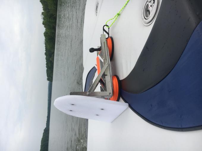

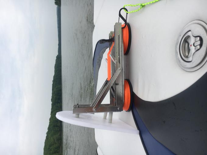

Gentlemen I Give you: FoldGate Total V 1.0 (Sorry for the head tilt, I can't seem to get these to rotate)

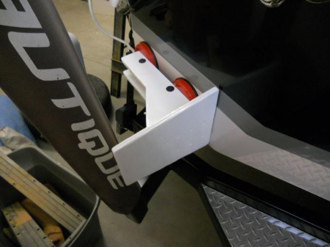

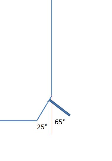

I actually left at 90 Deg. Here is a pic of it installed to have reference where I place it.Originally posted by Kingfish126 View Post
did you put it at an angle or keep it at a 90 degree?
I rough measured the angle on the boat about 25 deg. So with a 90 Deg plate I am guessing about 65 deg is where it is from parallel to the boat.
That's the over all conscious ive read on the wakeworld forum(deleted) and the mastercraft forum, that 60 degrees or so is working the best for panels size around the 8"x6"Originally posted by gome123 View Post
[ATTACH=CONFIG]n489347[/ATTACH]

I think that if you're putting the gate at the hull angle then 90 deg is a must since you're already on an angle. With my gate, the angle is 60 deg and I put it in front of the angle in the hull, facing the bow and it works perfect. As for depth, I weight my boat, then while making sure the boat is level(ish) in the water, I put the gate so it's half out of the water. Makes a nice peaky long wave.Originally posted by Evening Shade View Post
