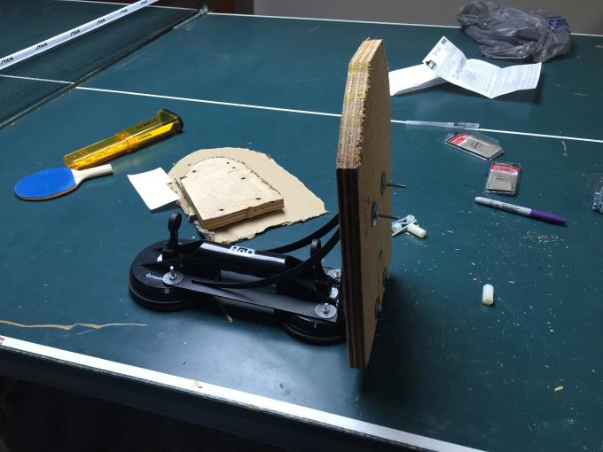

              Here's my 8 bucks and 15 minutes of effort... Total knock off off one of the guys over at TT... blew out a pump impeller yesterday, so couldn't really test it, but with no ballast in the boat it certainly cleaned up one side. Try again this weekend with working ballast...
                Sent from my SM-G900V using Tapatalk
                Crime dog,
                that looks really good. How did you attach the wood to the Handle on Demand device? I can't see any exposed screws.

                  Kinda tough to see, but you take the cups off and screw the plastic into wood. Once I figure out how this works, I build a nicer one out of hdpe or some other material.

                    Thanks Crimedog. Was it difficult to get that screw screwed in there? I have my Handle on Demand on order from Amazon and I'm gonna try making one out of composite decking as that's available at Lowes. I would have to order HDPE.

                      Nope nothing to it. Once you get the HoD it'll make sense, but you push up on the cup, and there is a pin holding the handle on. When you get the pin out, the cup comes right off. Then I just traced the OD of the HoD on a scrap 1x8, and just jig sawed (poorly I might add) holes big enough for the handle to pass thru. Then drilled pilot holes and ran some screws thru the plastic into the wood. The tab is 6x8" with roughly a 15deg angle towards the back. The composite decking is a good, easy idea.

                          crimedog,
                          So you used 1"X8" board to mount the HoD and for surf gate? Looking at the pic I assumed it was 1"X6".

                            Yep, just a scrap 1x8. the HoD is (if I remember) ~4.5" wide so a 1x6 would work, I just didn't have one laying around. Like gmustangt said, you can probably skip the screws holding the HoD to the wood, once you suction it to the boat it's not going anywhere. But I would definitely have a tether on it as an added insurance if it does come off the boat, it sure doesn't float.
