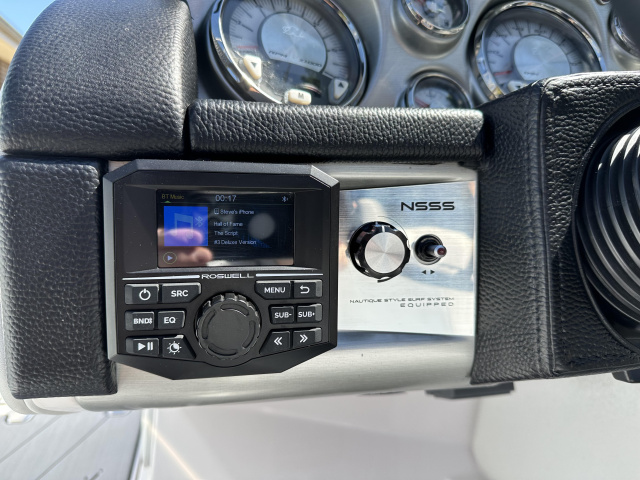

            G'Day l0rd0s
            More than happy to help you out on this if you have any questions we have installed an NSS style system on our 2008 210 here at Inland Marine Australia. As to Ballast when surfing our 2008 we currently run 2 1100LBS in the rear lockers, centre ballast full, arrow bag piggy backed off the centre tank as full as we van get it then we have a 425 integrated bow bag as full as possible under our bow cushions. Steve Inland Marine Australia
