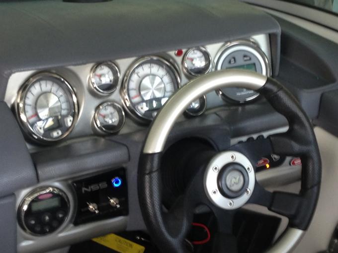

      Ok gents on to the final stage of installation.
      Trying to determine where to install the NSS switch. I went with the Lenco single ram led kit. It has led Lights to give you an idea of where the tab is deployed . This will allow you to customize the NSS how far you want it deployed and be able to go there every single time. It also has an auto retract feature that when you power off the boat pulls the NSS in completely. Only feature you lose compared to the factory system through LINC is that it won't auto retract after a certain speed is reached. So let's hear it.
      I've been thinking that I might have one of my EE buddy's make me a board to trigger the auto-retract based on over and under speed... I really don't want to forget that I have them deployed when I put it on the trailer.

        Bingo! Thanks again for the option 5 scenario

          Wow! That looks perfect.

                      #25
                      I went with the same location on mine, haven't used it but once, but I like it so far!

                        #26
                        That looks great.

                          #27
                          Yikes Swatguy, you need to step up your game, that Georgia boy way out pimped your dash panel, lol

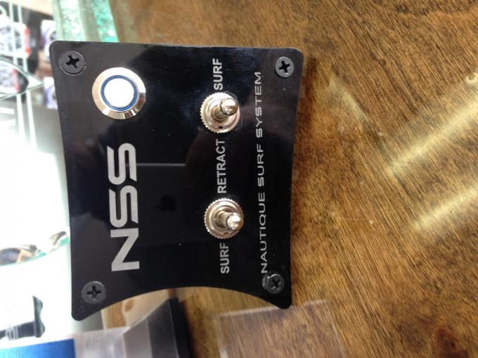

                            #28
                            I was going to go with the Lenco switch, but i didn't want to spend that much on it... After it was all said and done, I probably ended up having just as much invested in my switch, but I don't have auto retract or indicator lights.
