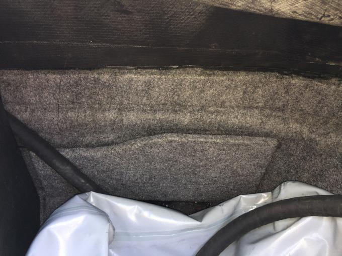

    My biggest gripe is that all the screws go all the way through the fiberglass and protrude into the v drive lockers by a good amount. I forgot to snap pics but I will add some later. This creates a huge problem for me seeing as how I removed my rear tanks in lieu of 1100lb sacs. So I have come up with two ideas for a solution.
    1) build a false wall with some Carpet or use a material like the engine dividers if I can get my hands on some. Covers up all the screw heads
    2) use a dremel tool and zip off all the points of the screws protruding in and make them flush with the fiberglass.
    Obviously 2 would be the easiest, any concerns there zipping off the tips?
    The first would give a more refined look in the compartment overall hiding the bare fiberglass that sits there anyways, but it's gonna require way more work.

      Very nicely done. You're going to love it. Of the two options you proposed for the screws, I like option two better. On mine, I went with thick rubber vacuum caps on all of the screws. I also have 1100-pound bags and have not had an issue.

          Nice job! I would just zip them off.

            Swat...I misremembered...I went with option 1 and installed a false wall.

              Zipped em off with the roto zip. Piece of cake.
