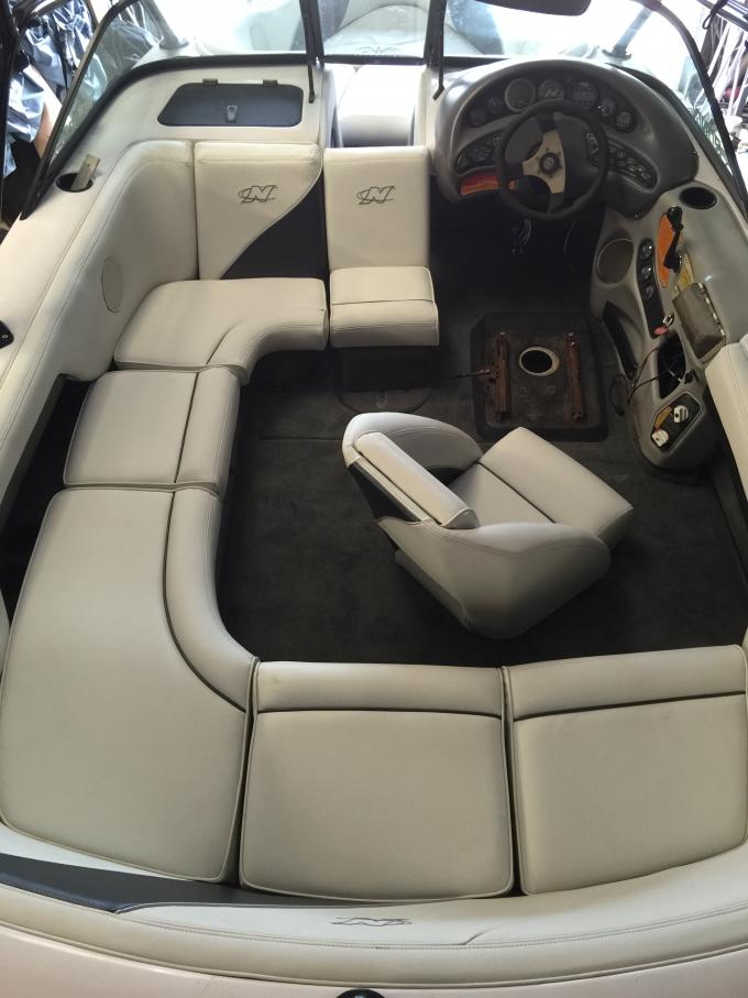

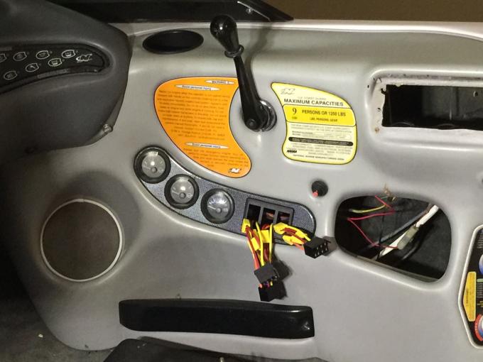

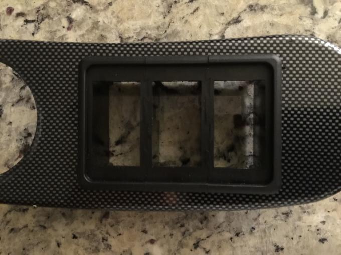

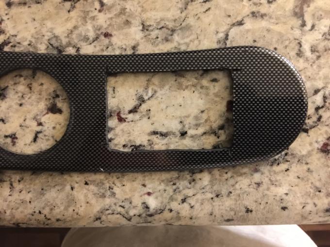

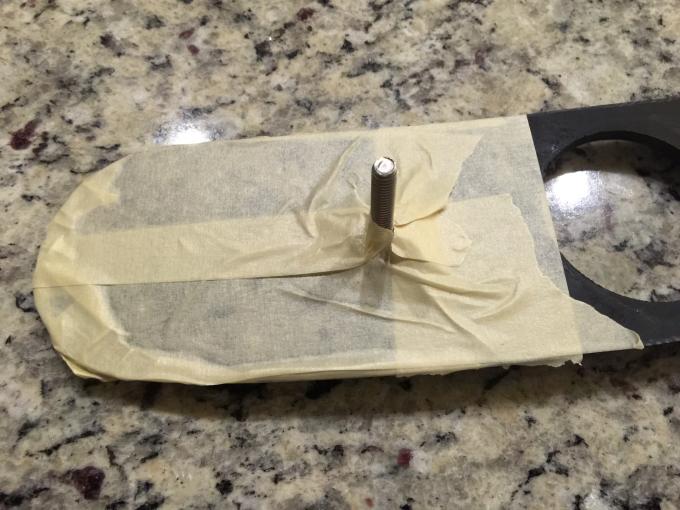

      Ballast Switches Click image for larger version
ID:	479044 Click image for larger version
ID:	479046 Click image for larger version
ID:	479045 Click image for larger version
ID:	479043 Click image for larger version

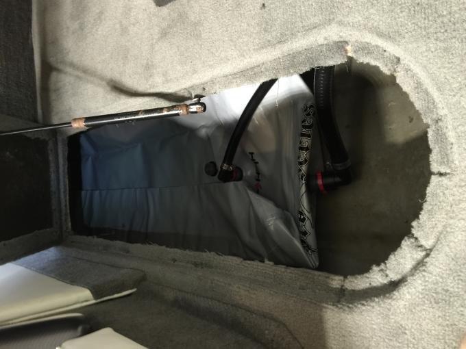

          Bags Click image for larger version

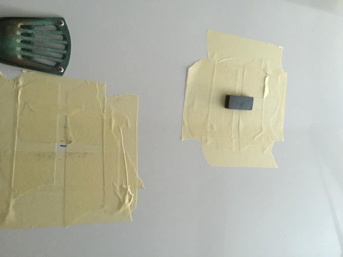

            Thru Hulls Click image for larger version

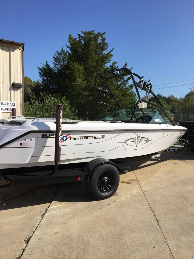

                  Got it out today. Wake was incredible. Sorry the pics aren't the best. I'll work on getting more that do it justice. I'm guessing we had 3300 lbs including people. 1500 in the engine compartments, 700 in the ski locker, 300 from the integrated bow, 300 sac on the bow seats and 500 from passengers in the wrap-around seats Click image for larger version
