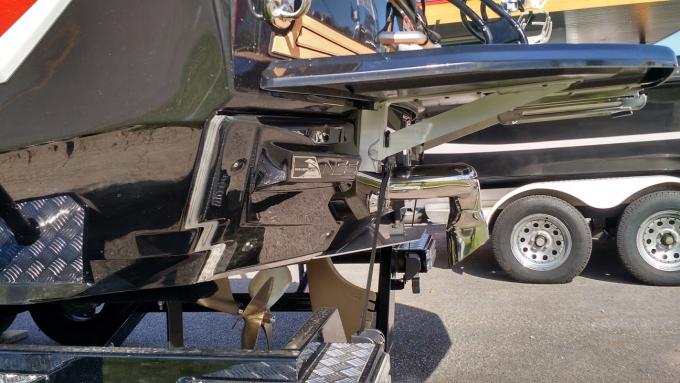

Some comparisons with and without glassface and breakdown - to get a similar effect would require an unsafe amount of ballast and major listing. Note the horizon in the first picture to get an idea of list.
Originally posted by alexbailey228 View PostI really want this for my 210!!! How much are you charging for the system?
I am not selling this, I will be giving the design away. It will be open source so you can cut the plates yourself at a machine shop, order the fasteners and actuators from Ebay/Amazon and get up and running cheap ($1200 or less). SJ30 has volunteered to provide at-cost machining for members here.
I am hoping a community forms around this project to help others get started with this type of system and improve on it.
Actuators and switch are the most expensive part of this. The rest is just small parts and time.

Sanj,
You were not kidding on the hull not being symmetrical. I see that my swim platform mount is further to the starboard side by about an inch, so, the plate will be really close to the mount on that side and then about an inch on the port side. It's quite interesting to see that on your pics that your swim platform mounts are more to the port side. I'm seeing even a little bit of difference in shape on the keel/hull corner between starboard and port sides, it may have to do with prop rotation and hull lift.Last edited by wakejunky; 10-02-2015, 05:58 PM.

.Originally posted by wakejunkySanj,
I think it might be some kind of steel bracket embedded inside the fiberglass that requires the swim platform brackets to be asymmetrical. As for the hull shape, I think it's an old school hand shaped plug that they made the mold from so there's variance of about 7mm.
