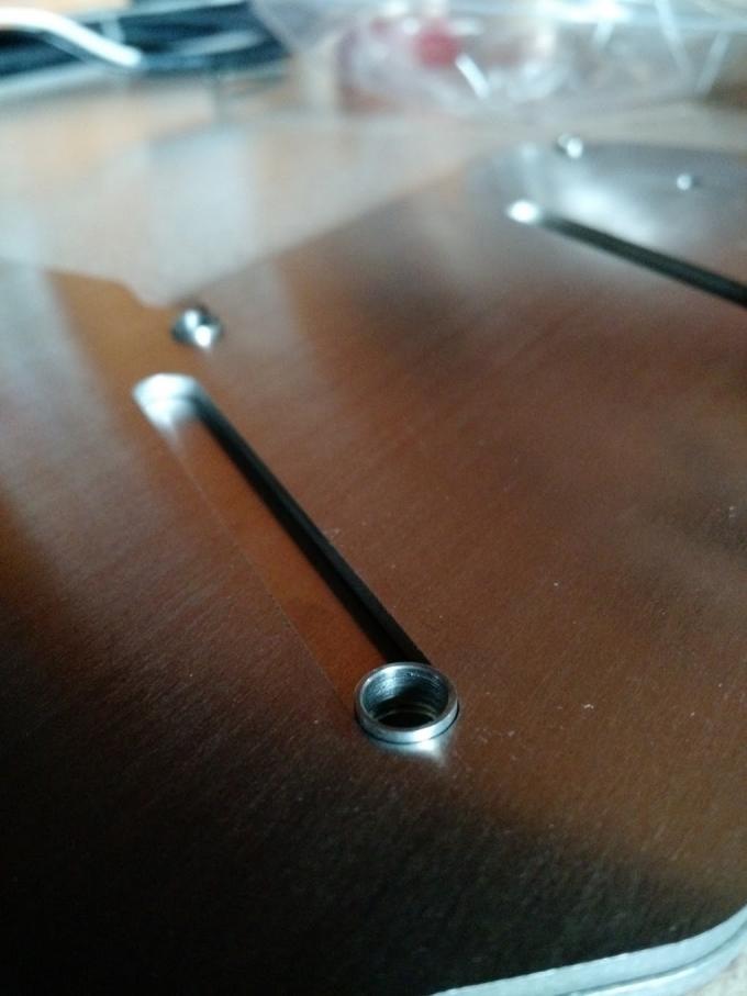

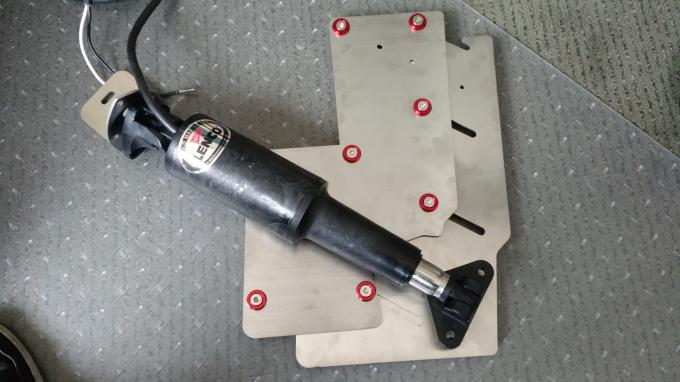

    I had previously mentioned this on another post but here's a system that I am building for my 210 with a chine/tapered transom. It will be installed and tested in the weeks to come.

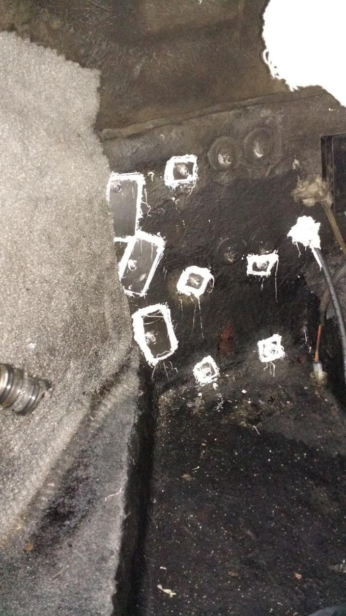

          Getting close

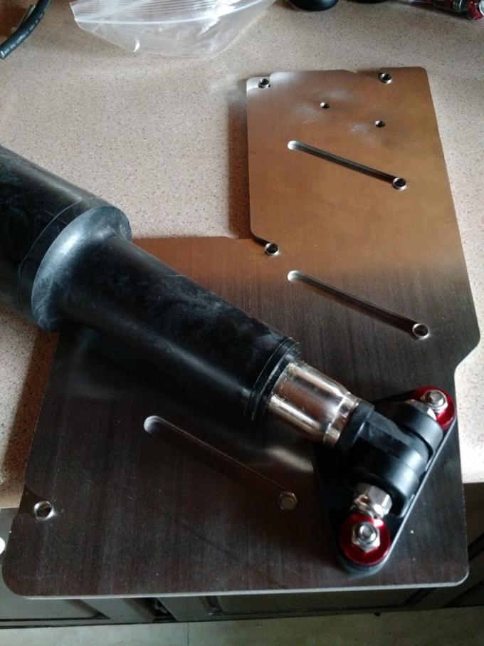

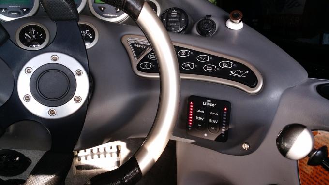

                  I will be sealing up the fasteners and wiring up the switches next weekend so hopefully I will have some in water results by then but based on some of the 'cutting board' manually operated designs that other people have tried, I expect it to behave very similarly.
                  The difference is that I made my tab extend diagonally like the NSS system as the boat will list and it will be more effective along the lower edge. Technically this is a diagonal 'interceptor' (see Volvo Penta/Humphree design below)

                    I spent many hours sealing up a couple of leaks with 4200, wasn't easy but it's done. Put in 800 bags in place of the factory tanks and gave it a test.
                    Works great without a lot of weight but still needs one side to be ballast full. It made some amazing clean faces both sides but the water got choppy so I couldn't get good pics. Definitely a major improvement but it didn't make a beautiful wake like a 2014 230.
