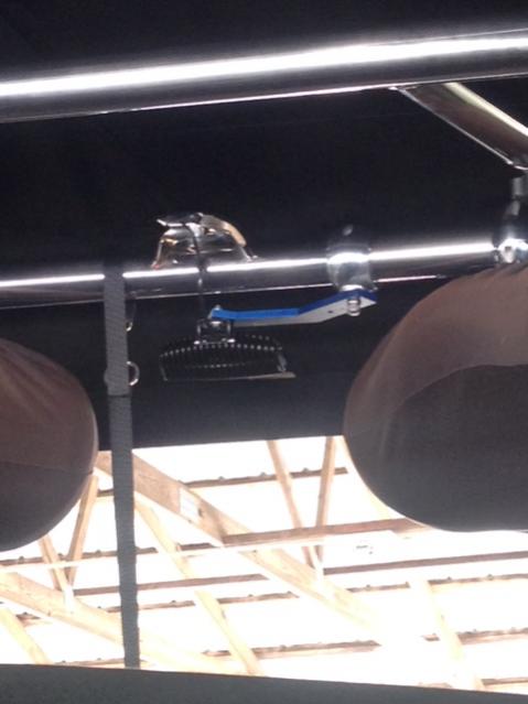

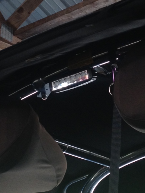

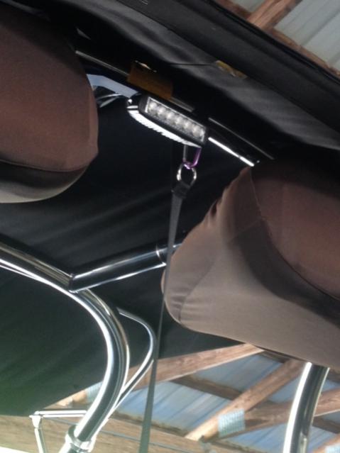

Just finished my tower light project using various items:
Kawell LED work light 1600 lumens
DIY Wake 2.25'' clamp
Stainless hardware
Aluminum bar stock w/ blue anodizing.
I utilized the existing 12v 360 degree anchor/ running light and put a switch inline to turn it off when not needed. I have not been out at night yet to see how good it works but on the bench the light is really bright and has a good wide range.
