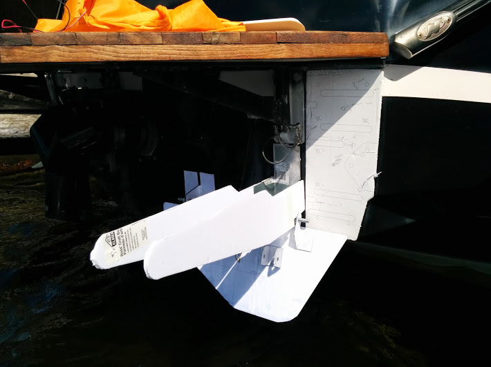

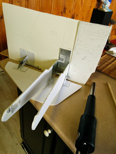

I'm calling this the double bacon surf system.
Test fitting - found a major flaw, the actuator mount would stick out into the flow of water and would be a hazard around the swim platform. I've changed the design to a diagonal mount with a pivoting swivel. Still figuring out the 3D trigonometry. I am so glad that I mocked it up before sending it to production.
