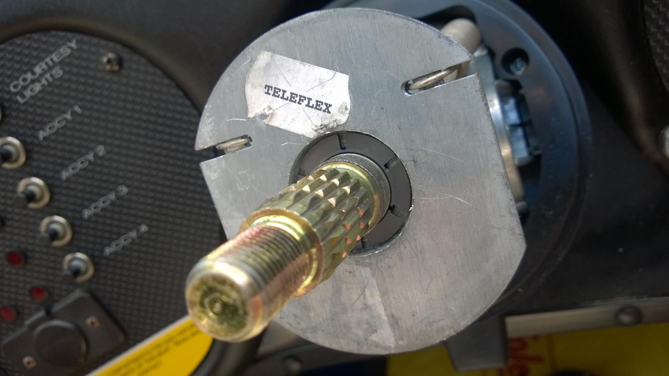

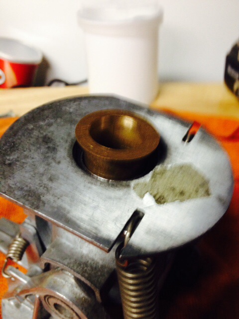

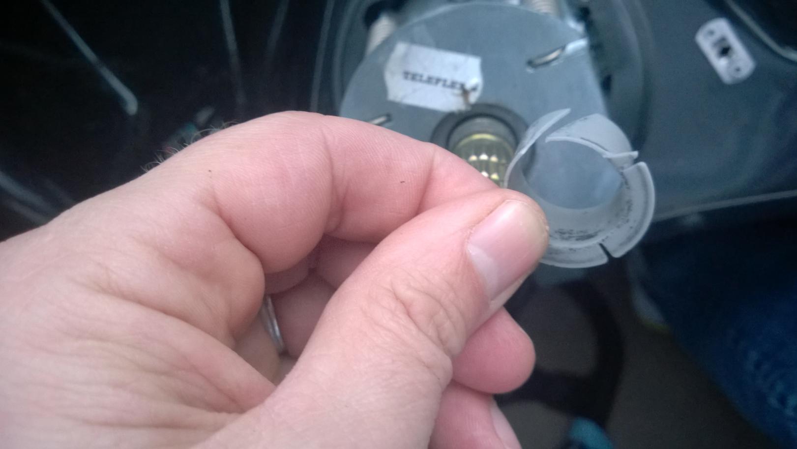

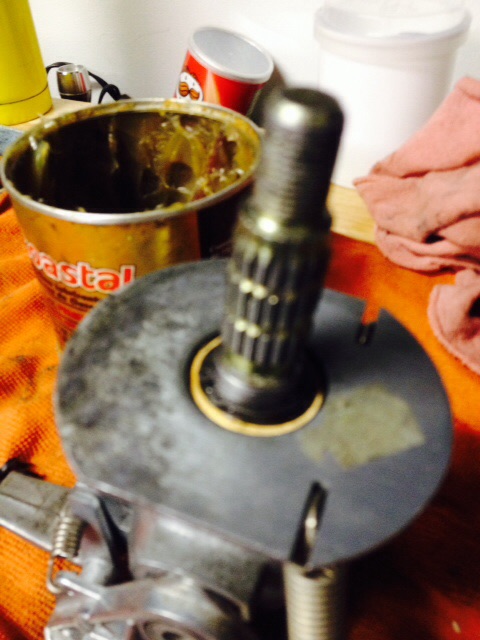

    Here's a relatively straight forward fix for the up/down slop in older (90's?) models that use the teleflex wheel system. In essence, the problem is due to a worn nylon flange bushing that shims the wheel shaft to the housing. I was able to get a very similar part from Granger that worked with just a little trimming. Telflex doesn't offer any parts to R&R the unit but is happy to sell you a new one for about $200 or so. This fix was about $15 and mostly due to shipping from Grainger.
    This simple fix removed a HUGE amount of sloppiness in my steering. There is still a bit but it looks like it's somewhere in the tilt section of the assembly, not in this section.

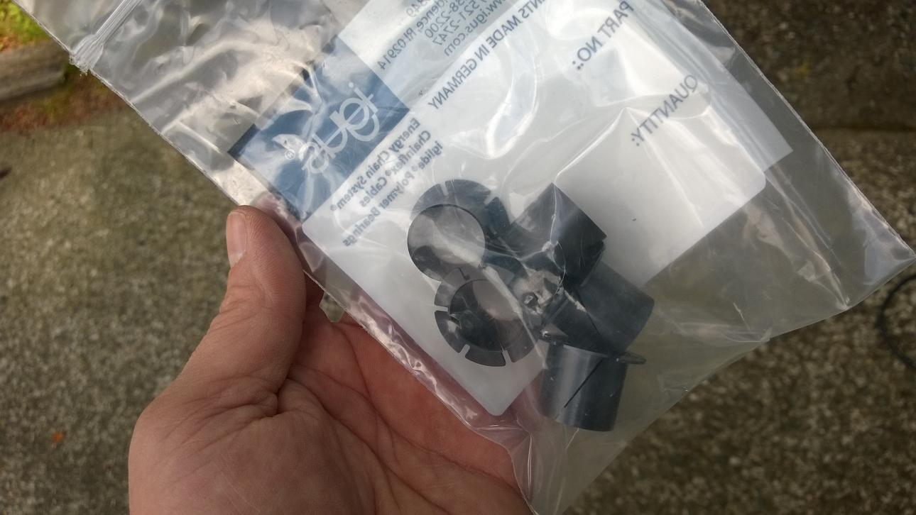

    Link to Granger part . If the link breaks, it's a 3/4"ID 13/16"OD with a 1 1/18 inch flange diameter.
    Edit: The part is made by 'Igus' and the product SKU is 'MYI-12-12'. You can find other suppliers via search.
    Here is a series of pics on what you need to do.
    Pic 1 - packet of flanges
    Pic 2 - steering wheel pulled, you can see where the bushing goes. Note that you'll need some snap ring pliers to remove the snap ring under the steering nut.

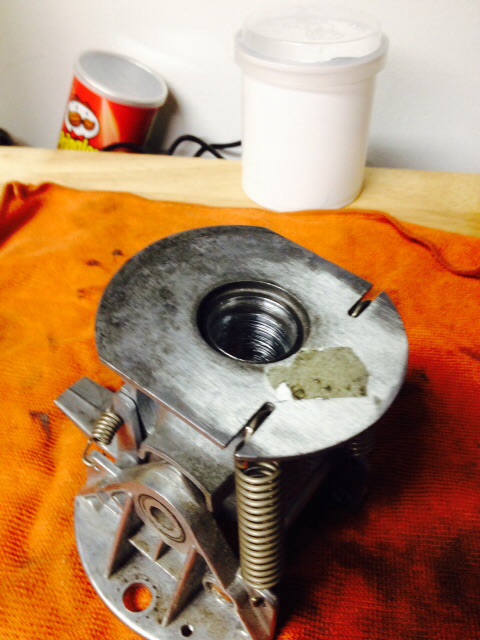

    Pics 3 - old flange removed

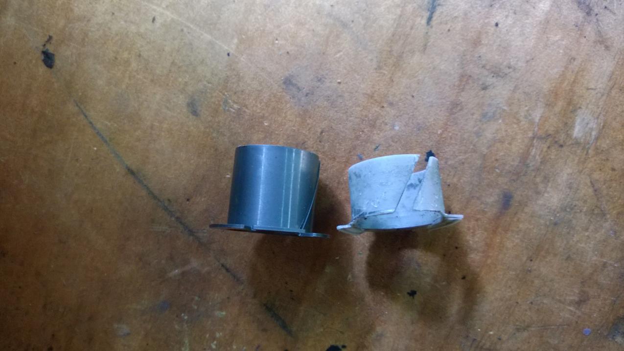

    Pic 4 - comparison of new and old bushing. I cut away the extra depth on the Grainger item with a razor blade

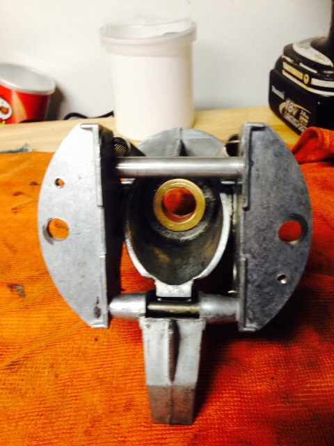

    Pic 5 - new bushing installed
    Tools needed: SAE hex wrench to pull the steering wheel. Socket to remove the steering nut. Snap ring pliers to pull the snap ring that secures the shaft. Some sort of sharp needle like tool to tease out the bushing. I used a machinists scribe.
    Hope this helps someone else!

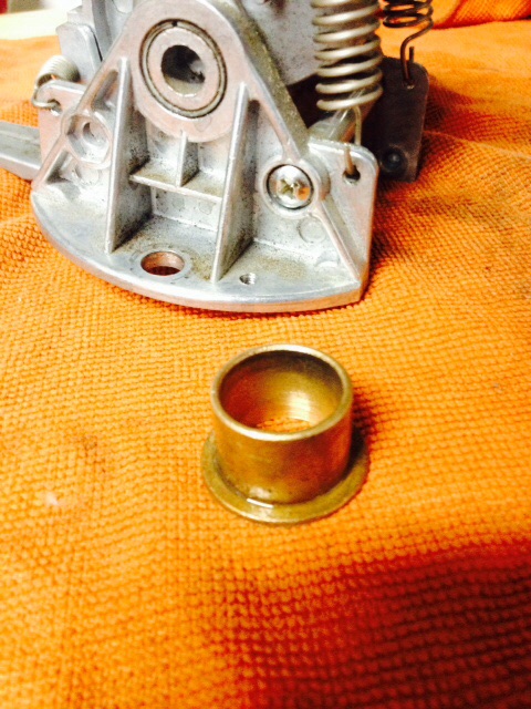

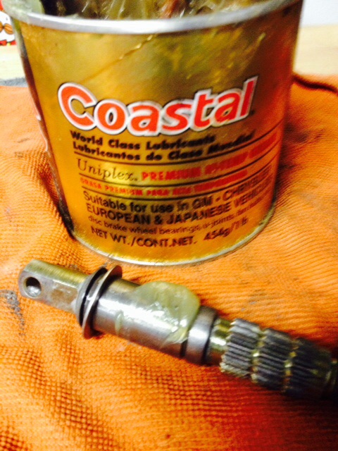

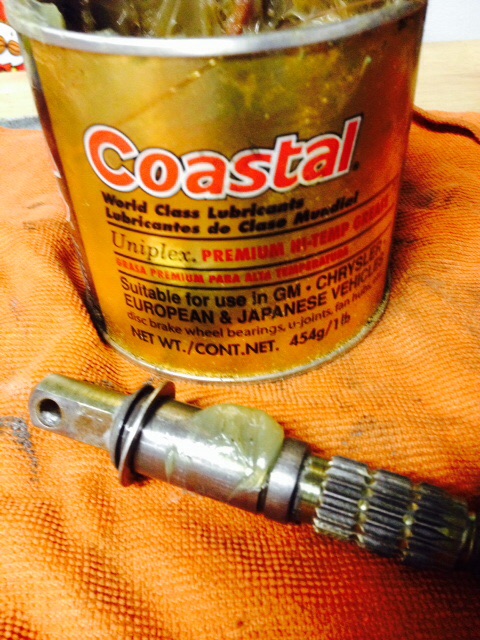

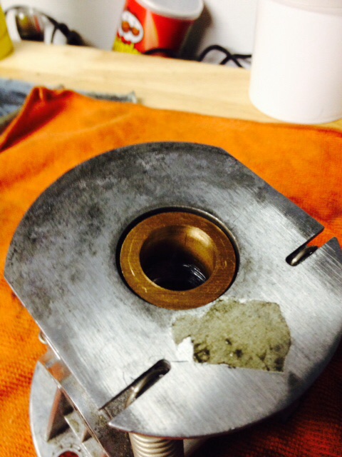

                        opened the existing bore from 13/16 to 7/8 with a step drill and hole saw.
                        Bought two. 3/4 inside diameter x 7/8 outside diameter brass bushings.
                        Used a belt sander to shave down the height of bushings and reduce the shoulder thickness.
                        Lubed it up and assembled!
                        Yahtzee no slop 1/32 end play !
                        • MrFitz
                          • Feb 2016
                          • 14
                          • Massachusetts
                          • 1997 Ski Nautique. 196
                          In appreciation of this site and how you motivated me, I will disassemble the unit document the entire process with pics tonight.
                          • SilentSeven
                            • Feb 2014
                            • 2251
                            • Bellevue WA
                            • 2004 Nautique 206
                            That's neat. Did you do just the outer bushing or both? BTW, this is what the factory should have done regardless.
                            Bellevue WA
                            • MrFitz
                              • Feb 2016
                              • 14
                              • Massachusetts

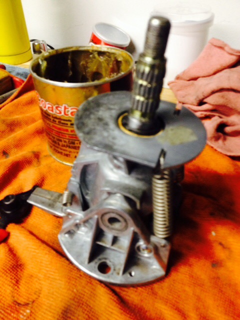

                              I did both. It was cold last night and my work shop is an unheated but I still have not put the assembly back in the boat.
                              I will definitely take it all apart and set it up and photo all the steps.
                              There are no part numbers on the bushings. You can buy them in any good hardware store like a True Value.
                              They are 3/4 "id x 7/8" od x 1" tall. They were in the Midwest fastener drawers in the nuts and bolt section.
                              I used a stepped drill bit from Harbour Freight to start the bore because it self centers. It gets you started and bores a 1/4 " deep hole before the next step.
                              I then finished the bore with a standard 7/8 hole saw in the drill press. You could try without the press but there is not much room for error.
                              The 1" height of the bushings was too long so I cut 1/4" off the end of each and squared the ends with the belt sander.
                              The original plastic bushings were only about .0018" thick at the flange so the brash bushing flange must be ground down. Again I put it on the belt sander and took it down to about 1/16" thick. Any more and it would have broke. This left me with too much bushing for the length of the shaft by about 1/8". Simple solution...there are two washers on the top ot the shaft a very thin one and a 1/8" thick one. The 1/8" washer appears to be a spacer to make up for end play in the shaft so I just removed it as the new thicker brass bushing flanges at 2 flanges by 1/16" make up the difference.
