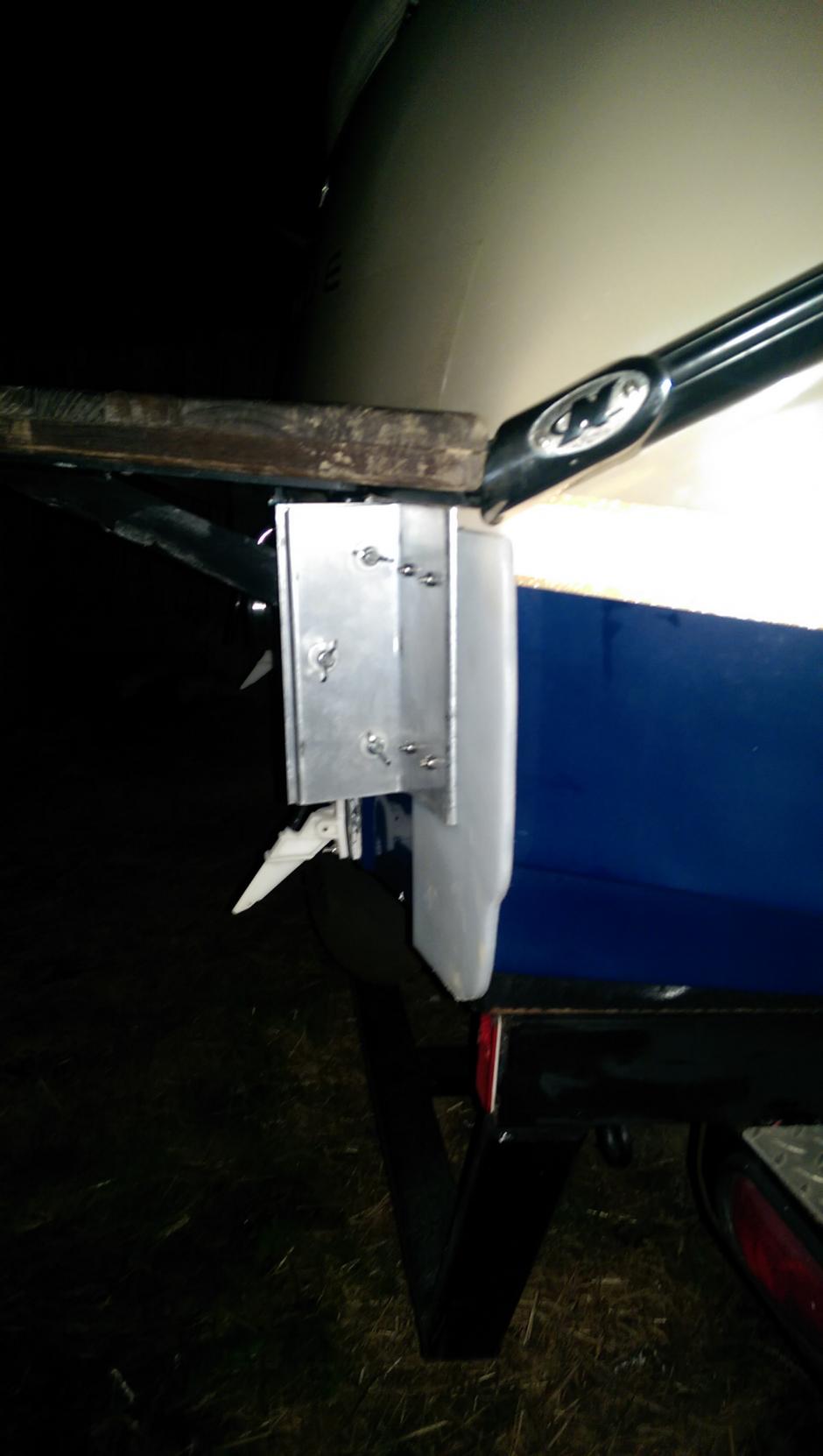

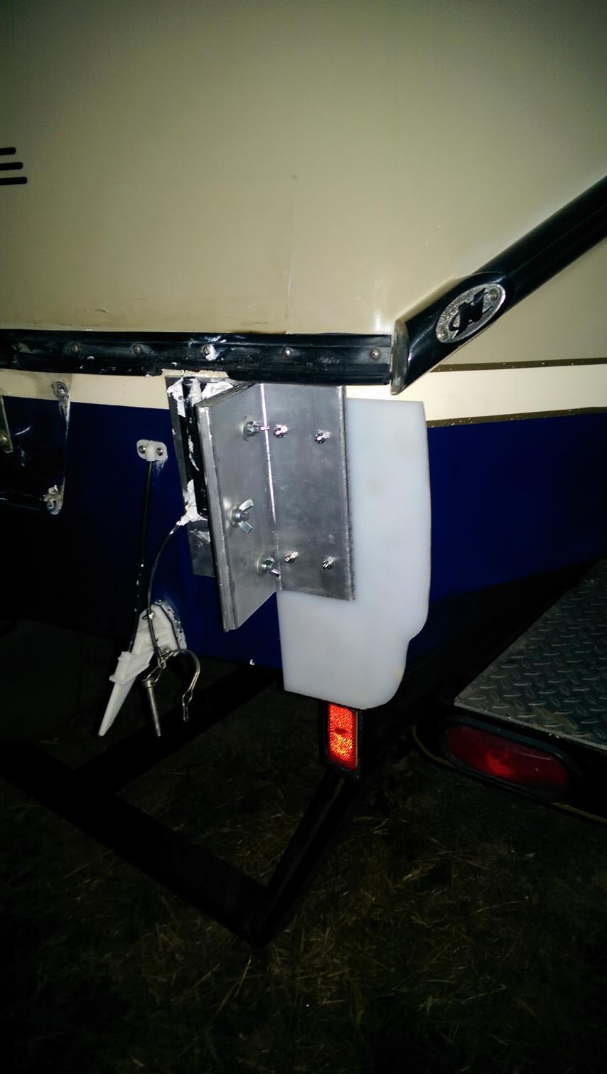

        Here is what we came up with. We removed the swim platform bracket and this way didnt have to cut holes. We put 4x4x 1/4inch angle and then some HDPE. Works fairly well. Wake here.
ID:	368752Click image for larger version

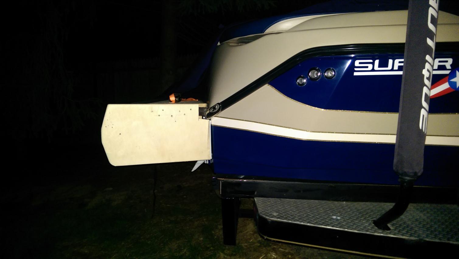

          So here is the updated setup. You can see it throws a huge wake. We extended the plate so it goes about 1.75 inches out past the side edge and 1' below the bottom.
          The weight setup was as follows:
          Factory tanks Mid, and 2 rears full
          400 additional in bow
          300 additional in Port locker
          8 people
          One huge wake!!!!!

            Nice work! Is the plate easily removable for wakeboarding and cruising?

              Yes. Super easy. Takes about a minute. Just some bolts and wing nuts. The effort is in the moving of the ballast but it is all part of the action.

                Hi jangelides, any chance you can post the dimensions of your plate here, Im looking to do the same and as yours looks to work pretty well seems like it will do me. Appreciate it thanks

                  jangelides....Did you really mean (1) "foot" below the bottom or was it supposed to be (1) "inch"?
                  12 inches seems like a lot not to snap like a tooth pick.
