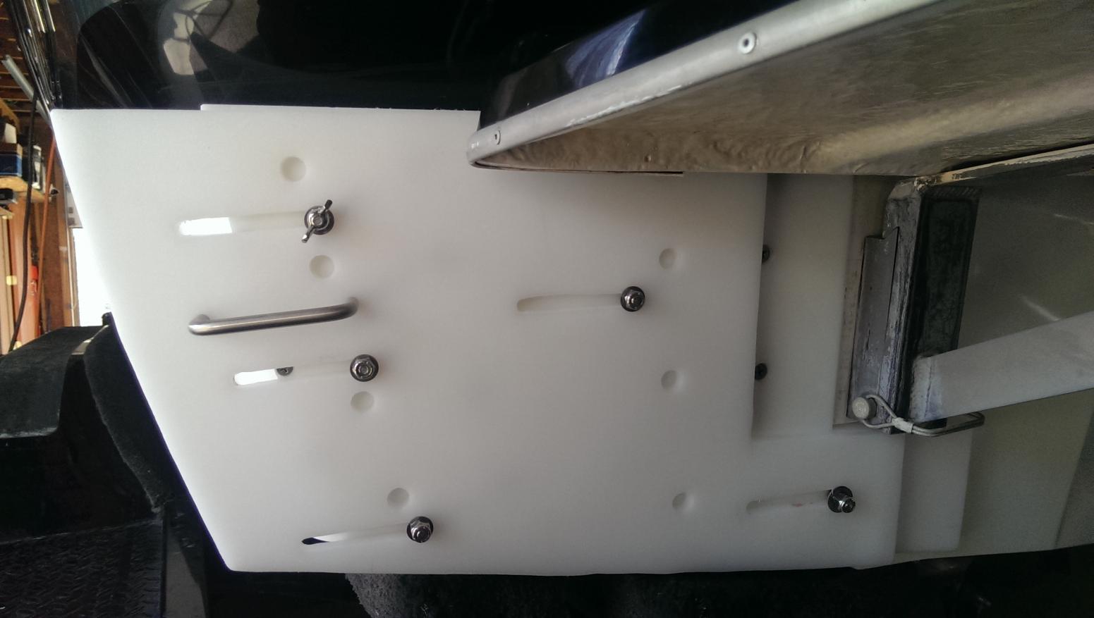

                      These don't have dimensions but should give a pretty good idea. I still haven't made it to the storage unit to finalize measurements, but what I've got here is pretty close to how the final one will look. message me if you want more details.

                        I just completed testing on my DIY NSS. Thanks to dfoster for the inspiration and source for materials. Unfortunately my local Walmart's HDPE cutting boards must be weaker than yours. My board broke away after about 30 min. The wake was awesome while it lasted. Here is my setup. 05 SV-211. 400 lbs in port locker. 400 lbs in starboard locker. 350 lbs in center locker. 800 lbs across back seat. NSS deployed on starboard side 2".

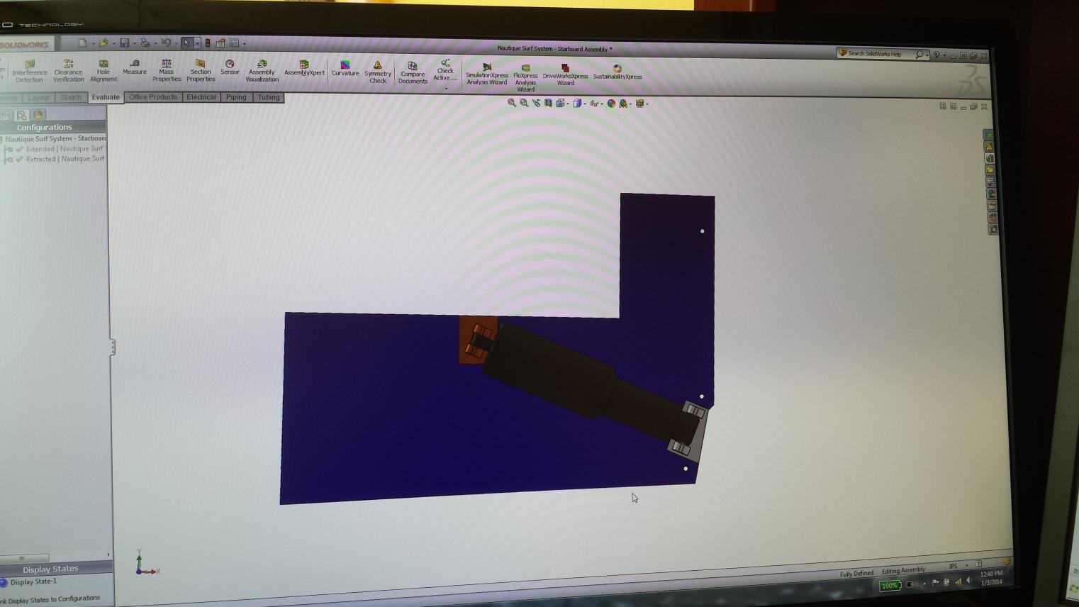

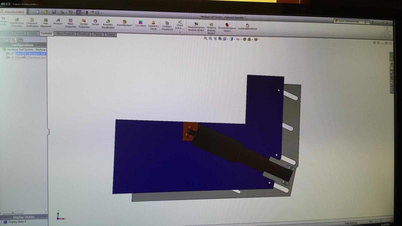

                          I've been busy at work and haven't been keeping people up to date on my progress either... but my Walmart cutting board failed as well. It cracked off right at one of my corners, so I figured I must have made a sloppy cut, but it probably just can't handle the stress over time. It was working fine for a bit, but then I tank busted and really loaded the boat up and BAM. Suddenly the wake was no good... and then my daughter saw the plate floating in our wake!
                          I have my Lenco actuators in, and have built a controller with an Arduino board that will turn them on/off and allow me to adjust the distance they extend. I'm now trying to find the time to actually draw things up to get plates cut. Have you done that yet? Want to share drawings and I can help with the controller? I'm better at the electronics than the drawing. Honestly, I'm a hack... but hey, it gets built.
                          Let me know if you want to work together on the drawings and getting plates cut. If we can get one set up for an SV, we can share that with the group... or if there is someone else with an SV that is good at CAD, drop me a message and we can work things out.

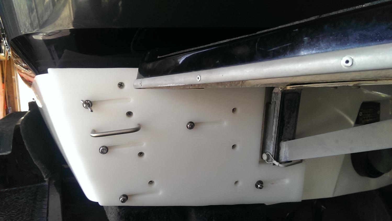

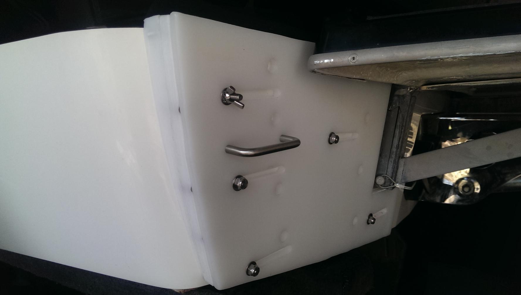

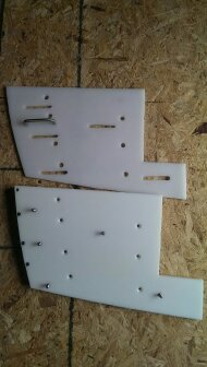

                            Doug, made a design similar to yours and hope I can get pics to post here. Wave shaping has been awesome. Made my base plates out of 1/2" HDPE and the slide plate of 3/8". Made templates, prototypes ect,,, and final models after some trial and error but we have been super stoked by the results. Can adjust the length of the wave, shape ect,,,just by moving plate out 1-1/2" for skim boards or full 3-3 1/2" out for surf style boards. Every single rider this year has said our wave has more push and is longer or better shape in general for riding. We deal w a lot of current in the river we ride in so have to play w speed some but so far very happy w results.
