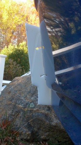

    I templated out the back of my boat using cardboard, and was looking for something I could cut that wasn't wood, but wasn't aluminum. I went for plastic, HDPE, cheapest source is actually cutting boards at Walmart!
    But easy enough to trace out the shape of the edge of my hull ('04 SV211) to get the right contours. Then did some 20degree slots in another piece that were 2.25" long to match what I would get if I went to Lenco trim tabs.
    To mount it, I realized that my swim platform mount actually has a 3/8" piece of plastic between the metal and the hull. Pulled that off, and replaced it with my base cutting board. I got the board sized so that the top corner is actually "pinched" by the swim platform at the outer corner to provide some extra support. The movable part is cut around that so that it doesn't touch the platform but starts high so that when it is down I get full height out in the water.
    Bolted it up with stainless hardware and a wing-nut on the top nut so that I could manually loosen it, extend the outer piece and then tight it back up.

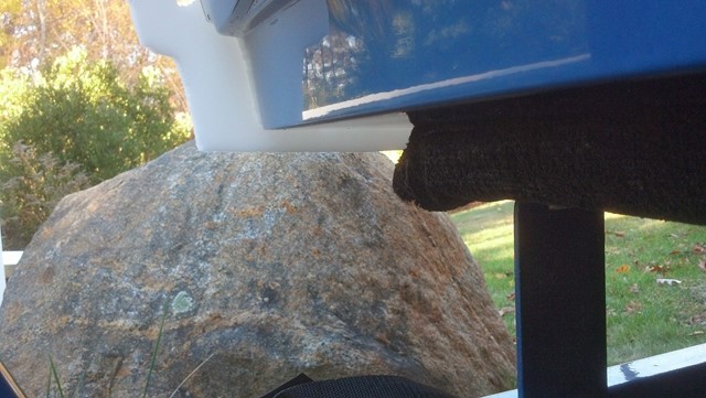

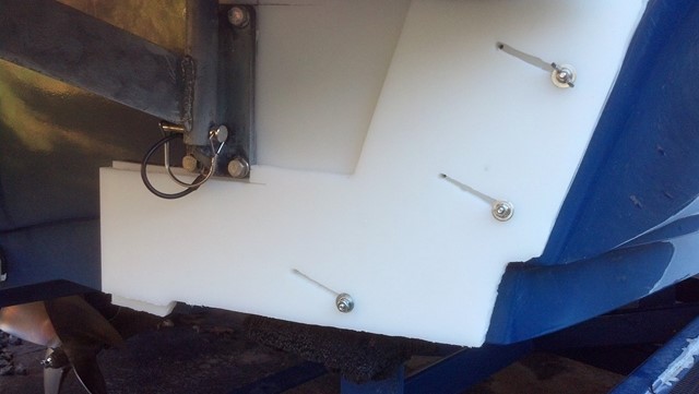

    Here are some pics so this makes sense. The first one is "closed" and the second one is all the way deployed.
Name:	CSS closed.jpg
ID:	380537 Click image for larger version

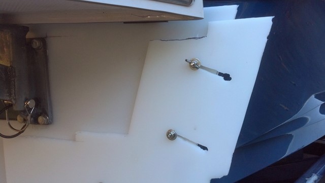

    I used a dremel tool and file to get the contours right so that it isn't out "in the water" when you look down the hull. But the 20deg and 2.25" slot get me about 2" in the water.
ID:	380539 Click image for larger version

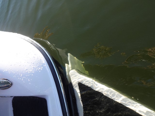

    Here is a shot of what it looks like deployed when in the water, looking down from my swim platform.
    You will notice that it is held in place a bit by the swim platform so that I am not worried (too much) about it bending or breaking off.

              How important is the amount of flap sticking out the bottom . Is the 20 degree slot the optimal number? If you lessen the pitch of the slot it will protrude more out the bottom. Is the 2'' in the water the amount to go with?

                      Looks great. To confirm, the base board is only held on by the mounting bracket and platform, but has no support near the far right bottom of the hull? Does this result in the boards flexing away from the hull while underway? Is this set up sustainable without doing damage to the platform mounting bracket or hull?

                        Nautiquehunter - I went with the 20 degree because it seems close to what Nautique was doing and as I mocked things up, I realized that the back edge of my transom slopes in at about that angle to vertical so it will make mounting the actuator straight forward. The 2.25" slot is based on the length of travel that I can get out of a Lenco XDS actuator which just barely fits in the space. I was assuming the Nautique folks are smart and probably worked out why you want some extension on both the side and the bottom. The 20 degree angle and 2.25" slot gives me about 2.25 out in the water on the side (since it parallels the edge of the hull), and just under an inch at the bottom, which lines up with one of the channels on the bottom of my hull. My assumption is that the extension on the bottom provides a bit of "lift" to that side of the boat, which helps drive the opposite side down and helps the wake a bit more.

                        flipflop - You are correct, it was only held on by the bracket and swim platform. Based on the strength of the 3/8 board, it bends a bit, but I really don't think it is a problem. That said, the board would definitely break way before the metal mounting bracket would deform at all. I also used pretty small bolts to hold on the top board that slides out. My thinking was that if I hit anything the top board would break or pull-through so I wouldn't risk damage. If I was going to build this out as a more permanent solution I would want to brace the base somehow or bolt it to the hull. One of the issues with the current setup is that I didn't build "filler" pieces to account for the curvature of the transom and the step-in at the bottom of the hull. This allows water to get behind the board. I think with everything filled in properly there would be less bend.
