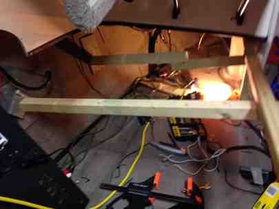

    What I started with.

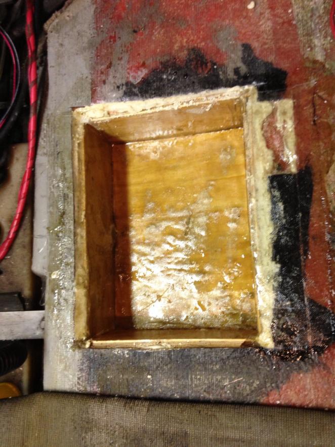

    Followed the write up of Core-rider to remove existing interior and them I used a multi tool to cut out the interior. I moved from my original outline to the starboard due to proximity to the stringer. I added a box to give some structure. I coated this prior to installing with resin to waterproof.

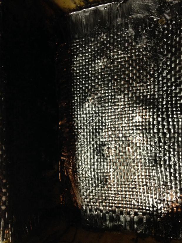

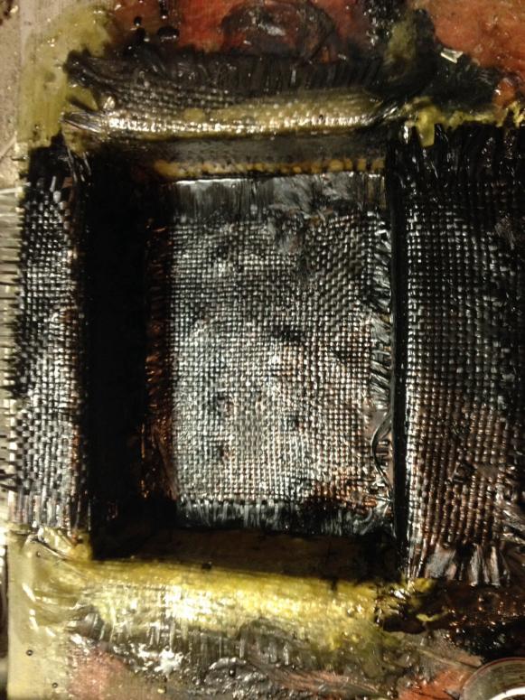

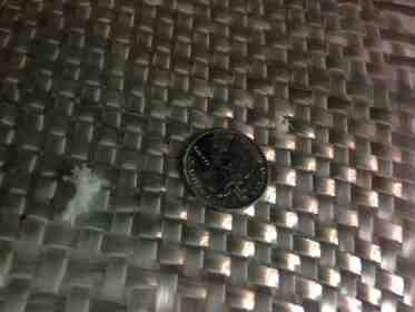

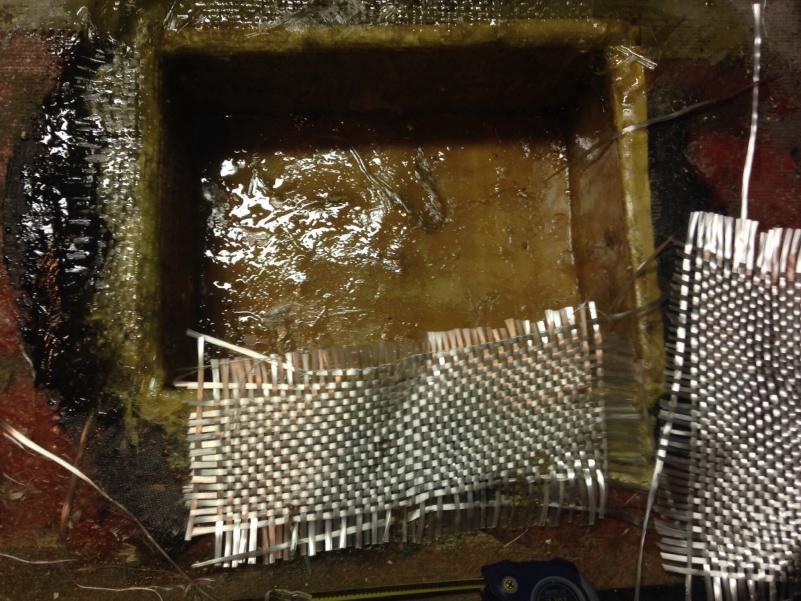

    I used some pretty heavy woven roving. 24oz. Harder than I thought to keep the sheets together due to the size of the strands. This stuff sure absorbs the resin.
    I did a couple of layers on the entire box but didn't get any pictures. I was more concerned about the strength at the corners so I added three extra layers of robing like this

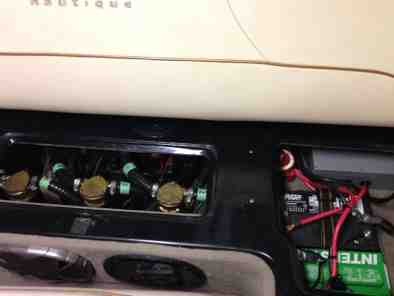

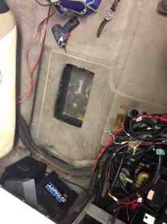

    Jumping ahead after it put the carpet back and cut to the new opening I added both batteries and connected to a mounted common ground and to the selector switch. Looks a little messy but it was the best I could do with the 2 gauge. Click image for larger version
    Notice the grey box? That is where all the relays are for my ballast puppy upgrade. So nice and clean out of the way now. Here is the box open.
    Here is the final with the seat base back in and my trickle charger mounted. Once the project funds are increased I will upgrade to a more legit charger.

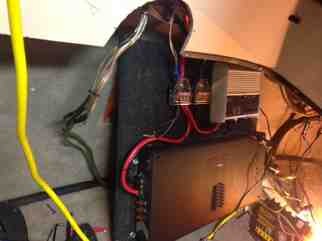

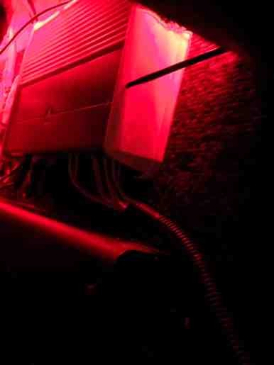

    I also moved amps around and sent 2 gauge up to distro blocks. To get the amps mounted to the hull I used hdpe and 3m 5200 and some creative bracing.

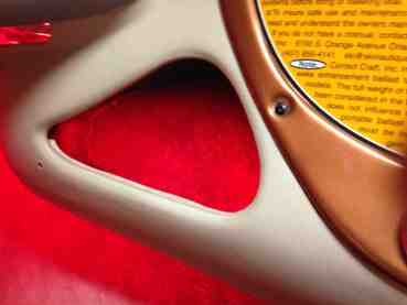

    I didn't get any pics without the combing pad of the new amp mount but really happy with how it came out. This is also showing t he new red LED interior lights

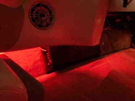

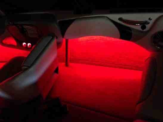

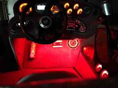

    Here are some interior pics after running waterproof led strip lights through the gunnels.
    Starboard side
    Port behind driver
    Driver side

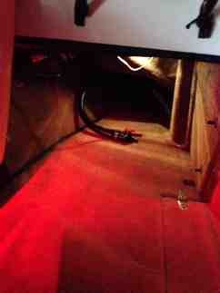

    Under driver showing gone it mounted

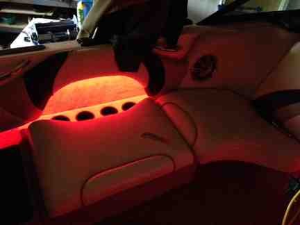

    I found some old single LEDs and decided yo light up the front cupholders. Planning on upgrading to brighter shortly as these are not too bright

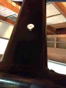

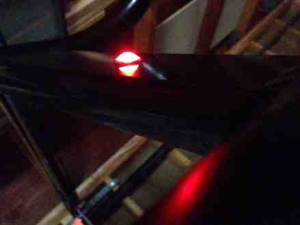

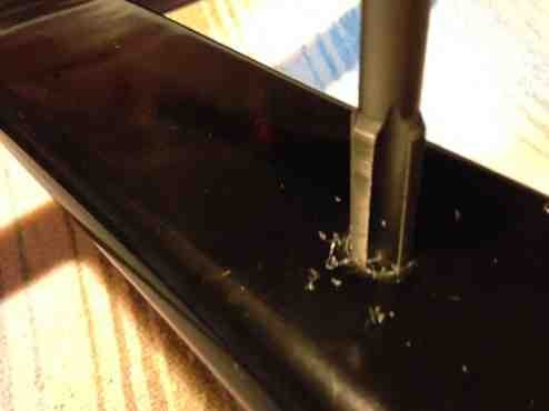

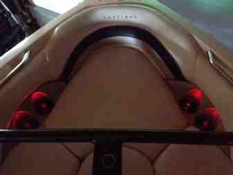

    Next was the hardest section. The PO had a jeep like light bar (think huge safari style lights on type of tower) and t he were mounted through the cross bars. I wanted to do something with the wholes so I bought 16mm bolt lights from oznium and tapped the wholes to mount down into the interior.
    Tapping
    Mounted

      Found a pic of the amp rack
      Sent from my iPad using Tapatalk HD
