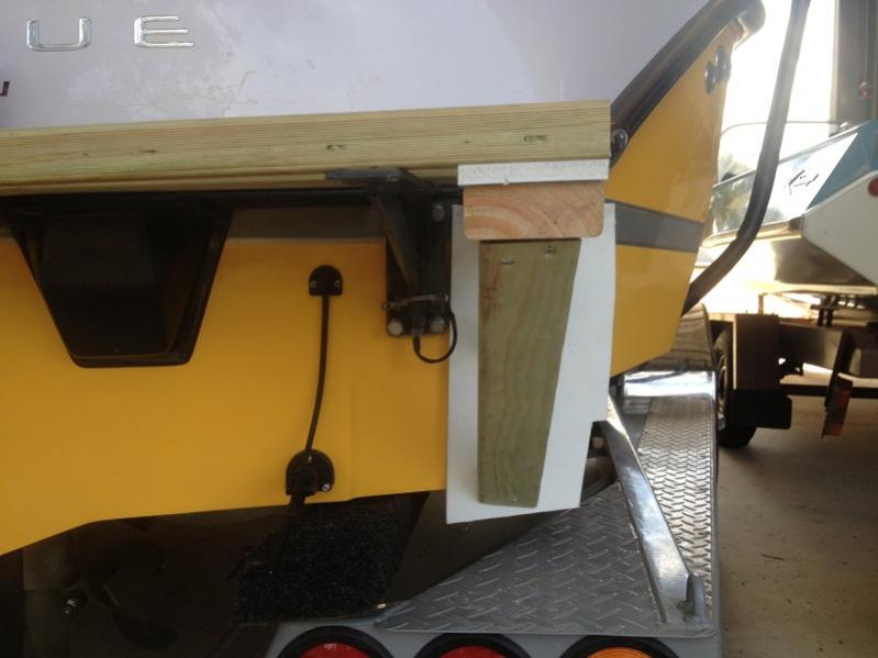

    After reading every DIY Surf gate thread and then finally coming across a NSS style one I decided I had to try it.

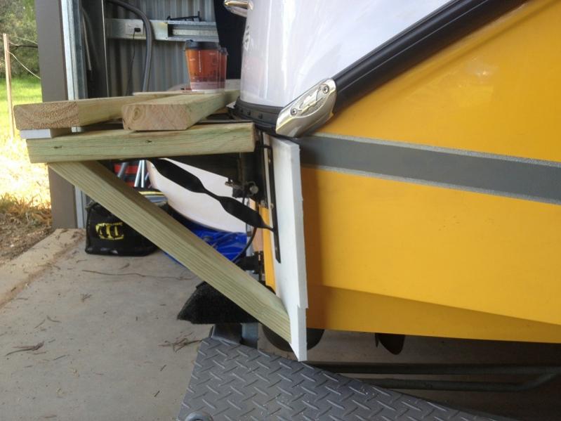

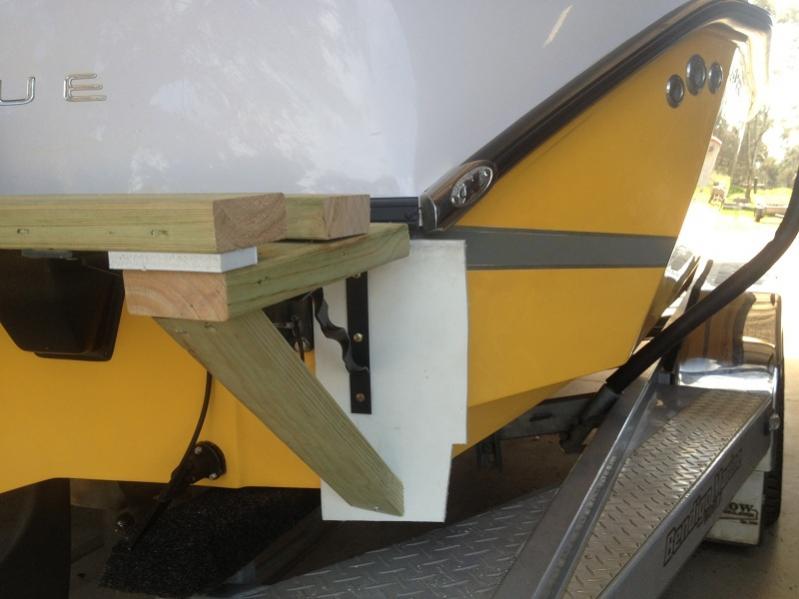

    I wanted to test it without modifying the boat at all so we removed the back deck from the brackets and used them to fashion a dodgy pine frame that we could start screwing a test plate to.

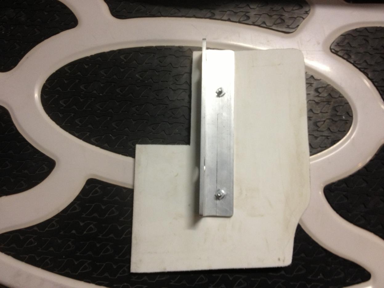

    I then traced the shape of the hull and cut a plate out of 12mm HDPE plastic that went out the side of the hull approx 40mm and the bottom of the hull approx 30mm. This was based of videos and images online plus some of the awesome DIY threads that are already going.
    The plate was fixed with a shelf bracket and some more pine to match the angle of the back of the hull.
    I know.......very dodgy! but this whole process took a few hours including an hour trip to the hardware store!

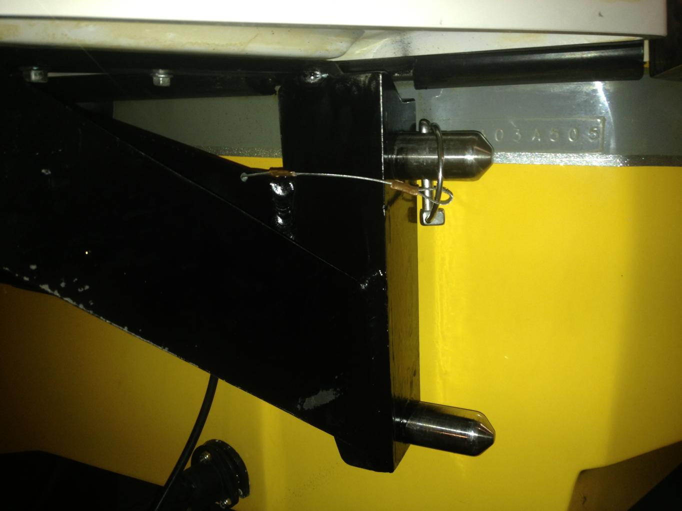

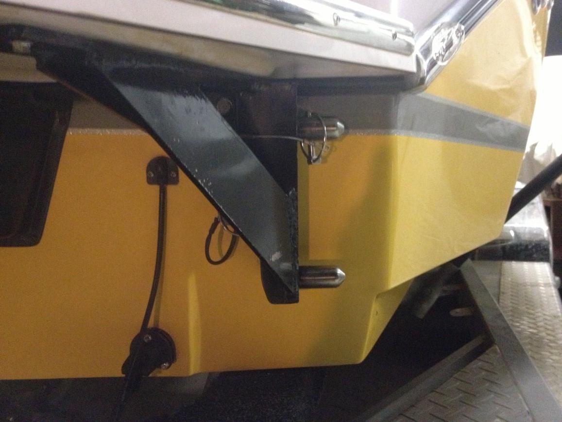

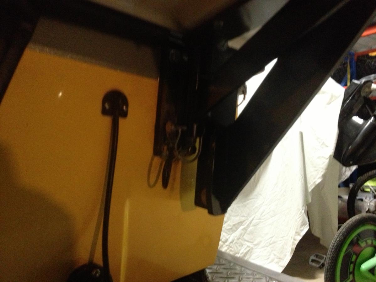

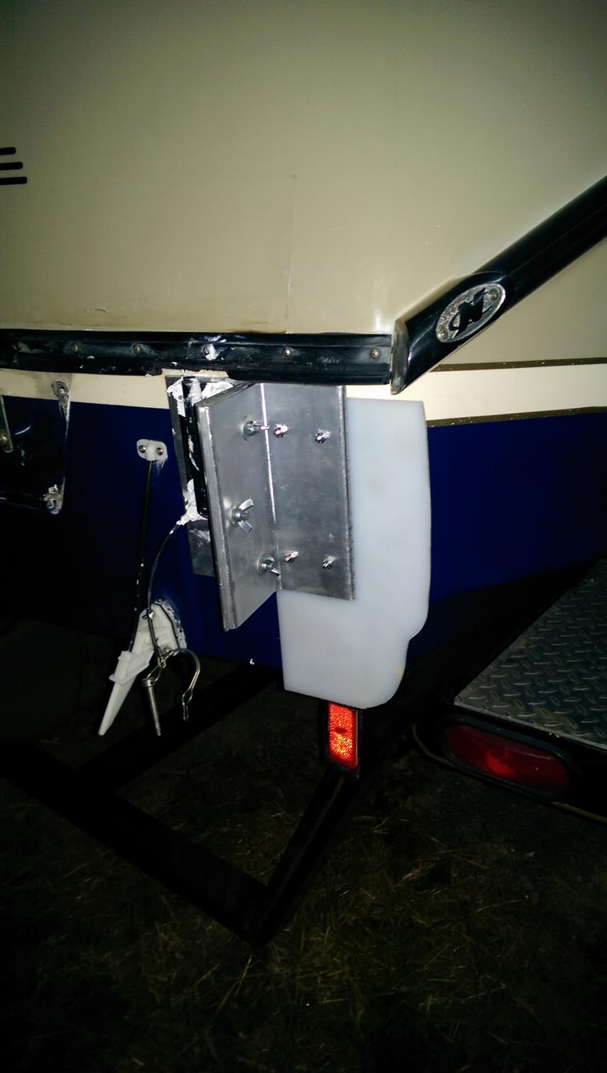

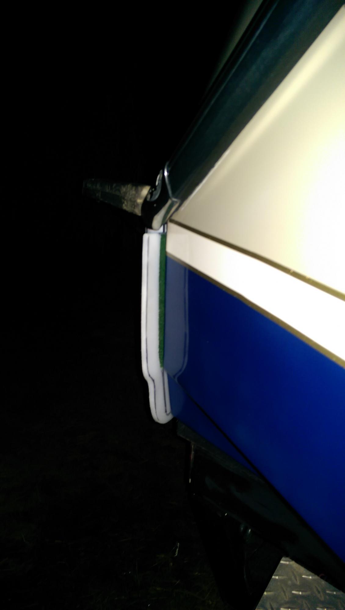

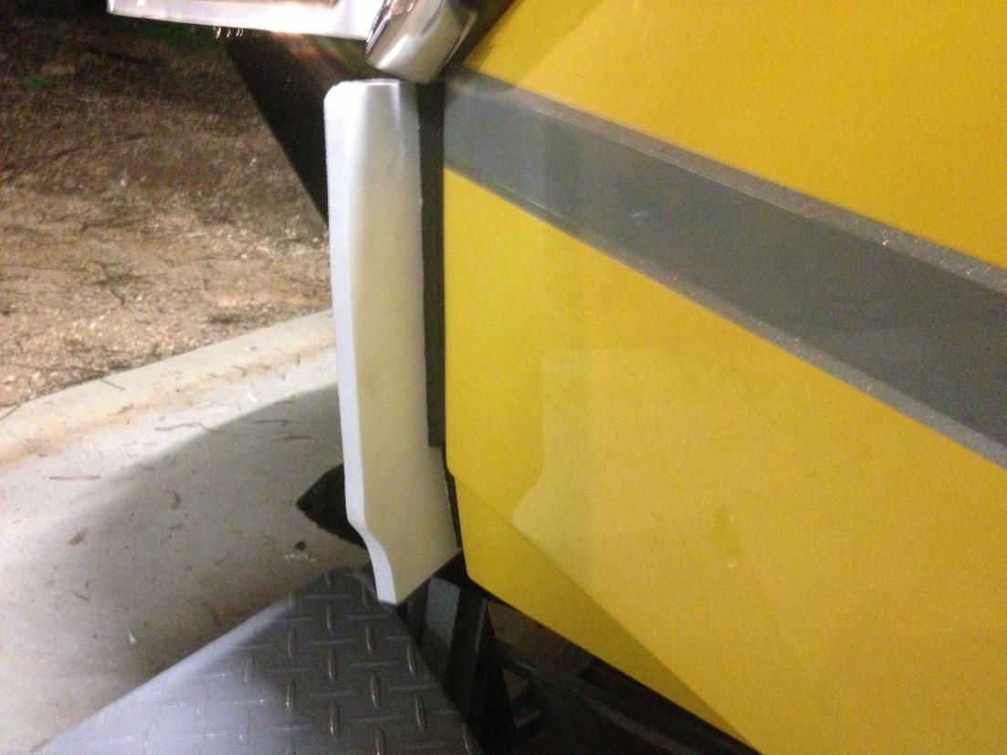

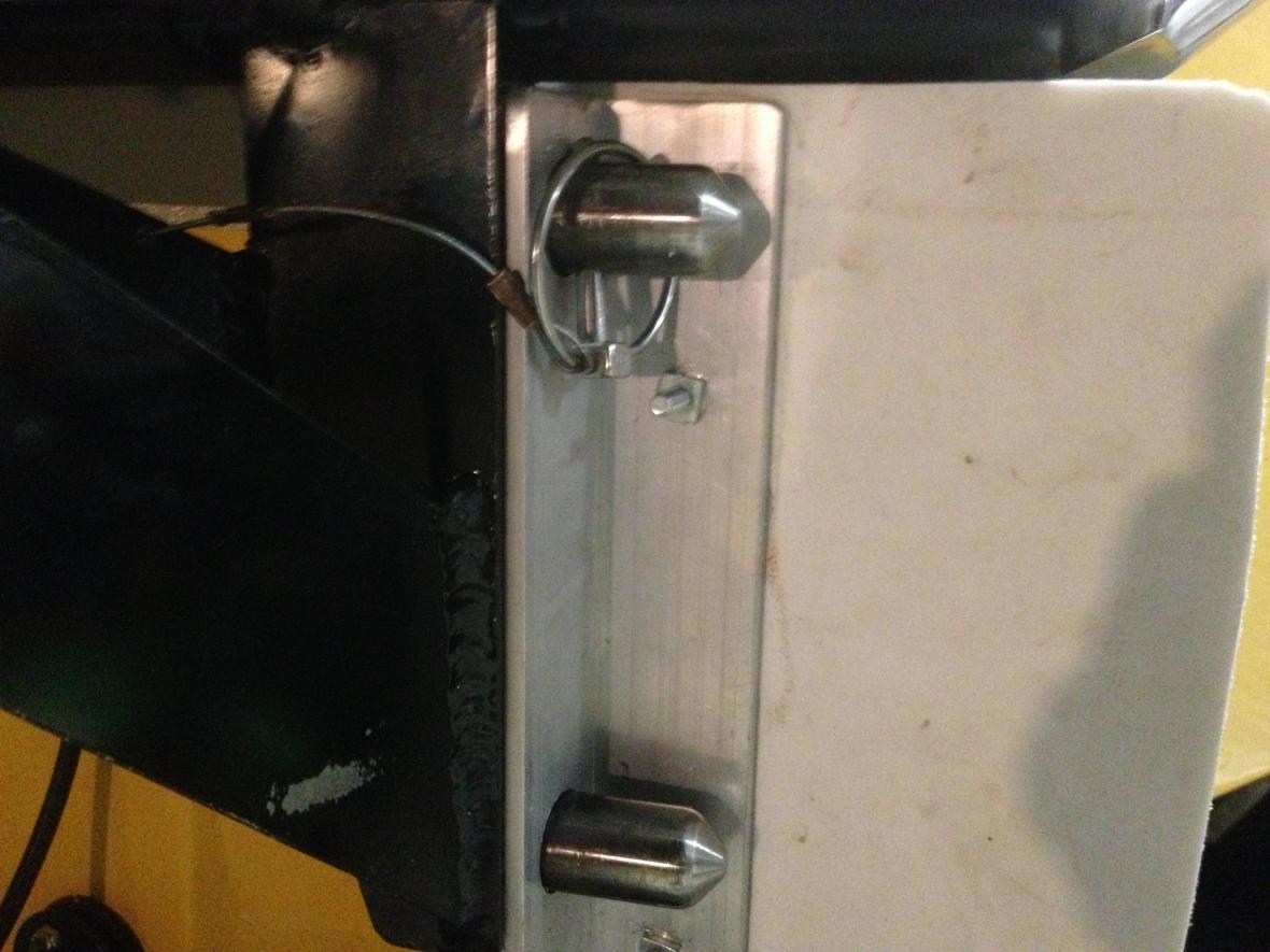

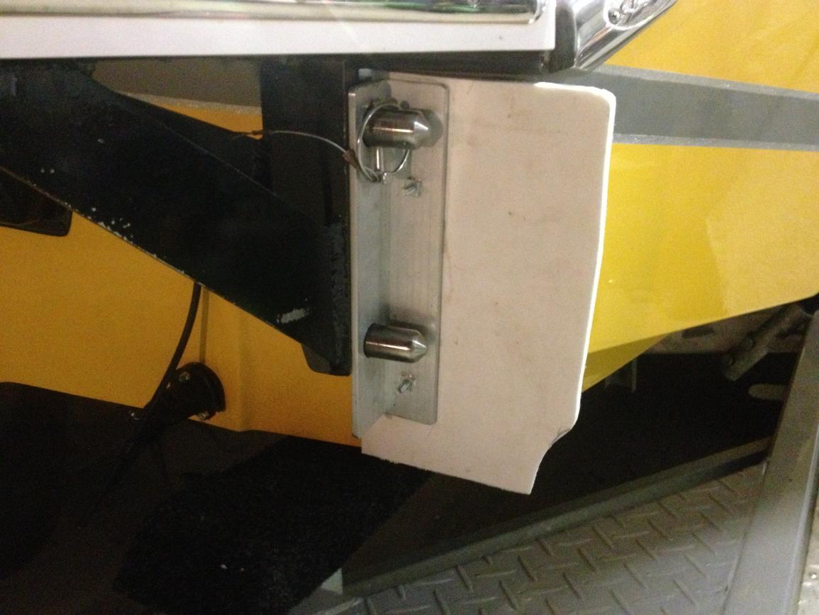

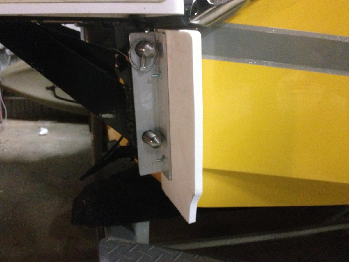

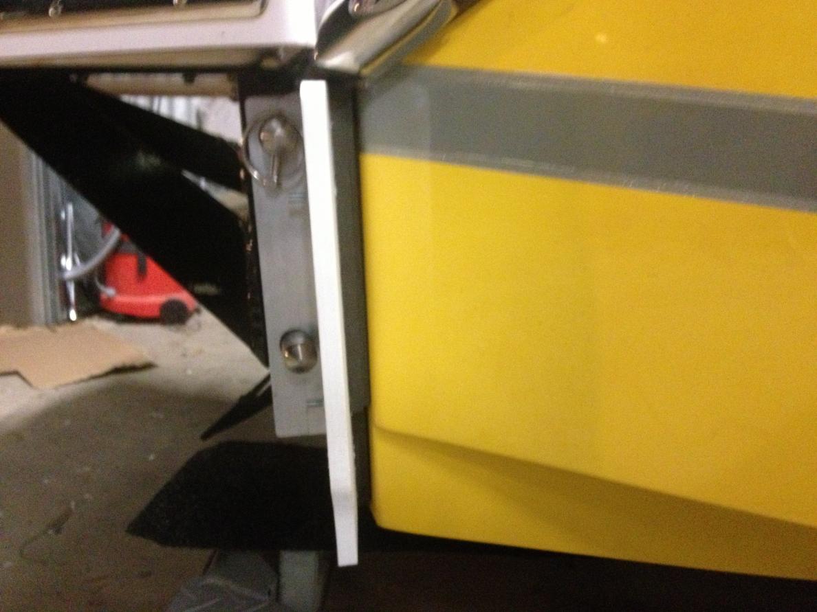

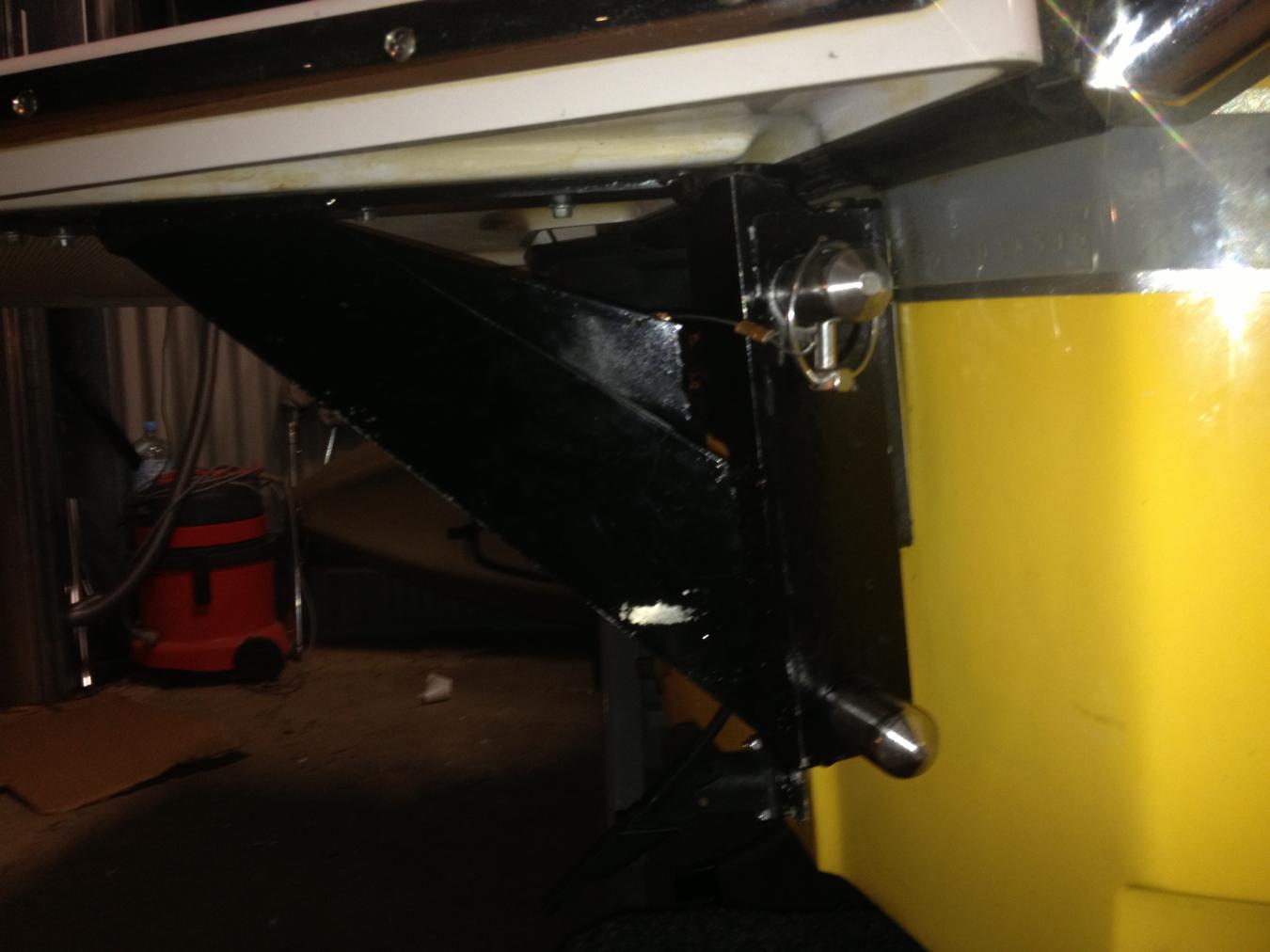

    Now that this worked I went to a local marine workshop that is great with custom jobs and talked to them about making a removable brackets that used the existing transom mounts.
    I told them I wanted:
    Quick and easy to install and remove on the water.
    No scews just one or two pins
    No holes in the hull if possible
    Ability for me to change out plates whenever I want to make up a new one
    After a few phone calls we come up with this idea and they made it for me!
    So far I have cut a small plate the only comes out the side for stock ballast, and a large plate more like the NSS size for when the boat is weighted up. The plates have eva foam on the face to close the gap between the hull and protect the hull.

    I have tested it quickly and it was awesome!
    I have two brackets for each side as I have discovered that the plate size and shape should vary depending on the amount of weight in the boat. I am really looking forward to playing with the plate shapes and tweaking the wake shape to be perfect. The best part of a manually removable plate is they can be any size or shape as you don't have to worry about retracting them in behind the side of the boat for normal wakeboarding, you just take them off.
    Switching the plate takes less than 30 seconds.

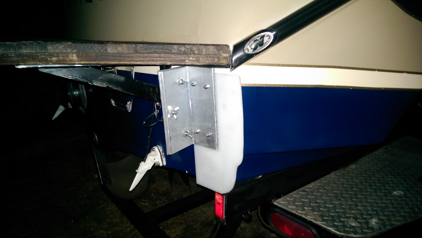

                    Hi Justin
                    Thanks for the great idea. I actually used your design but modified slightly wo as not to have to weld anything permanent. I toox 4x4x1/4 inch alu angle and removed the swim platform bracket and used it as a base to attach my fins to. It works exactly the same way. Biggest hassle is getting behind the hard tanks to get to the platform bolts. It works very well with the factory 850 plus another 400 on the surf side and then another 300-500 in the bow.

                      Originally posted by jangelides View Post
                      Hi Justin
                      [ATTACH=CONFIG]29550[/ATTACH][ATTACH=CONFIG]29551[/ATTACH][ATTACH=CONFIG]29552[/ATTACH]
                      Jangelises, Have you tried moving the plate out and down more to see if it helps the wake. How far out do u have it now

                              Originally posted by gome123 View Post
                              Jangelides... I like your design. I also thought about using the existing platform mounts. Can you also provide a few pics of the mount area? I would like to see how you mounted from the boat, AL Angle and the platform bracket. This is a great way to mount with out putting more holes in the boat. Have you thought about making the plastic tab be moveable?? So you can slide in and out the side of the boat to dial the wave.
                              Hi
                              I will take more picts and post later. We used it on Sat and it seemed to work well really cleaning up the wake. here is a pict.
                              Configuration was as follows:
                              1 driver 2 passengers on port side
                              Factory ballast full
                              500 up front
                              250 in rear port locker
                              250 on rear port seat
                              As far as different holes, for different mounting configurations, I did not plan on doing that. I am going to simply make slightly different size plates and see what works best. My next one will be slightly bigger and extend about 2" on the right and 1.5 on the bottom.
                              Here is the wake from this weekend. It was a little steep so we added some weight to the front and stretched it out and then it was really nice. One thing we noticed is the water needs to be deep. We run on a river and in places its only 4 feet deep in which case the wake disappears.
