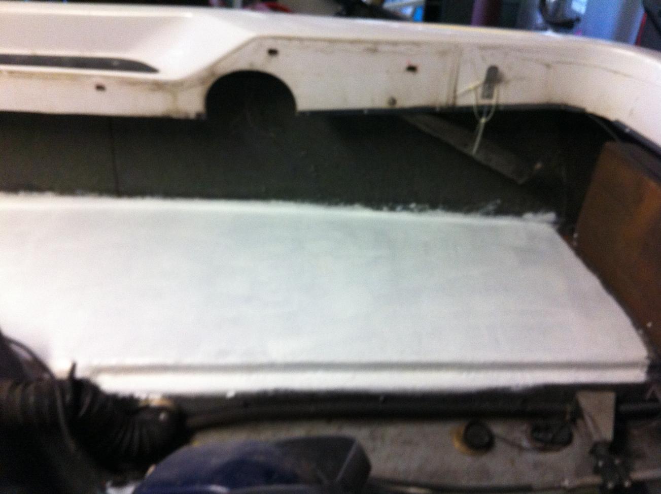

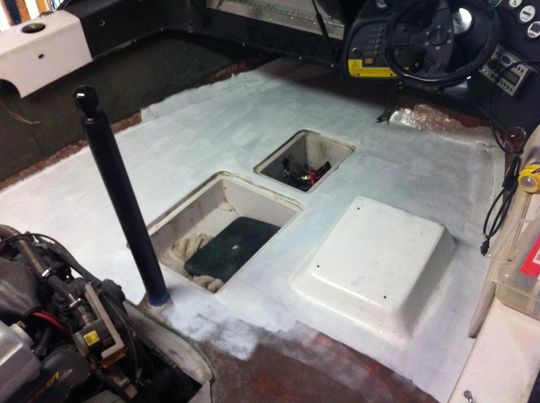

          gel coat on driver area

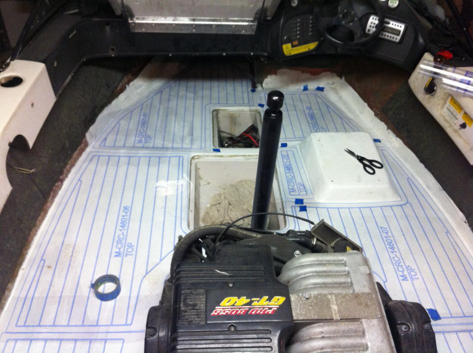

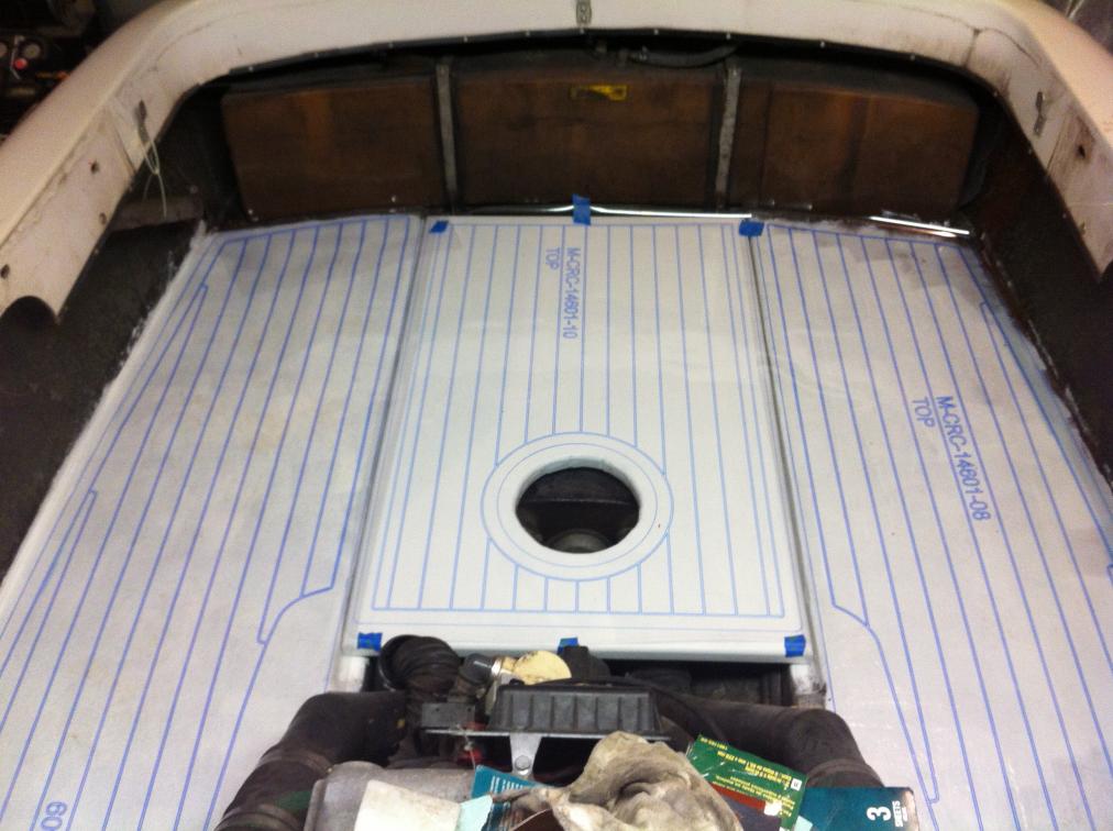

            seadek dry fit templates
            Got my "dry fit" templates in, looking pretty good. gives me an idea what the finished product will look like. very different.

              Cool stuff! I can't wait to see the finished product but it looks like you are proving that you can add Sea Deck to the boats without snap in carpet as long as you are willing to do some additional prep work.

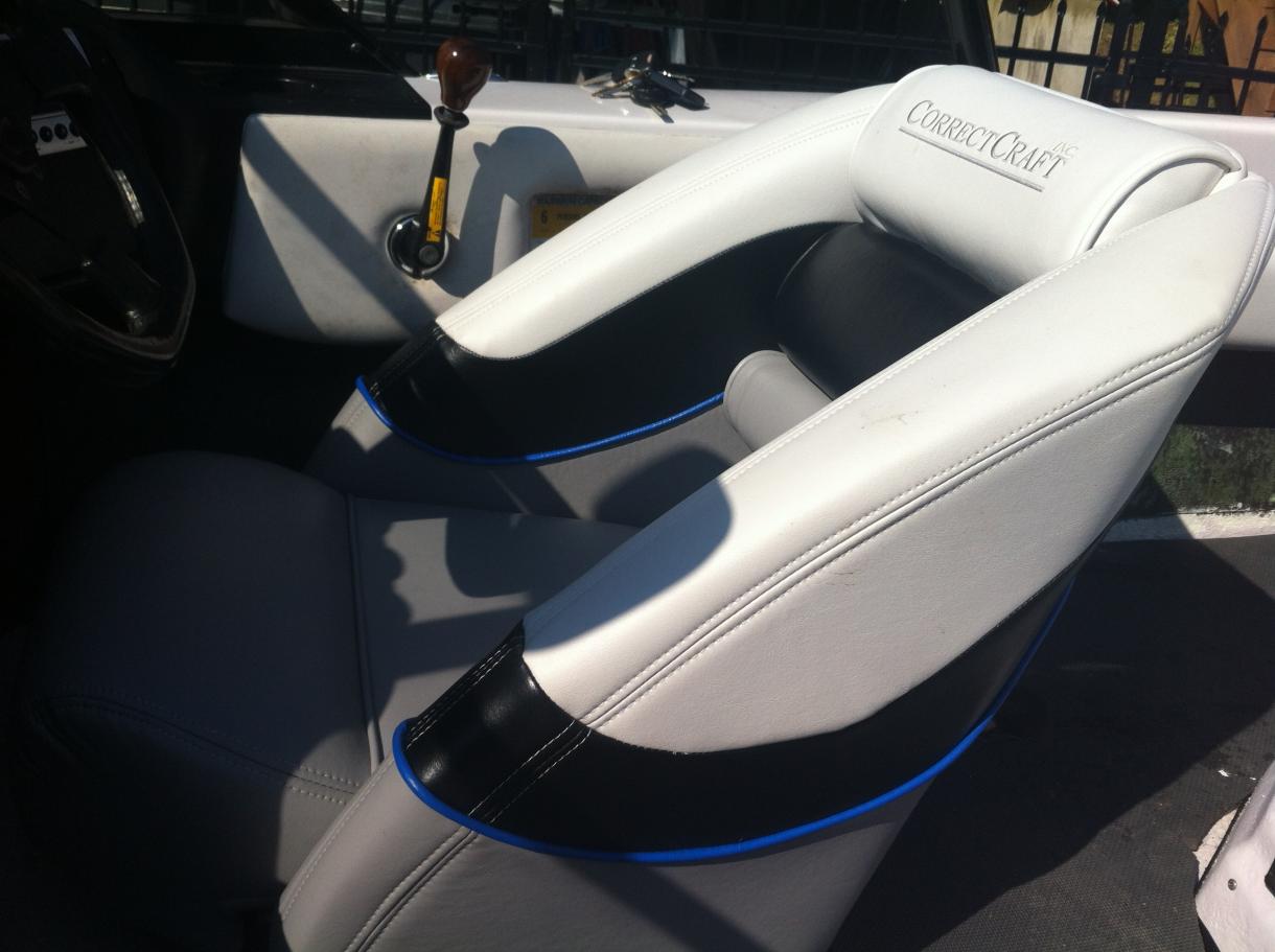

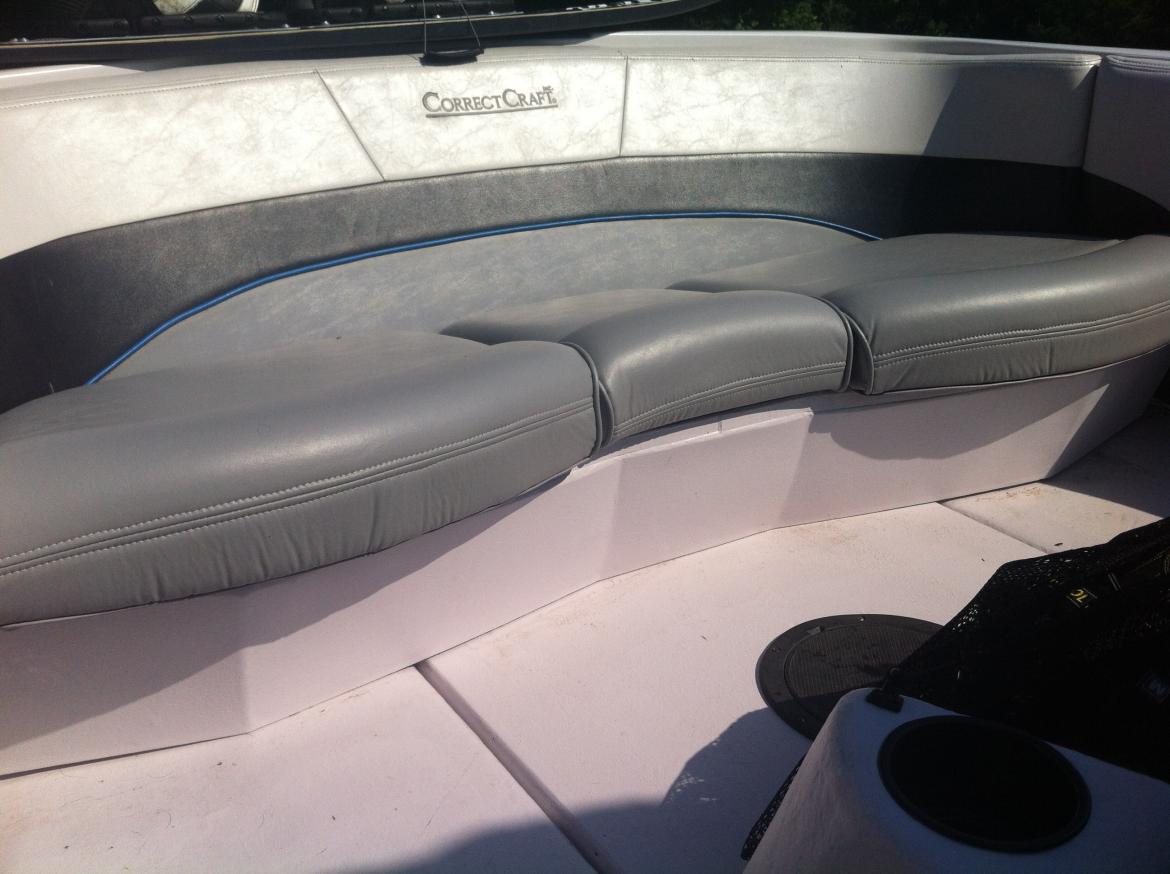

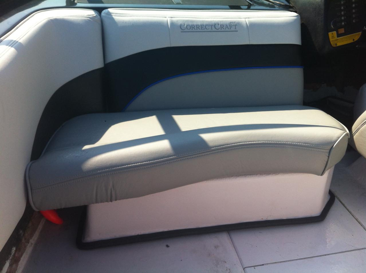

                      seat bases sans carpet
ID:	366492Click image for larger version
                      Here are some pics of the finished vinyl and seat bases. I really like the no carpet look.

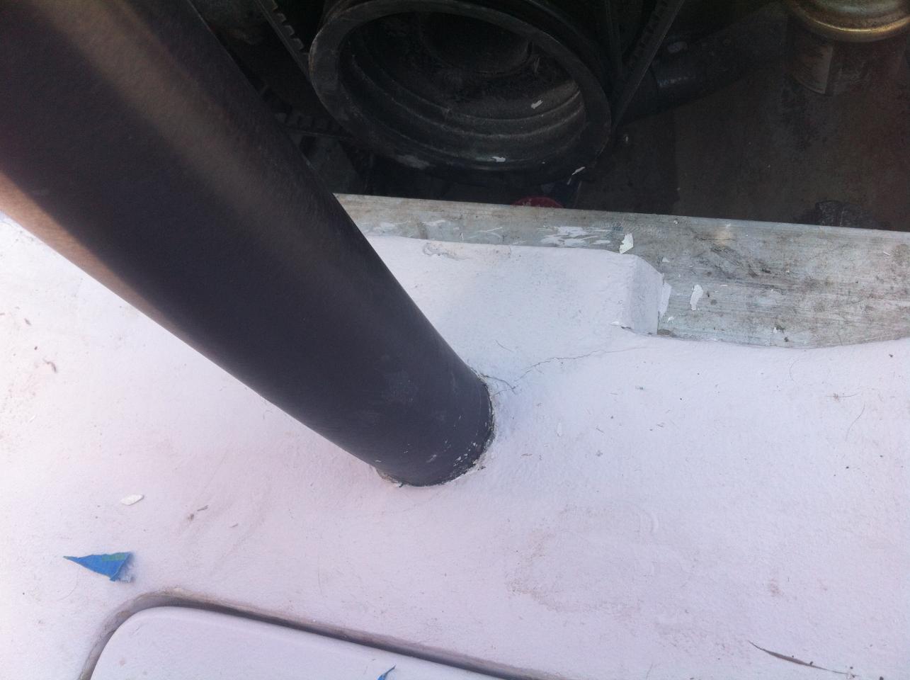

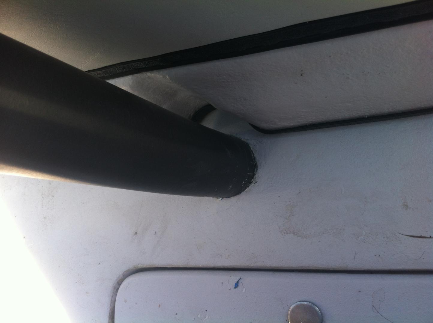

                      I got a little problem with the floor cracking behind the pylon. my pylon was bent and had cracked the floor immediately behind it. I repaired with fiberglass mat and resin but my repair cracked also. I slid the box back about 1/2" because the pylon was compressing the vinyl on the box. as you can see in the pics I had to extend the floor a bit to fill the opening.
                      Any input on the cracked floor would be appreciated, I also don't get my feelings hurt so flame away if necessary.

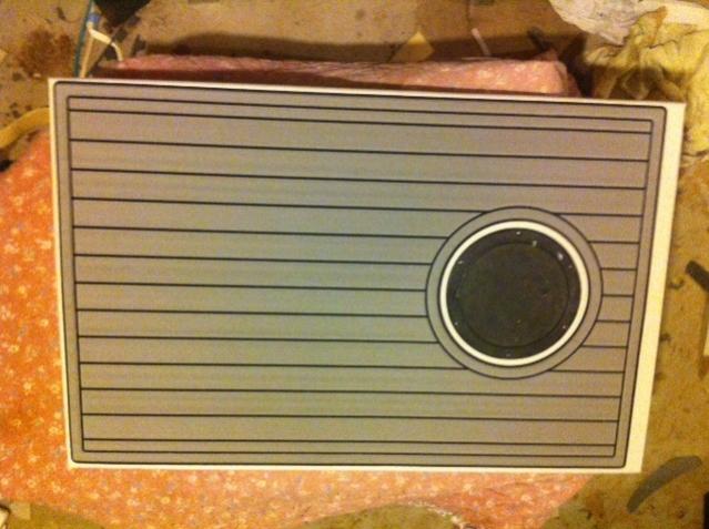

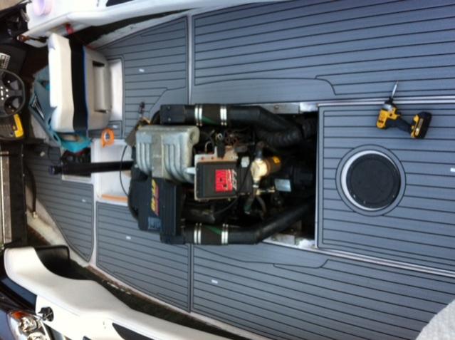

                          got my seadek in and laid it out in the boat. I feel a little like the crazy guy in the corner, a bunch of looks and no comments.... anyway for who's interested this is where I'm at.
                          P.S. sorry for the upside down pics. didn't get them edited right.

                            Nice job, that looks awesome! I look forward to seeing a shot with all of the interior back in the boat. Any ideas how many total hours you have into the project?
                            Shawn
                            2012 Blue Metal Flake SAN 230
                            • swooddc
                              • Oct 2006
                              • 147
                              • Gardendale, AL
                              hard to say on time, just the floor probably 16 hours. Gel coating the motor box base and seat bases probably 8 hours or so. The problem figuring time is waiting for resin and gel to cure before moving to the next step. so I've done it an hour or so at a time, the first batch of gel I put down took 4-5 days to completely cure due to the cool weather. Had to put a heater under the cover in my garage.
