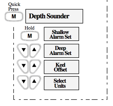

I need to do something about the depth sounder in my 04 sante 210. Thing is always beeping TOO DEEP or TOO SHALLOWOriginally posted by scottb7 View PostI fixed mine this week in 2008 sante 210. Replaced depth sounder. Ran wire to help, spliced into existing plug. Good to go.
and its a bear to turn off altogether. the button sequence in the manual lied to me

I'm having massive issues with my depth sounder and can't figure it out. I don't have a manual at all which doesn't help!
