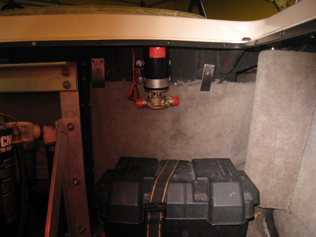

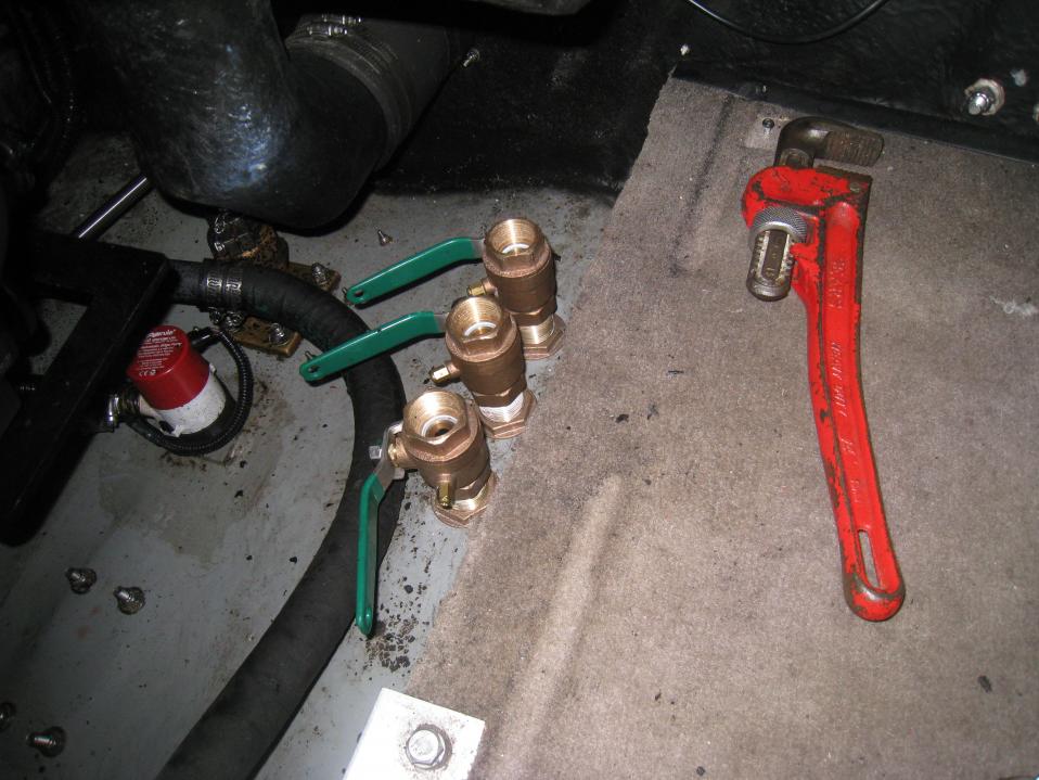

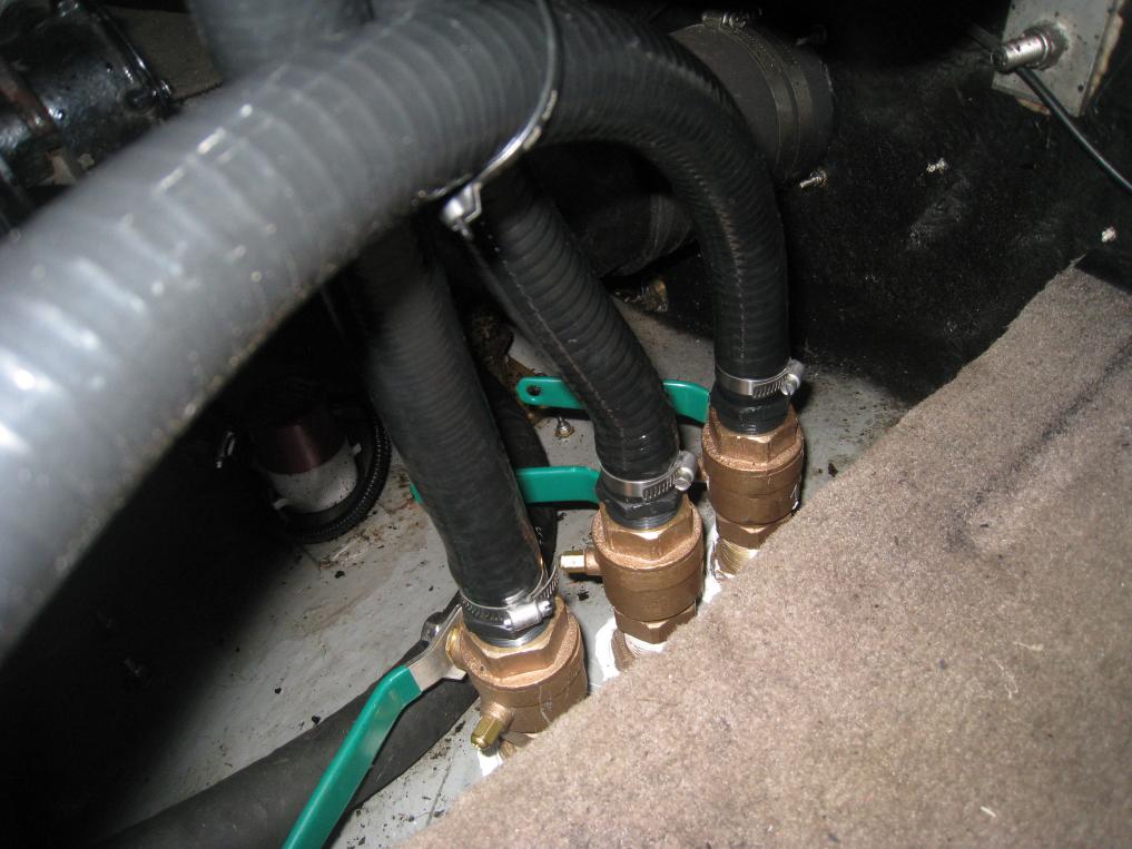

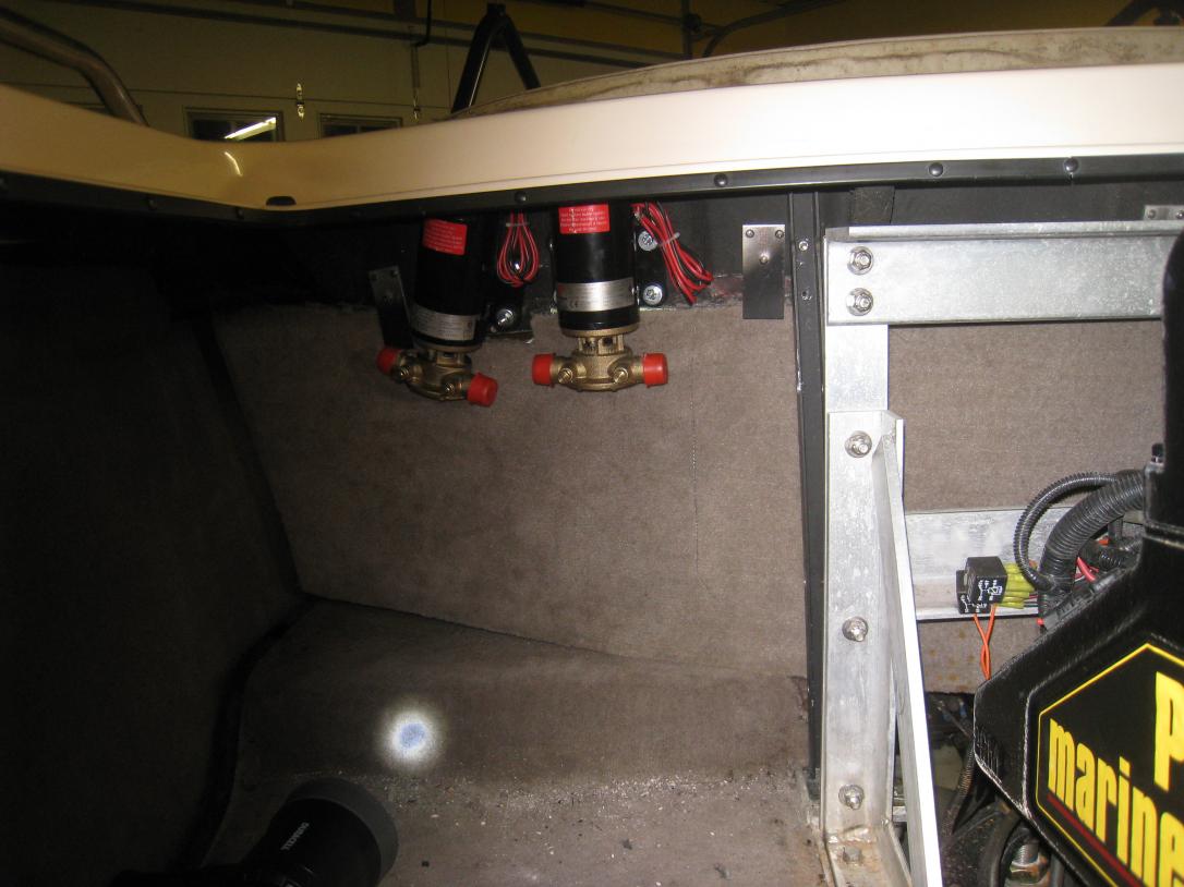

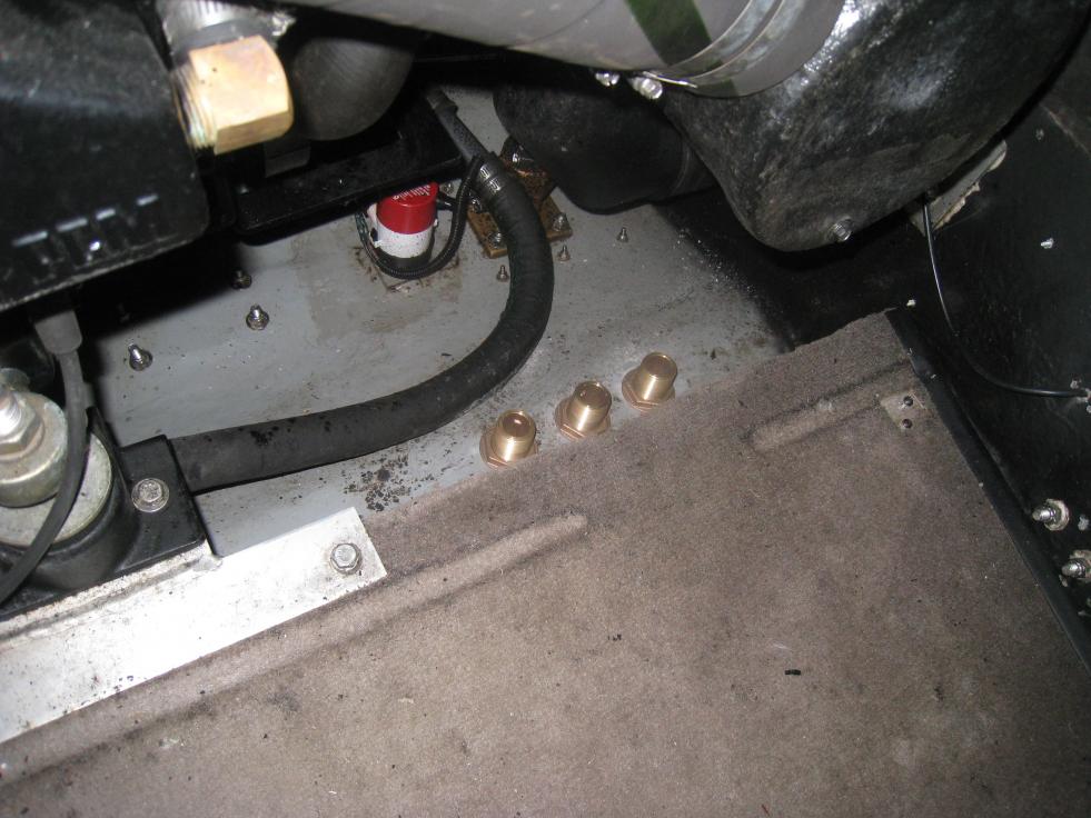

    I just took the shrinkwrap off my boat this weekend and rapidly began my custom ballast install. I'm hoping that documenting it here will help others.
    Best thing I did was work with Wakemakers.com. Over the winter I spent about $1300.00 and had them ship me every part I would need to complete a three-bag auto fill system. A fourth bag in the bow will be manually fed.
    I'll have 400lbs in each side of the engine compartment and approx. 600-650 in the locker. The bow will be filled appropriately to tweak the shape.
    Plenty of room to do anything you need to on this boat, a perfect canvas for ballast install. So far I've got about 6 hours in and have drilled the intakes, mounted the ball valves and installed (not wired) the pumps.
    I'll keep pics coming as I progress. Hit me up with questions.

    Nice job so far. Are those 1" or 3/4" intakes?
    You can put a 3-way ball valve in and hook up both your center and bow bags to the same pump. Just fill center, and then switch the 3-way to the bow to start filling the bow. Alternatively, you can put a T in and then put a shut-off on the bow line after the T. Just open it up to fill the bow. The 3-way is better for your application though, as that way will be faster as you will have no waste / overflow from the one bag being vented while you are trying to fill the other bag. However, what a shut-off can do for you is that if you get the timing / setting down, you can leave it partially closed all the time and it will fill the bow bag at the same time as the center, just slower, so that when you start venting on the center, you just shut off the pump and you will have a full center bag and a half (or whatever is the correct ratio) full front bag. This is cheap and much better IMHO than manually filling the bow sac.

      Also, I can't tell if the pump mounts are reinforced, or whether they are just going through fiberglass. If the latter, I would recommend putting in a piece of aluminum on the pump side at least (ideally on both sides of the fiberglass). The pumps have quite a bit of torque, and I could see them slowly enlarging the holes in the glass over time if not supported by metal.

        1" intakes. I figured the pumps could definitely support it, so I'd go 1".
        My bow sac is going to be exposed, on seat. I felt I really needed the storage under the front seats and also wasn't sure if I could get the weight I needed under seat, but maybe I can.
        The pumps themselves (Johnson brand) have an integrated steel plate and rubber bushings for the mount, so I was thinking that would be enough. But you could be right. I'm going to monitor it based on your input. The pumps are easily accessible so I can easily mount a plate mid-season if I see them tweaking.

          Just checked your pics. Saw you are using the same pumps. Nice touch with the diamond plate!

            I wish I could take credit for it, but Matt (Mhaaland on this forum) is who gave me the idea. Others with SANs / SS who have mounted behind the seat like that may chime in to settle whether a support plate is needed.

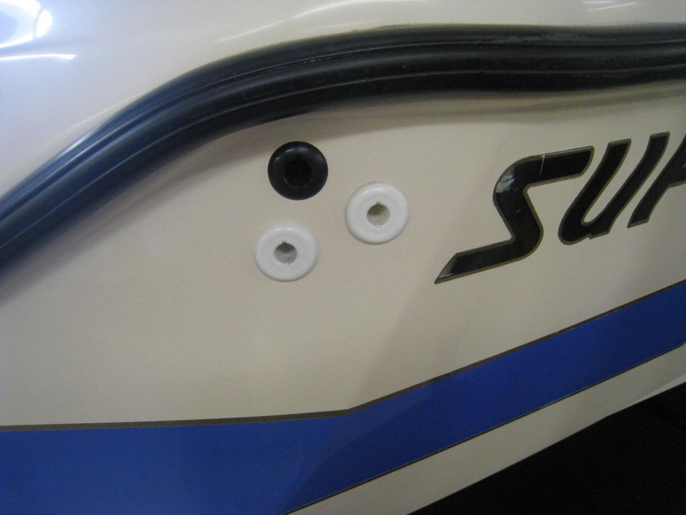

                  Hi Eseibold,
                  I hate to open this up so long after you originally posted but I am preparing to install the exact same ballast system in my 2001 Super Sport. Afew questions for you:
                  1. I am going to locate my through haul water inlets in the same place you did. Did yours work out OK?
                  2. Where did you vent your bags? Since the SS does not come with factory bags / vents, did you have to drill new vent holes and if so, where?
                  3. Overall, are you satisfied with all of your results or would you change anything?

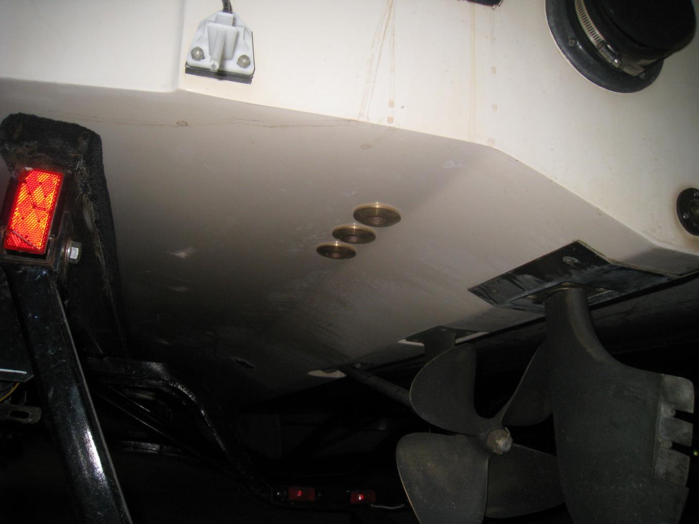

                      I went with one intake on the bottom of the boat, then split it three ways to each pump.

                        How did that work out? It seems that having only one inlet would severly resrtict flow. How long does it take to fill the 3 sacks?

                          Not when you use a 1.5" inside diameter thru-hull it doesn't. You could easily run 4 pumps off that size without losing a thing.

                            Works great! I turn all three pumps on at once and they all start filling. I've never timed it, but it's just a few minutes. The rears fill up first because they are smaller, then only the center pump is running and finishes the center bag. I did this back in 2004 and it's still working great!

                              With the 3 thru-hulls and no 90 degree elbows, do the hoses get in the way when changing the raw water impeller?
