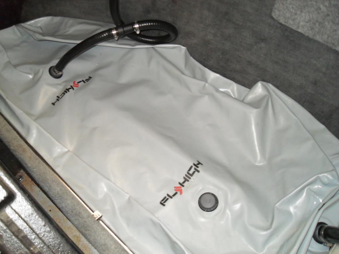

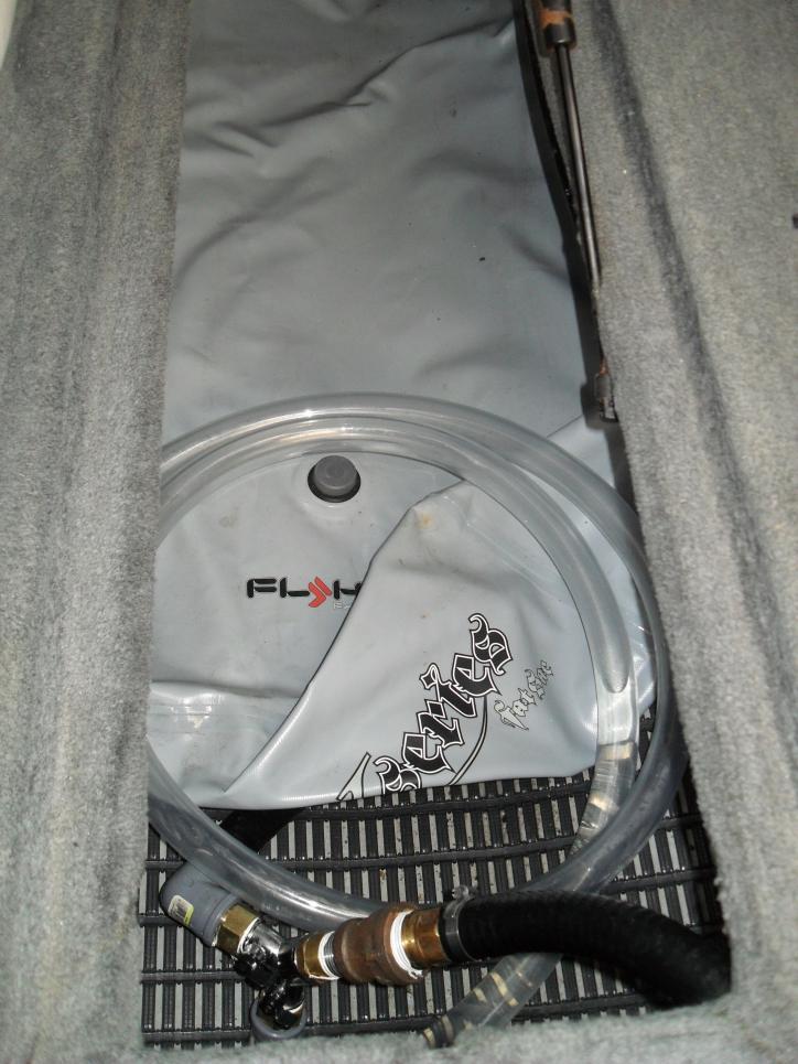

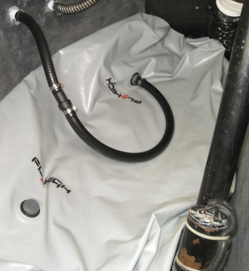

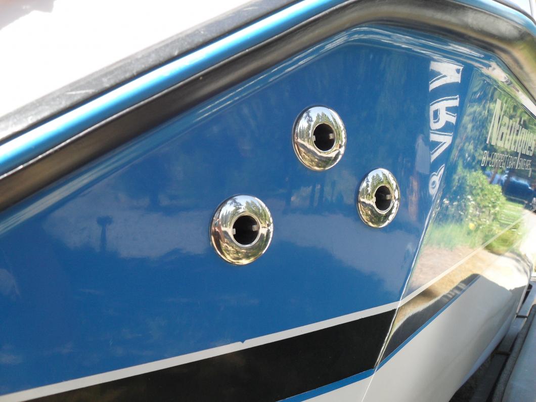

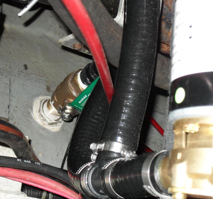

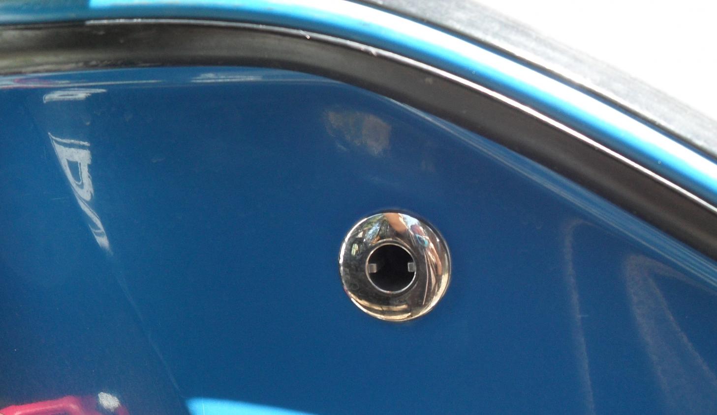

    Got this boat last year and have gotten a wealth of knowledge from these forums. Though I'd return the favor and post some pictures of what I've done to my boat.

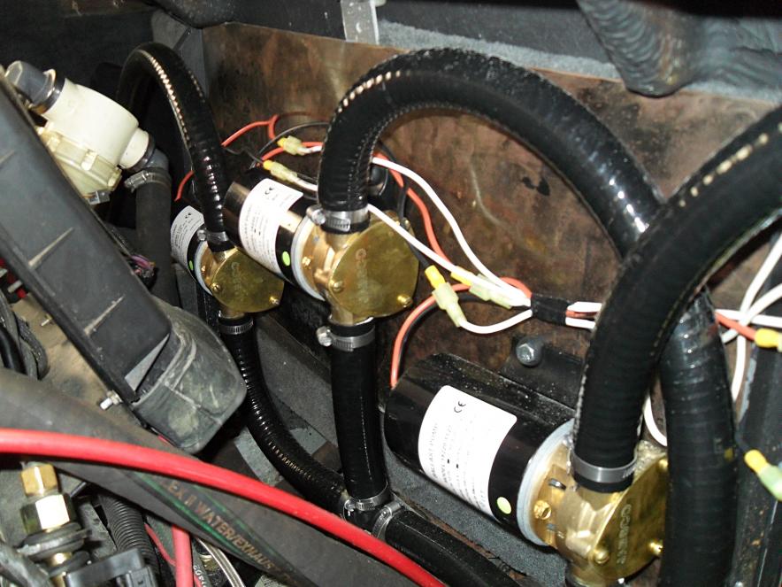

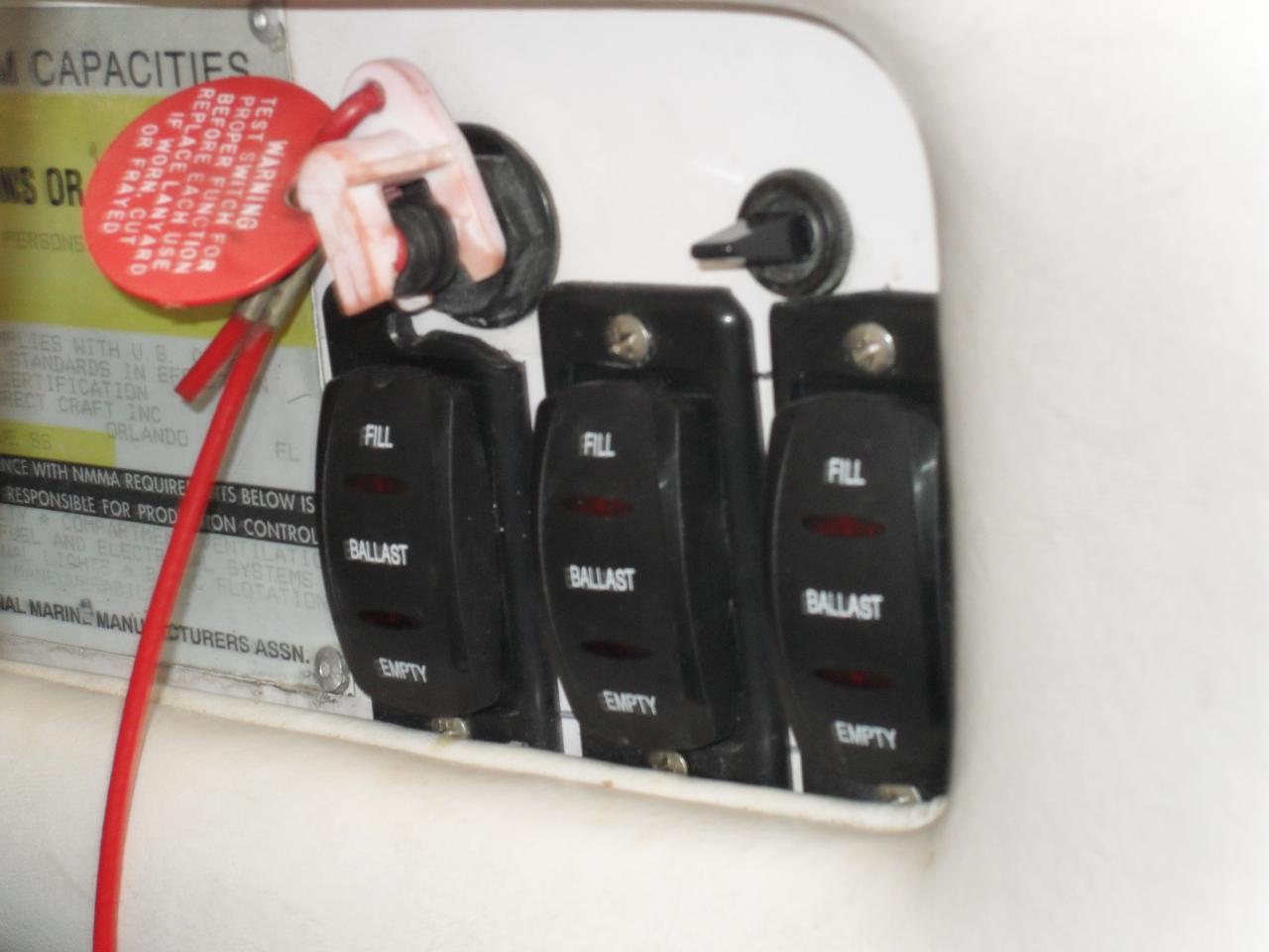

    Ballast install: 400# V-drive sacks, 650# rear seat sack for center locker, 1000# surf sack, 3 jabsco pumps

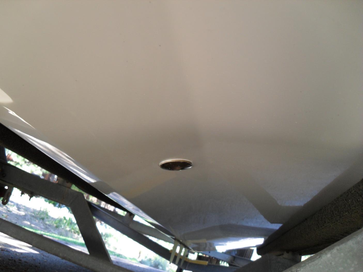

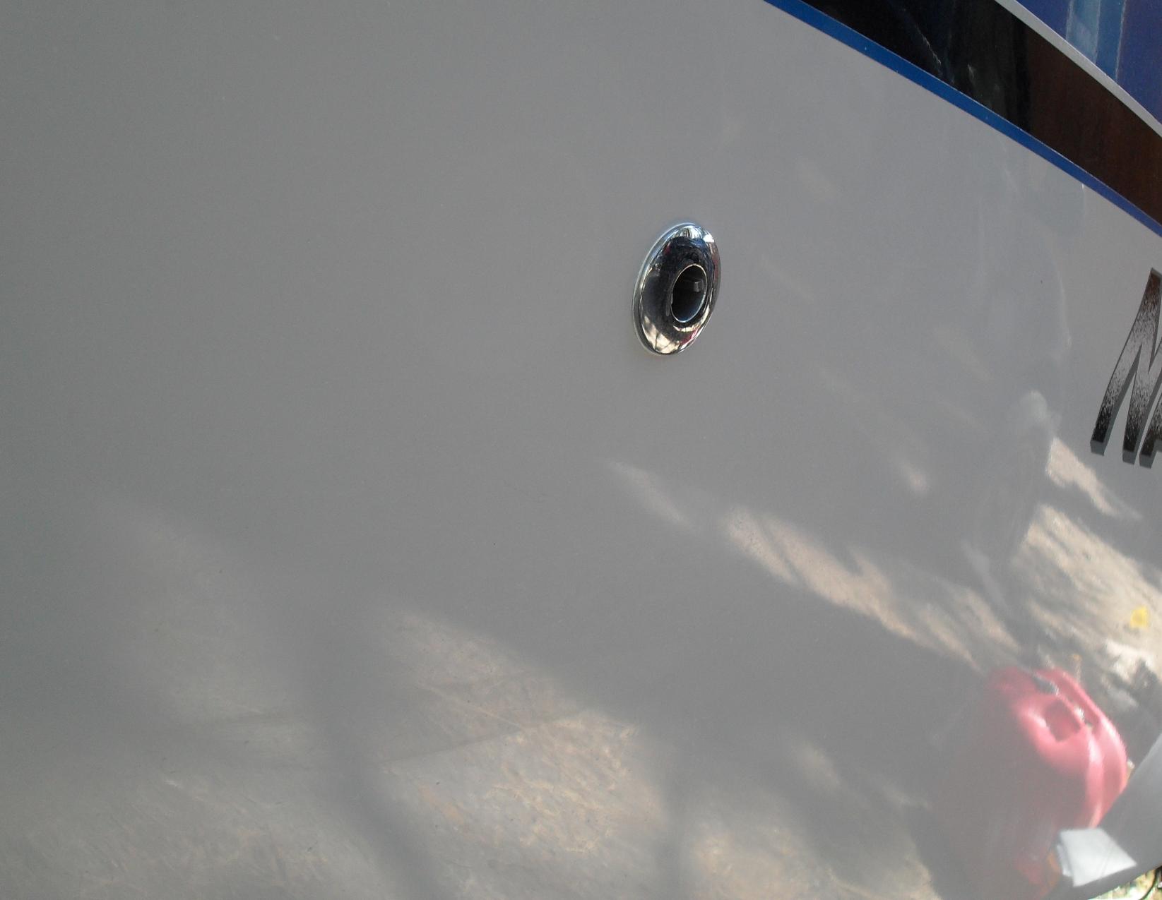

    Stainless steel thru hull replacements

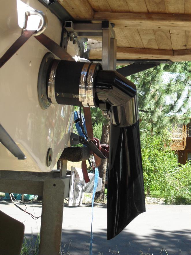

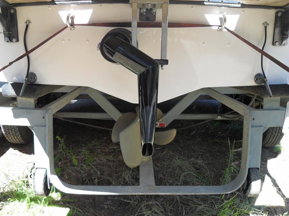

    Fresh Air exhaust
    Caster wheel install on prop gaurd
    New ACME prop

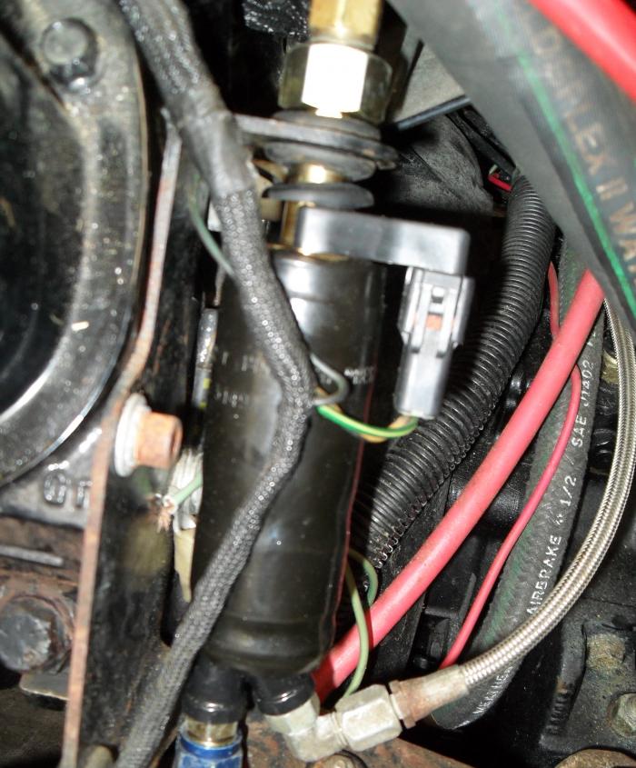

    New high pressure fuel pump (started whining)
    New steering cable (became stiff)
    New ignition switch
    Next is the perfect pass, new decals

    Very nice!! Looks like I have some competition on the nicest SSN!! Where is the 1000#er at? I'm still setting up my surf wave for port side, curious as to how you are running your setup...
    Well mine's not too nice, but gettin better every weekend... Great lookin SSN!
    • nohajs
      • Jun 2010
      • 6
      • 95 SS
      I put the 1000# bag on the seat on the side we are surfing. Well I actually take the seats out and put it on the seat frame so I don't split my vinyl. I put a y valve on the center sack line and have a quick connect on the surf sack and loose hose. I also move two 75# tire weight bags to the surf side.
      One or two extra people on the boat and the wave is huge. We don't surf the port side much because of the prop rotation and my family is all goofy. When we surf the port side all the weight must be on that side and we have to turn pretty sharp to get the wave to clean up. Sometimes I drive from the observers seat even.
      Good luck with your wave. It's big when you do it right.

                        I used the seat bag because the dimensions were very close to the size of the ski locker. I think the 750's are too big for the space. I also use a 1000# surf sack on either side for surfing or I put it in the bow for wakeboarding(Half filled). It puts out as big a wake as I can handle.
                        To the other guy: I installed it all myself. Cost about $1000 in supplies.
