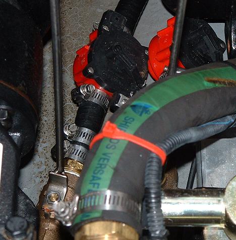

My new valves are about 1" from the thru-hull fittings. They couldn't get any closer. I'm going to pull the hose off of the thru-hull fitting and see if it will pull water from a bucket. If not, I'll do further diagnosis. I really hope the valves aren't restricting flow, but it sure seems like they might be. I'll know for sure tomorrow or Monday.

could you take some pictures of your valves? where they are located. I must say, the flowrite valves do not look very durable, I was going to add the valve switches to my boat and use different valves to control the flow, the switches work fine, the actually valve is pretty cheap. I must agree though, if its placed backwards, the water would push right through the valve, even if its in the closed position.

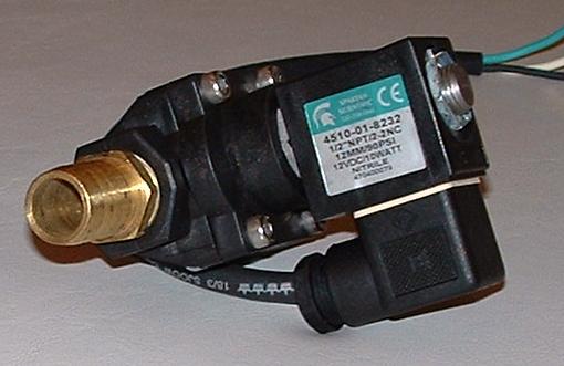

I'm interested to hear how the yard irrigation valves perform on the boat. I purchased one $10.97, 3/4" 24 VAC just to see if 12 VDC would drive it. I hooked it up in a utility sink and it works fine. It cuts on and off definitively with no leaks using an auxiliary battery at 13.5 vdc. But this is with pressure in the correct direction of flow thru the valve.
In the boat configuration, the pump will be pulling a vacuum on the valve. The valve is a spring diaphragm with a solenoid that allows pressure to equalize on both sides of the diaphragm. Pressure, or hopefully vacuum, will overcome the spring and allow flow.

My plan is to move the valves from in front of the pumps to behind. I'll be doing this tonight or tomorrow, and hopefully this will solve my problem. My father-in-law, who owns the company who sold me the valves, feels that this should take care of the issue.

Mike-d,
The Spartan valves NautiqueJeff is using are pretty expensive for the normal Joe. The valves (Rainbird, Lawn Genie, etc.) you had success with can be had at Home Depot or Lowes for about $11.00 per valve. Add another $4 to $6 for fittings per valve. So for less than $60 total the helm operated manual valves could be replaced and wired parallel to the individual tank fill pump circuits. You need to pump this up. Uuhhh - no pun intended.

Jeff, check with the manufacture of your solenoid valves. Some solenoid valves use system pressure to help the valve open. See if a min opening pressure is specified. Also, as someone mentioned, the CV (resistance to flow) is higher for most solenoid valves because the solenoid is not that strong, so a smaller opening is needed to limit the pressure trying to open the valve while the spring is trying to hold it shut. I am currently looking for a low CV low differential pressure valved to consider replacing my “live well valves” with. However, given the choice I would go with a mechanical valve.
I have begun looking for a brass or possibly plastic ball valve which I can replace the operator (handle) with a stainless steel disk so that it functions the same as the original “live well” valves. Then I will mount these directly on the brass ball valves (keeping the mechanical valves at the tru-hull fitting.

Hmm... Forgot to update this thread with the latest. I attempted to move the valves from in front of the pumps to behind, and ran into another problem. The hose going into the pump is one size, and the hose coming out of the pump is another! Because of the different size hose, I had to order new fittings for the valves. They should be in tomorrow, and I'll try to install them again this coming weekend.Please do not PM me directly asking for advice on how to repair your boat. While I would love to help everyone, I simply do not have time to respond to all of the inquiries. Please post your questions on the forum, so that all of our members have a chance to answer.

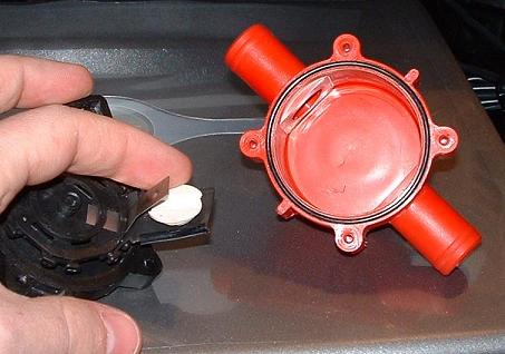

2002 Air Nautique (DD)
