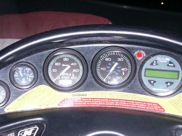

    Well I just bit the bullet and upgraded to the Faria gauges in my 2000 SN. They look really nice and seem to work fine. The instructions for the conversion with PP Pro is really easy and took me just under 2 hours. If you don't have PP you need to mount a paddlewheel through the hull. Its hard enough to cut perfectly good wires in the dash of a 25K boat.. I draw the line at drilling holes in the hull. I have attached a picture with the new gauges.

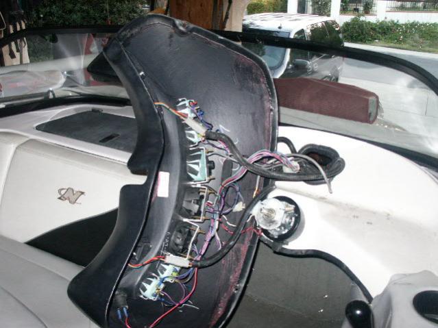

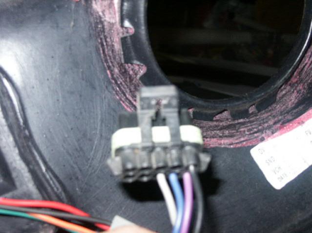

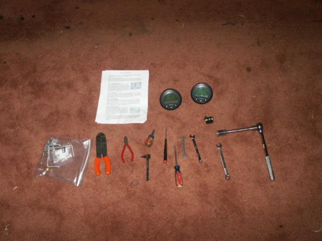

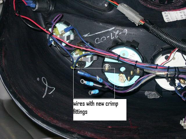

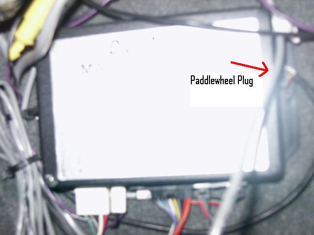

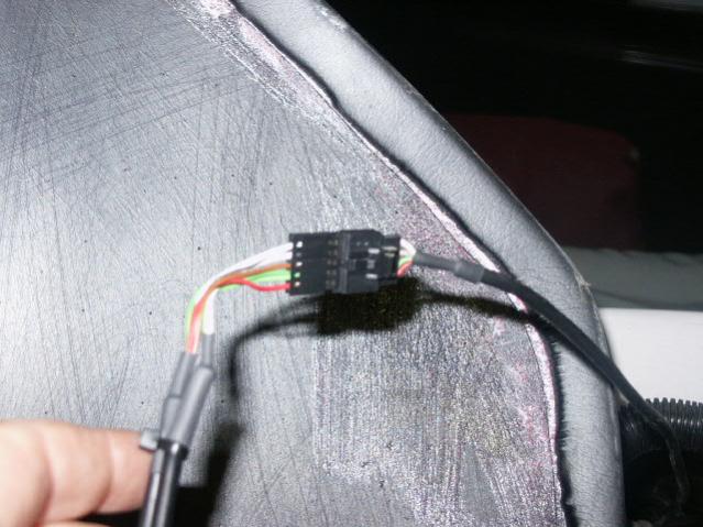

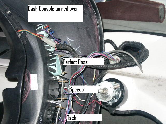

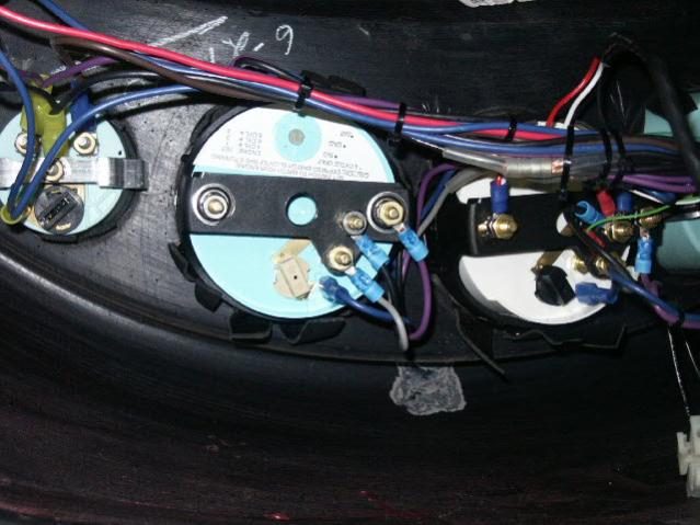

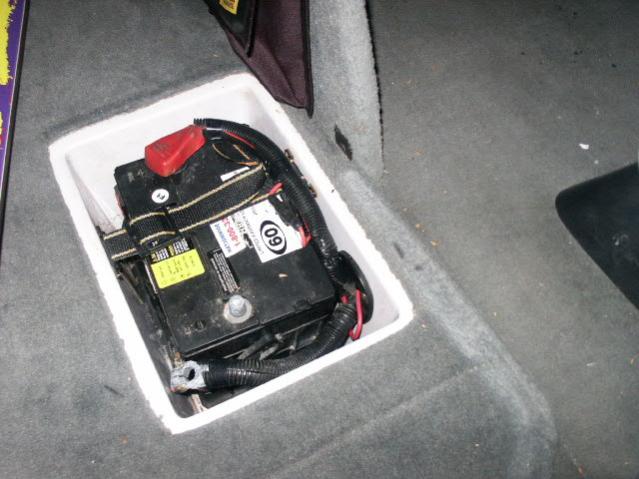

          Step by step conversion
          I'll try to do this step by step. The directions are first rate. The 3 things that may be gotchas are the light on my speedo is red and everything else is blue. If you have a 12V source you might want to check that before you button everything up. Also make sure you set the Tach for 8cyl on the back, you can't miss the switch. The directions say to attach the purple wires to the IGN terminal but my gauges said BAT.. Same thing. Cover the steering post so you don't scratch the console. PM me if you have any questions The whole thing took me about an hour and 45 minutes.

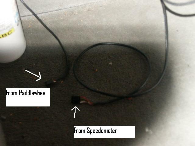

                    Good Post, but this does not tell me how to wire up the speedo. Your wiring directions are just for the Tach. Help! I can follow these same directions, as far as the BAT, GND, and Blue wire for lights, but what about wiring the sensor part?

                          • ripfish
                            • Sep 2003
                            • 14
                            • Chico, CA
                            Thanks for the help those instruction you sent were not the same as what I recieved from WCCC. Your's were more specific to the Nautique and more detailed.
                            Long Story Short, I will post a paddle wheel test procedure because it was not my wiring that was incorrect. Ends up the PP Paddle wheel has failed and that is why I could not seem to get the Faria Speedo working!! Took me three days to get to the bottom of the boat to figure that out...
                            After test running the boat and still no speedo, I put the paddle wheel input directly back into the pp black box.(Back to original) No speed on the PP display either!
                            Called PP and spoke with a great person there who walked me through testing the paddle wheel and sure enough it has gone bad. Coincidence I guess that my paddle wheel was not working when I tried to do this gauge update. I have not used the boat much over the past 12 months and may not have noticed that the paddle wheel was not working. Since the PP runs on RPM, it really doesnt matter and obviously did not come to my attention.
