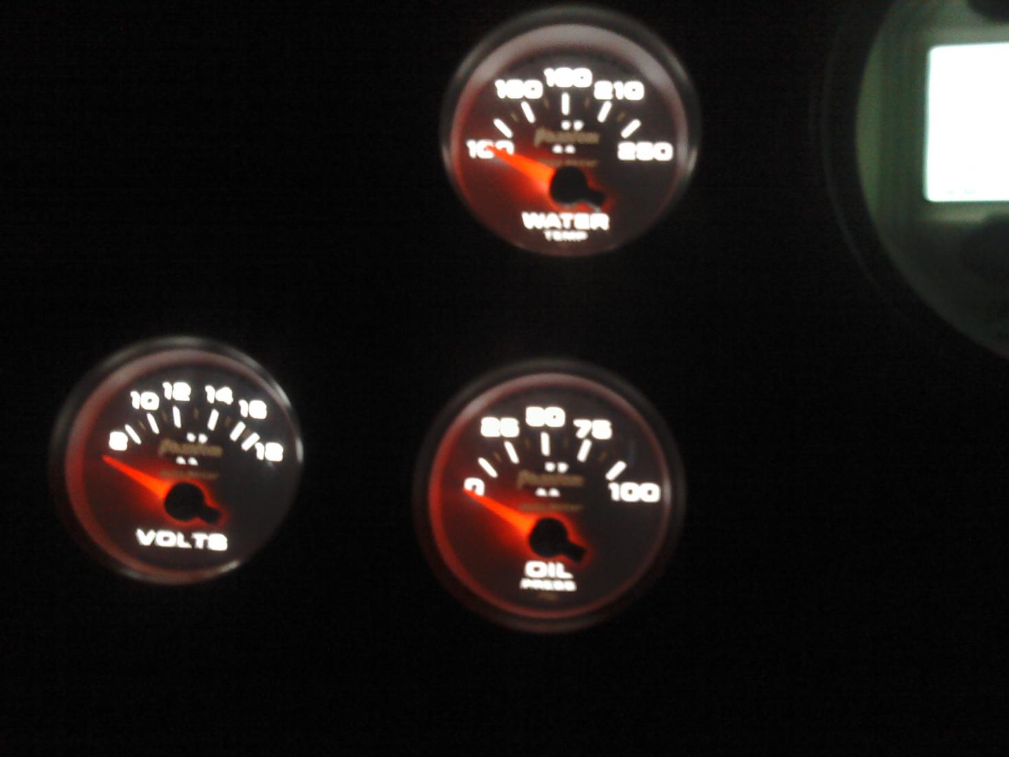

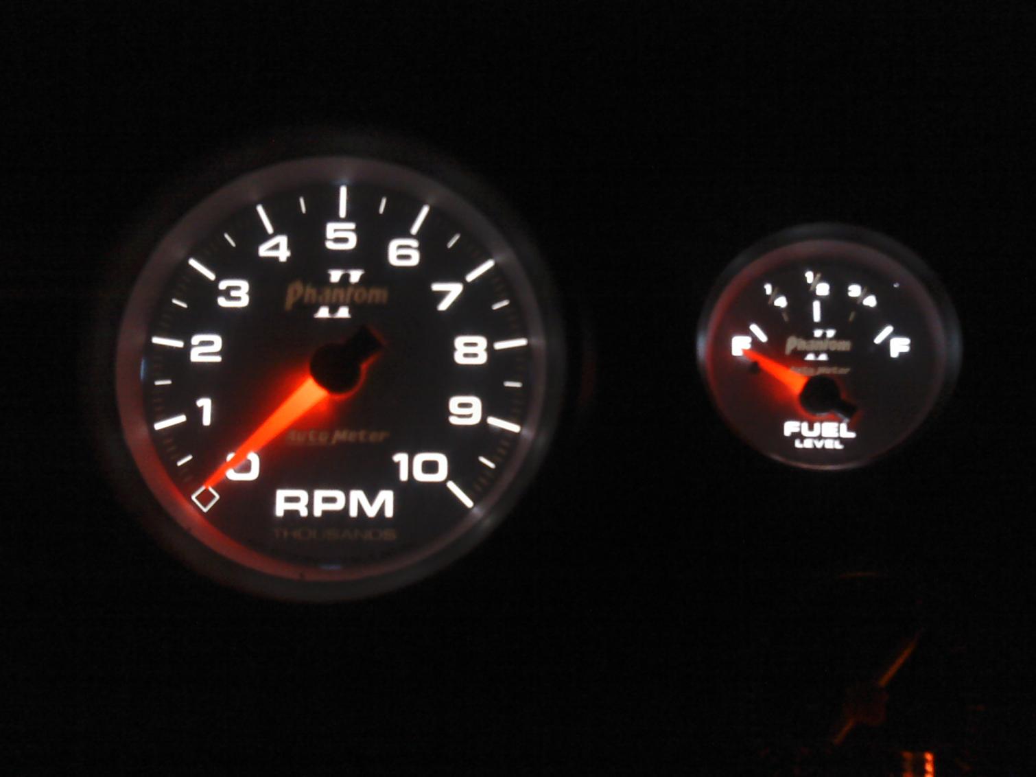

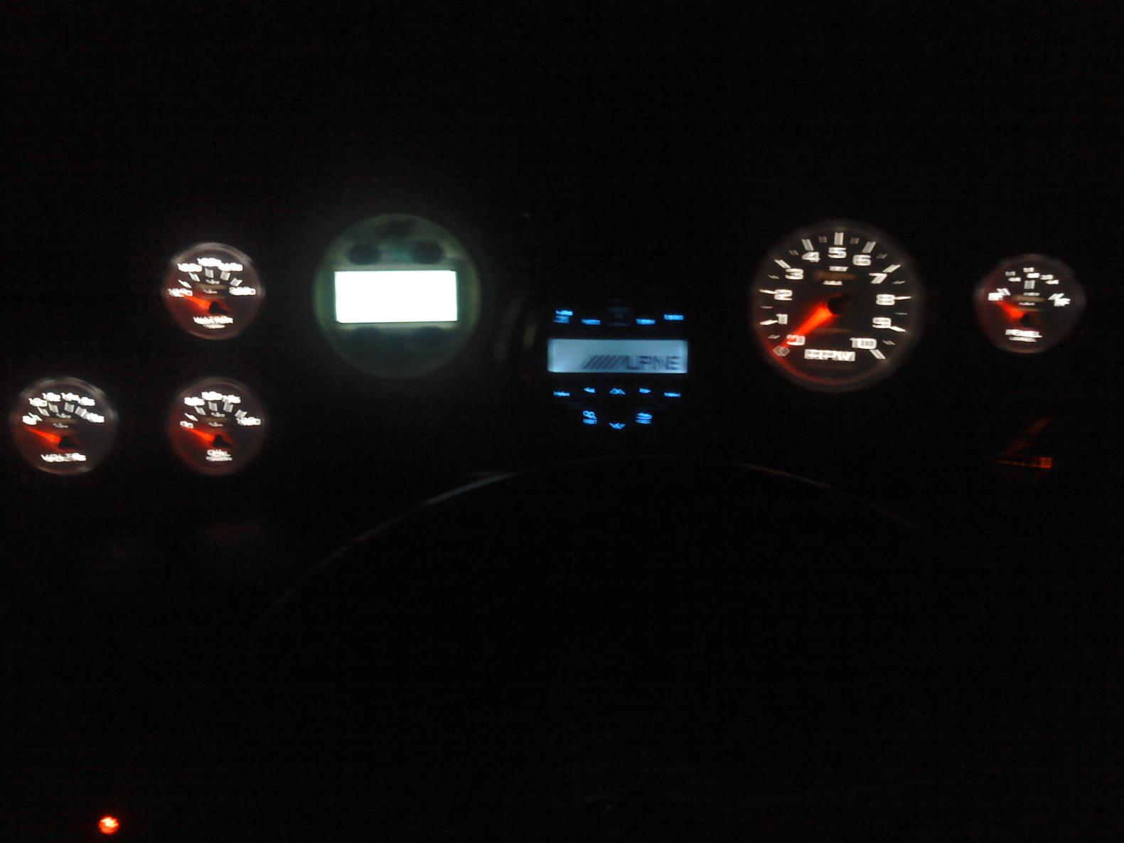

hooked up the lights the phantom 2 gauges look great pics isnt the best though
Look great! What did you do about a fuel sending unit? By chance, was it a direct hook up or did you have to fiddle with resistors??Last edited by Ceruzziracing; 07-22-2010, 01:31 PM.'97 SN 176 GT40
Also, were you able to use the existing oil pressure and water temp senders, or did you have to replace with the Autometer ones. Thanks, Tom.'97 SN 176 GT40
the oil pressure and water temp gauge came with the sensors easy install and the fuel gauge is 240 to 33 ohm part #ATM-7516 it works pretty good but when shows empty still have 1/8 to 1/4 tank but dont mind works goodOriginally posted by Ceruzziracing View PostAlso, were you able to use the existing oil pressure and water temp senders, or did you have to replace with the Autometer ones. Thanks, Tom.
Looks good, prices aren't bad either. Even found the speedometer with GPS sender versus pitot. Nice job on the dash.'97 SN 176 GT40
