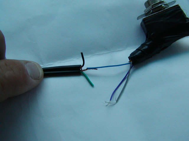

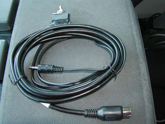

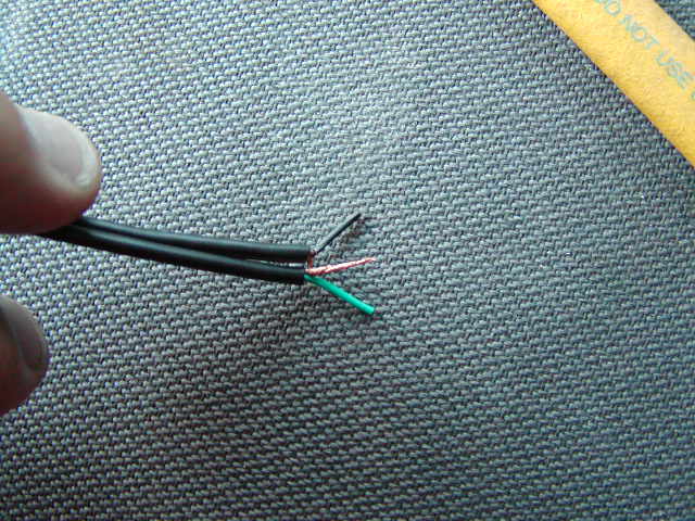

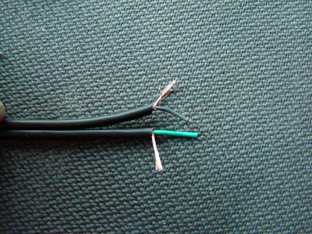

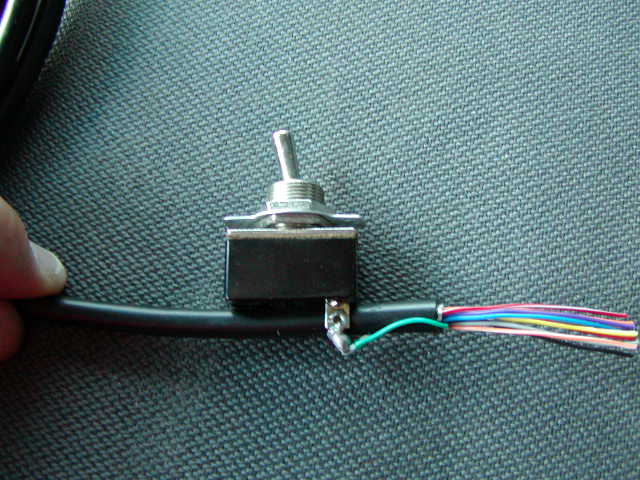

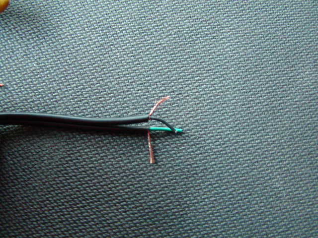

      Lets try to make it 9 pages... I took pics of my last build. I built it for a PN member who asked for help. He shipped me the parts and I will be sending it out to him after I verify that it works. One should not really complain about lack of a how to build though. We all have busy lives. Attached are the pics I took. When I get a chance I can do a step by step for you.

          No hard feelings. I love the internet for doing projects. I have benefited from many sites like this and others for “how to dos”. Just yesterday I needed to look up how to change the oil on a friend’s waverunner. I was able to find step by step as well as a 16mb movie. Pretty awesome someone took the time. I tried giving the links on my first post but they seemed to not work after I copied and pasted them. I then took screen shots and put in a word doc. I built the harness for the PN member while I was on my lunch break in my car so the pics are not the best. Since you seem to have experience doing write ups I will leave it to you to make a quality link.

                  I wired it using the photos from Echo's post and it worked perfect.
