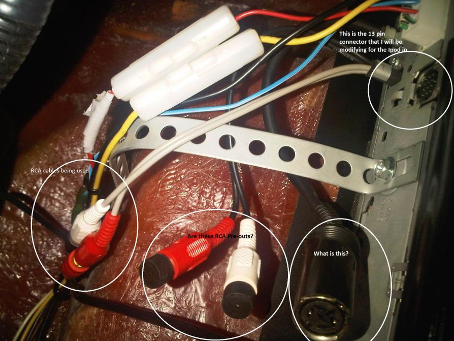

Since we have lots of Clarion XMD-1 experts here, I was wondering if you could also explain what the other pair of RCA cables are.. Is it another pre-out? The people that installed my stero did some stupid move by splitting the 1 Pair of RCA cables they ran to 4 channels with 2 "y" cables. Makes me mad that they did that if indeed this other RCA is a pre-out. Please let me know if you know, it doesn't tell in the manual.
(uploaded picture to show you)

- Found out after reading lots of info about the Clarion XMD-1 that indeed, it does have 2 rca outputs..
- Found out that running the 1 set of RCA cables and splitting it into 4 channels isn't /horrible/ but it's not exactly the best thing, you lose maybe 1db and /can/ get a little bit of distortion through the wires, as well as losing the option of fading. I will probably run another set of RCAs just to do it correctly.
