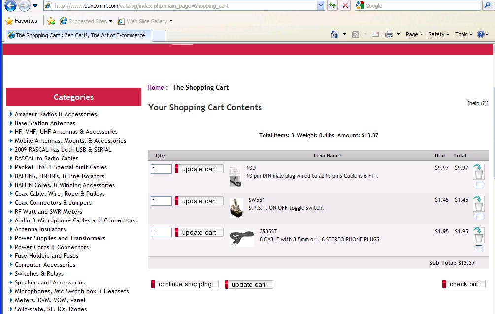

http://www.buxcomm.com/catalog/index...=shopping_cartsigpic
i just ordered the parts but have a couple questions and cant remeber if they were answered in one of the eleven pages on this thread. You guys are mounting the toggle switch inside the glove box. Are you also drilling a hole for the ipod wire? didnt see any pics with the ipod connection hanging out from a hole. I think a cleaner look would be to mount the RCA jacks next to the toggle and buy the RCA adaptor, any thoughts or suggestions. Finally, does either of the above mentioned methods charge the idpod?
