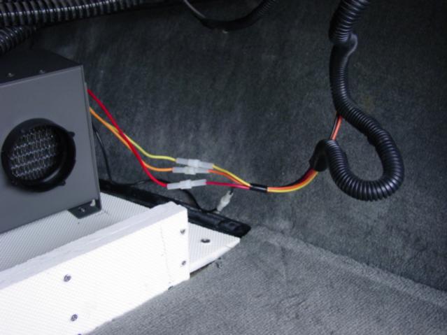

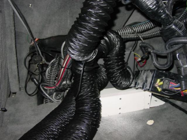

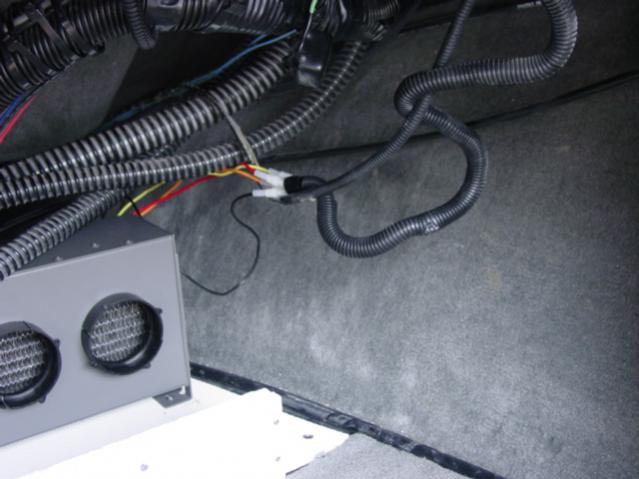

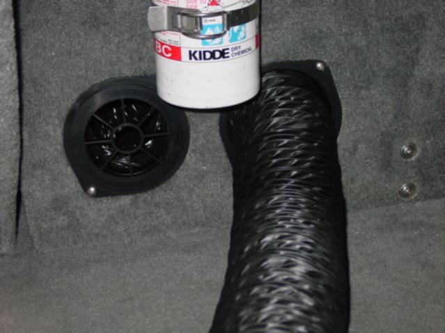

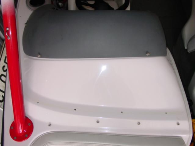

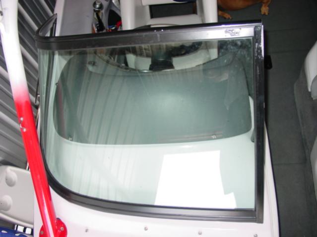

I have not completly finished yet. Keep in mind that I did take more steps than necessary to install it, and I took a lot of brakes in between works sessions. As soon as it started becoming wok, I stopped walked away and did other things. This is meant to be fun, and there is no sense rusing it and not enjoying the work.

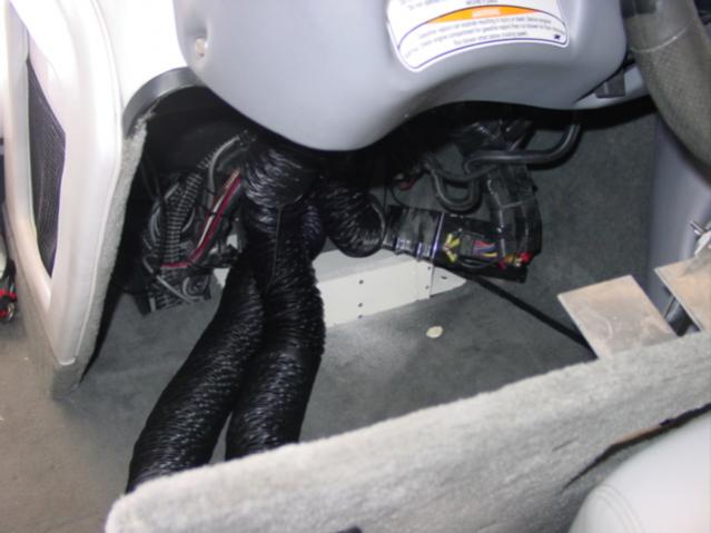

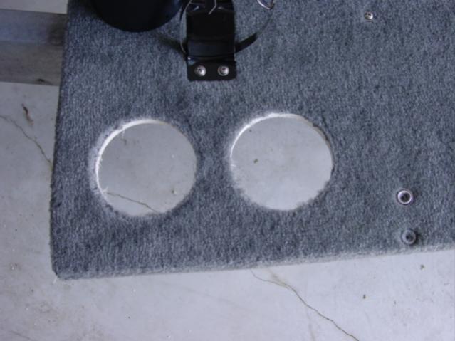

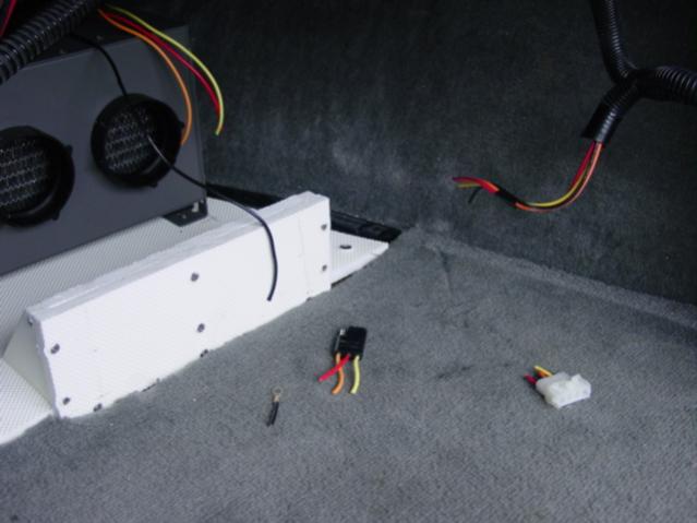

I cut the chunk of fiberglass out because it really would have made mounting the heater harder with the way it was in there. (My '02 has a stupid cooler under the bow seat right in front of the driver which limist the amount of space available in front of the hump. Sure there was room, but I just did not like it. It was throwing my feng shui off knowing it was back there. Once it was removed, i had tons more space to work back there. The thing was entirly too big for the purpose it served. All it was there for was to attach the kick panel too, and it did a poor job of that as well. if CC wanted to make an attachment they should have made it verticle at the kickpanel, and only 4-5" tall, and slope down from there towards the bow.

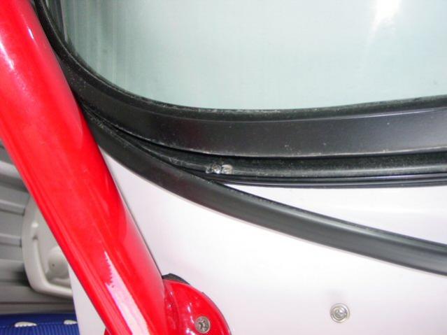

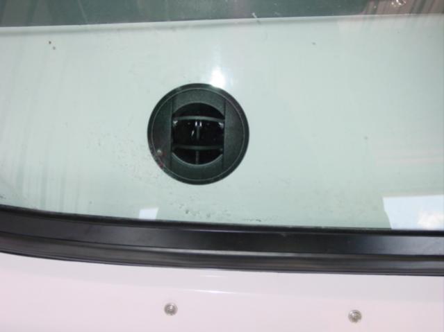

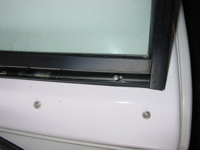

I would estimate my actual work time invested as 8 hours start to finish (including cutting vents that have not been cut.) The windshield vent might add some time to that if it is hard to disassemble and reassemble.
