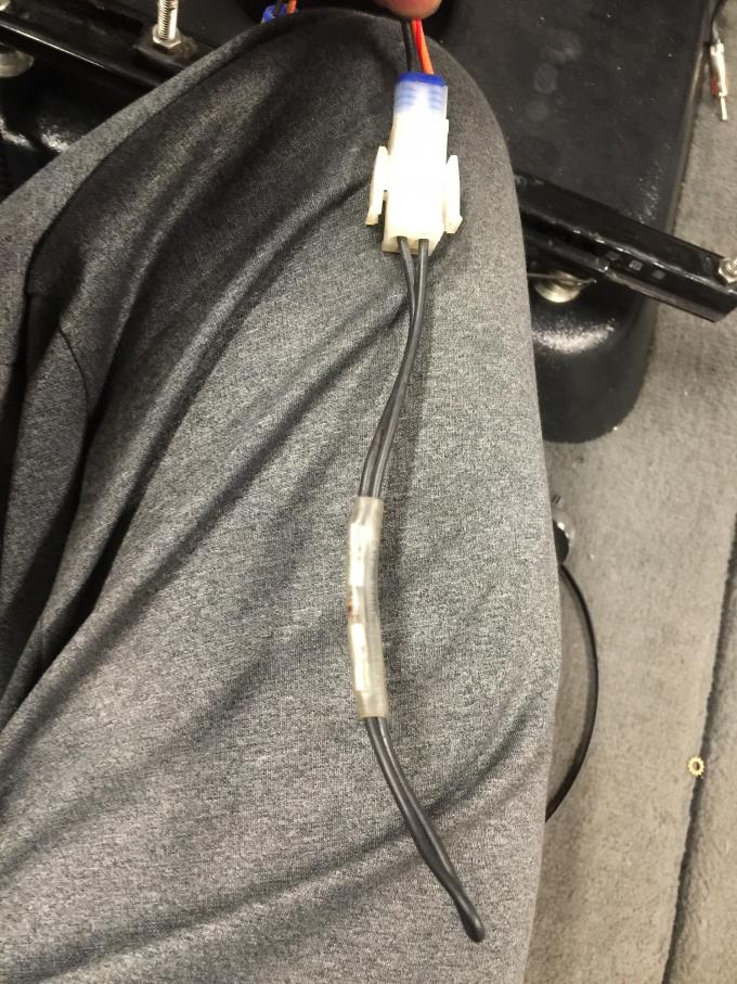

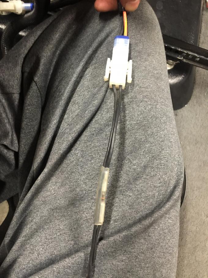

I am looking for an answer to a similar question.
I found the same coil of wire under the dash of my 2000 Super Air while redoing some other wiring, and couldn't figure out what it went to.
So i uncoiled the loom and chased it to the main wiring harness that goes to the switch board under the dash.
I would just like to know what it is, it appears to be nothing. My guess would be wiring for the Launch Control system, which my boat did not come with.
It goes to pins 37, and 38 on the harness
Wire colors, Orange/Yellow, Orange/Red, with two Black(grounds)
Which are also looped back to themselves, through a resistor.
Can someone confirm what this is?
See picsLast edited by T_Bone17; 11-08-2017, 08:09 PM.
