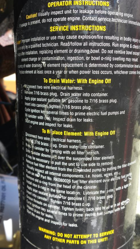

Can anyone give instructions about replacing the FCC fuel filter? I don't have anything in the manuals giving specifics about it. Thanks
I believe you just unscrew the FCC bowl from the base. Be sure to open the fuel drain on the bottom of the FCC to drain the fuel (and release pressure) before removing the bowl.
