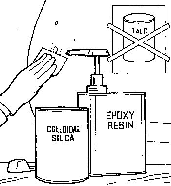

          Repair materials
          Effecting the repair of a few hull blisters requires an appropriate quantity of epoxy resin and hardener. Do not use polyester resin for blister repairs; you need the stronger adhesion and better water impermeability epoxy provides.
          You also need a filler to thicken the epoxy into a putty. Select colloidal silica. Never use microballoons or any other hollow or absorbent (talc, for example) fairing compound to fill blisters.
          A quart of acetone, a box of TSP (trisodium phosphate), a few acid brushes, and a 36-grit sanding disk completes your supply list. If the blisters penetrate the laminate, you may also need a yard of 6 to 10 ounce fiberglass cloth.

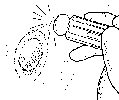

          Minor Blistering

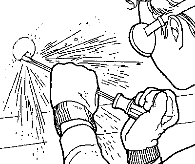

          The first step in minor-blister repair is opening the blister to let it drain. Pop the dome with a chisel, screwdriver, or rotary tool. Be sure you are wearing eye protection; pressure inside a hull blister can be double that of a bottle of champagne, and the fluid that blasts out when you pop it is acid
          Load a disk grinder with your 36-grit disk and grind the open blister into a shallow depression. The rule of thumb is that the depression should be 20 times as wide as it is deep, and it should only be as deep as required to remove any damaged laminate beneath the gelcoat.
          Use a plastic mallet or the handle of a screwdriver to tap the hull all around the blister. Sound laminate will give a sharp report. A dull or flat sound anywhere indicates additional delamination, meaning that the blister is larger than you thought. Increase the circumference (not the depth) of the depression until the laminate all around it is sound.

          Just before filling, scrub each depression briskly with a clean rag dampened with acetone.
          Mix a small quantity of epoxy (one pump) and paint this unthickened resin into the cavity. Wet out the entire surface of the depression. Use an acid brush to apply the epoxy and give this application 20 or 30 minutes to begin to kick. For shallow blisters, prepare a small amount of fresh epoxy (one or two pumps) and thicken it to peanut butter consistency with colloidal silica. Fill the depression completely with this mix, using a squeegee to compress and fair the filler. Silica-thickened epoxy is difficult to sand, so take extra time to fair the epoxy as well as possible while it is wet.
