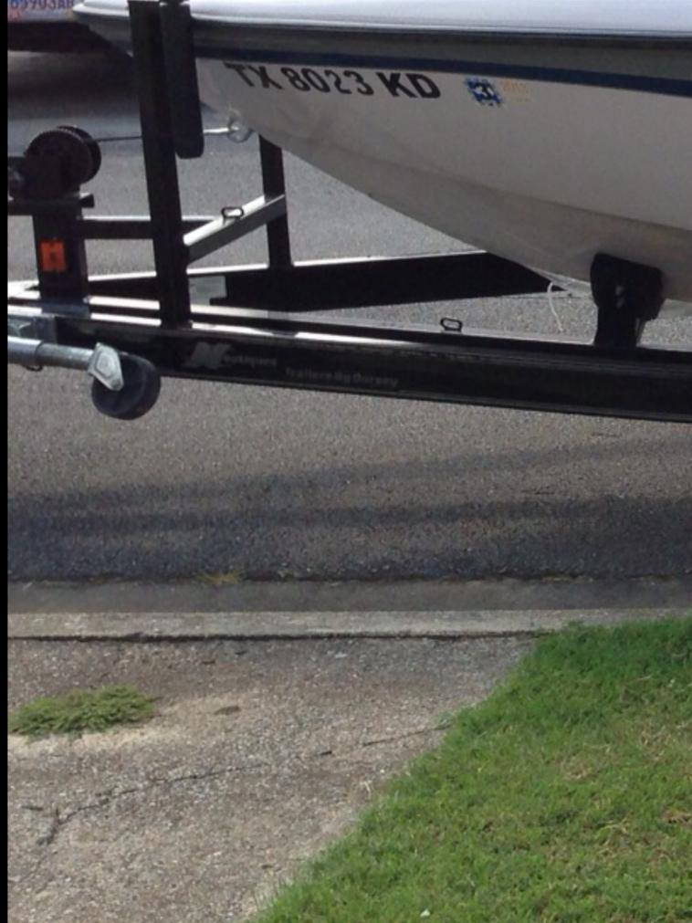

                  This thread is older than dirt, but I'm going to revive it to post a picture. I just had my 98 Dorsey modded for a removable tongue. I went the "sleeve"/slide out route because I needed as much room as possible to get my boat into a 20' deep garage. Had my local CC dealer's owner do the welding and it turned out great. It has been painted since this picture. This is based on the way Dorsey used to do it from the factory. Function over form to be sure, but it works great. Had to really scrounge for pictures of old Dorsey trailers with removable tongues. I can provide more pictures on request.

                              Dorsey set up the trailers differently as ordered. My dealership took one look at my trailer and said, "That's a Buxton Trailer." Apparently, my crash pad posts are closer together than other Dorsey trailers, which is how Buxton ordered them.
                              I'm sure Dorsey put swing tongues or removable tongues depending on the preference of the person or dealership ordering the trailer. In my case, I opted for a removable tongue because, in my situation, every inch mattered.
                              This is mine before the modification.
