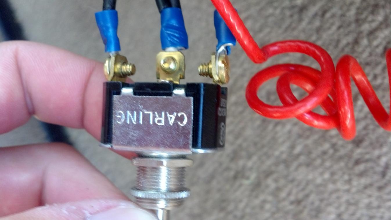

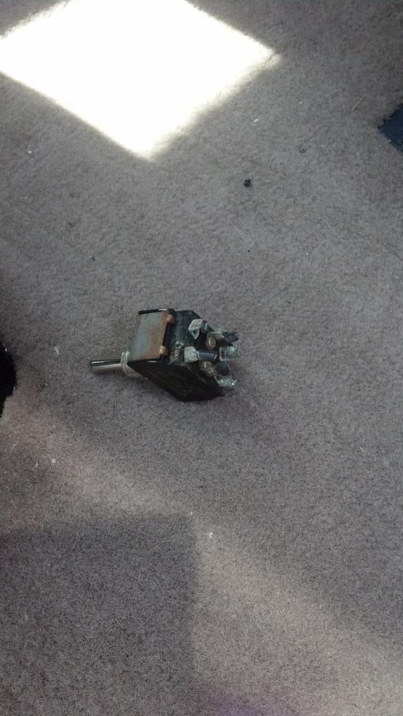

                    I just had the same issue with my 2006 210. It turned out a wire to the switch had a connection that was loosening. I didn't diagnose it until the wire finally broke loose from where it was soldered to the switch. The original switch is garbage, had cheap tabs that the wires were soldered to. Click image for larger version
ID:	366636 Nautiqueparts.com sells one that has screwed terminal post on the back. I replaced mine with this one. Seems much more robust. Click image for larger version
ID:	366637Click image for larger version
