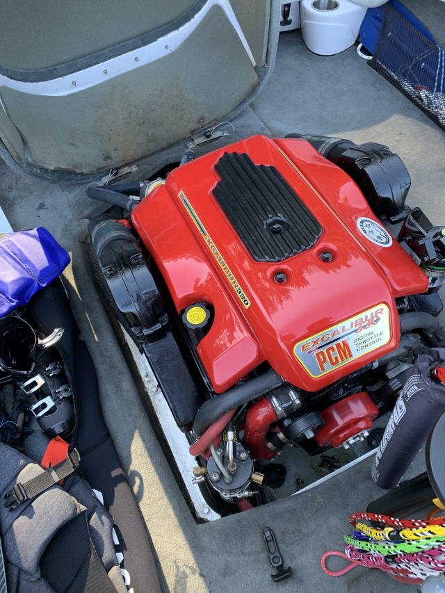

          Thanks for the response! I took another look this evening. Definitely don’t see a hose coming out of the engine in the same location yours is. Didn’t hear a fan (or any noise at all) when turning the heater button on. I also don’t feel any air blowing at all. Here’s a picture of the top of my engine. Anything to you guys look like a heater hose? Hard to see in the way back on the 211, but I’ll try to stick my phone back there and take a picture tomorrow. Click image for larger version

          I’m thinking there isn’t one installed on the boat despite the button on the dash.

              On my direct drive and from the back looking forward, one heater line connects up near the thermostat on the right side of the engine and the second line connects below the right manifold to an engine block drain. Assuming the same points for a v-drive, everything would be on the left side. My heater lines are black.
              You might not have a heater installed. Look under the drivers dash for outlets. There's typically a one at foot level in the kickpanel, a pullable hose outlet and there may be defroster vents on the dash for the windshield.

                  Cataractdaddy - seems like you don’t have the heater core installed, you would definitely hear the blower come on even if the water lines aren’t hooked up. Nautique doesn’t alter the dash controls typically based on what options you have. The button to turn the heater on is there regardless of whether or not it actually installed. The heater core will be behind the kick panel at the drivers feet.
                  in the picture you posted, if you disconnect the black water line from wher it comes off the block - the heater lines attach underneath. I used to have to disconnect the black hose to get at the heater lines so I could blow the water out of it as part of my winterization process.

                      Thanks for the help everyone! There is no heatercore confirmed. I pulled out the trash cubby and nothing was found there - got my ballast tanks removed for an upgrade and got a good luck at the stern end of the engine block - no extra hoses from what i could see were coming off of it.
