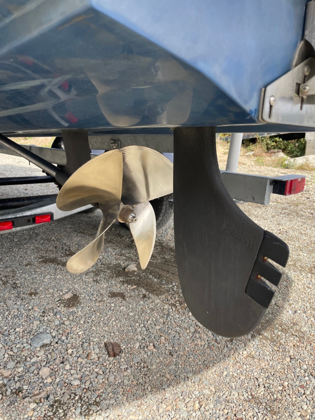

            Prop arrived at noon. Got the boat to ramp/trailer myself, invovled running about a 1/2 mile each way between my place & ramp.
            Used a puller, 645 popped off easily,
            At the helm the 1433 drives about the same, except for the 4K rpm at 34mph ski speed. I saw more prop-wash rooster at slalom speed. Grabbed my neighbor to drive and went for a slalom ski. I've worked a lot to get the skiing to be pretty good.
            Unfortunately, the 1433 introduces a jet of a rooster that I didn't like very much. Still had a decent set though, so I could live with it.
            Heading home, had my modded Ronix Cortez surf with me so gated the boat up and surfed on the way back, no ballast, no gas, no pets & no cigarettes
            Coming out of the water was peaceful, and the wave actually shaped enough to almost ride it. I could get the rope loose but not sustained enough to toss.
            I am excited about the surf possibilities and going to ballast it up before it gets dark.
            Having a crappy surf wave is a real let-down, but a meh slalom set - it's only like 2 doz pulls or so and you're done.
            1433 prop with 3K Ballast, driver, FMSS Gate, swell gate, goofy side wave

                  I got my modded 381 13"x17.5 on there which is actually matches up to an ACME 497. The best for a slalom set, super flat at 32 off with the hydrogate deployed.
                  However I am getting a wobble on acceleration, which might be the prop because it wobbles on the countertop. The shop made it look good and am I sure it is balanced. But I do this flat surface test to see if the blades are in-line and it failed that.

                    I had a wobble when pulling someone up with my old prop. It was a 645 that had been repaired by the dealer or previous owner. Everything appeared fine, but it failed the same test. No wobble with the new prop.
