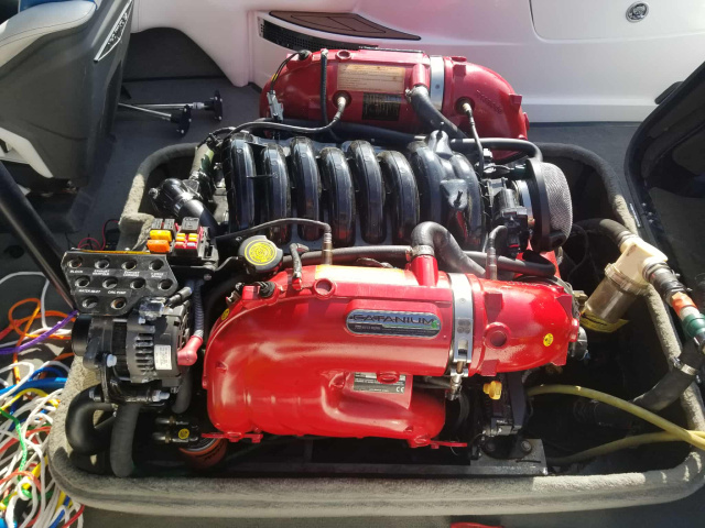

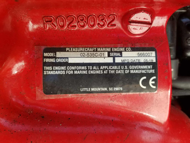

    Hi guys. I'm trying to get help here because I am quite at loss with this one. I did find the approximate engine service manual, and was able to start the engine with the boat harness disconnected. I put 12v on the ignition wire and it cycled the fuel pump, then I put 12v on the starter solenoid and it started, ran fine.
    So when I try to start it from the keypad it does next to nothing. Sometime it clicks (not the starter). I have checked the lanyard. Also when I tried to check it with DIACOM, it did NOT work. Actually it worked once. Then stopped working. It was a sort of intermittent problem, I mean, when I first started diagnosing it, it would start for a second. But now nothing. I did clean all engine grounds, and battery connections, check all boat harness plugs..
    I do not know how to test this control for safety neutral switch, being an electronic control with a 6 pin plug. And also I might be wrong, but I think the fuel pump should cycle even if the boat was in gear?
    I have no clue how to test the boat harness, I do not know what happens when I press the start button, therefore I don't know what to check.
    I hope this makes sense to anyone trying to help. thank you.
