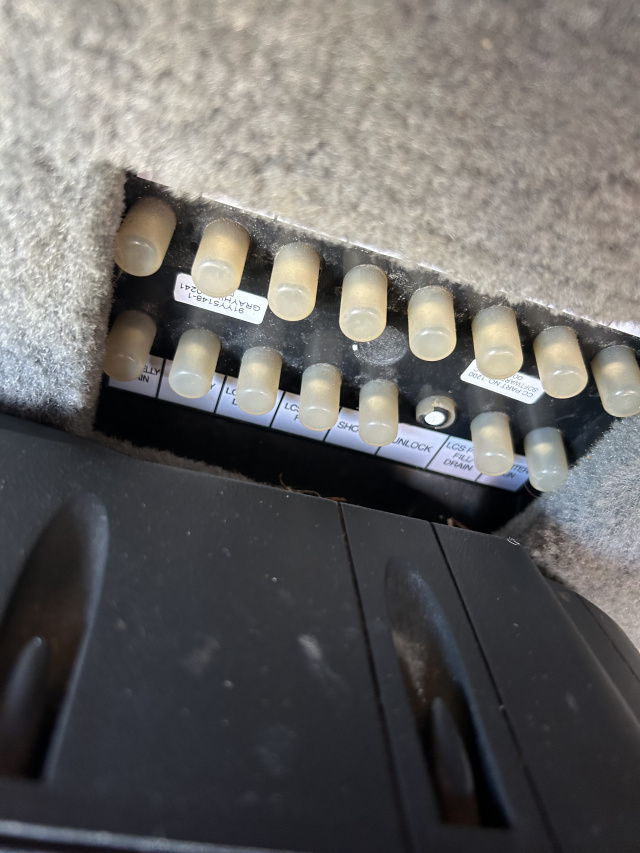

    Anyone know how to access these breakers? I tried to use my outlet yesterday and it stopped working I think I tripped the breaker but now my latches won't unlock (limited) I'm guessing it's same breaker bc it's the only thing not working. 2003 210 SANTE Limited

    If you mean reset them, you just push in on the rubber cover over the breaker. The white button under the rubber cover pops out when they are tripped.

      Dang it doesn't looked tripped then. Are there fuses somewhere I can check?

        There has to be a fuse somewhere that I'm missing. The only thing not working are the two latch unlocks and an outlet

          On my boat (220) there’s the breaker panel at the drivers kick plate, the battery selector switch has a couple breakers, and there are fuses mounted to the engine. I don’t think there are any accessory type fuses in the engine compartment, it’s mostly engine stuff. There might be an accessory breaker with the perko switch (port rear locker), but I would assume any line would feed the entire breaker panel - so nothing would work. The 12v plug on my boat does have a breaker at the kick panel on my boat.
          The breaker might have died… and I think the whole unit is a sealed assembly, so I’m not sure how you would go about checking it. I don’t have any sort of powered latches.
