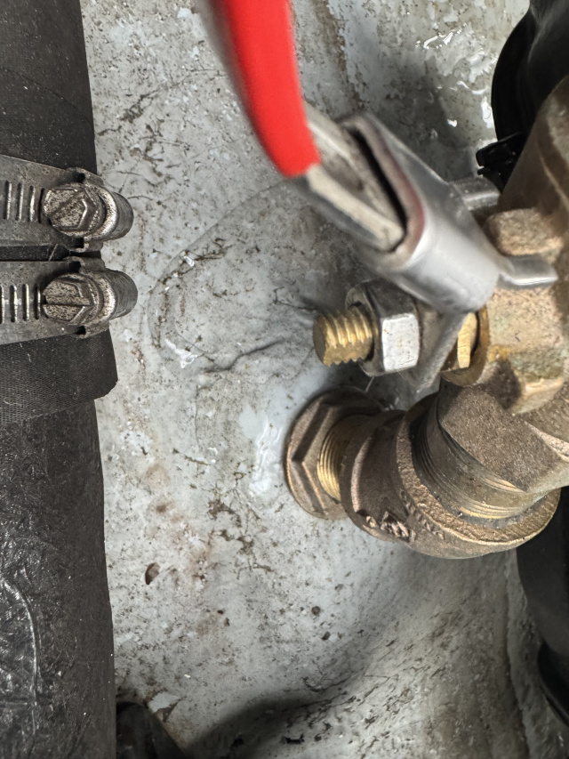

      That is solid advice. I will pull the boat and address. It sits on a lift but boating season is coming to an end here in NH. Hopefully, the video works now. If not here is a photo.

        Did you get this boat new? Pic is a bit suspicious repair has been previously attempted. Movie not working for me.

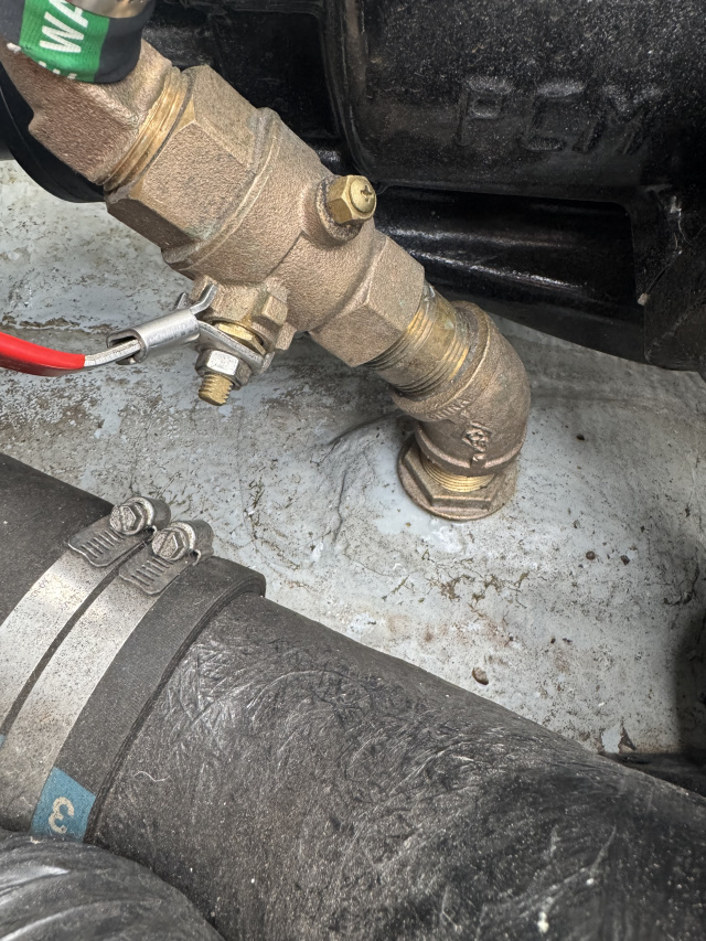

ID:	687346 No. I am the 2nd owner. The first owner did have a run in when trying to load the boat onto the trailer. This could be from that. Here is a 2nd photo.

              Movie still isn't working for me but the picture is a bit concerning to me on the repair. Is the leak coming from the fitting or this area that's circled? I'm not there to look at it but it looks to me from the picture that someone may have tried to repair a crack by laying some fiberglass/resin over the area and it's lifting. It may just be the picture but, looking at the mid to lower left it looks like a crack developing from the larger area. If this is indeed what I'm seeing, this type a lift typically appears when the repair doesn't properly bond to the fiberglass in the repair area and that area is being stressed.
              What does the outside look like? Are you seeing any spider cracks, cracks or anything that looks like it's delaminating?
              If this is indeed the case, I've seen and repaired similar failed repairs which kind of remind me of the RTV on the outside of the valve cover example I mentioned in my previous note. Again, not there to see what were working with and don't want to make any bold statements but if it is indeed leaking from there and there is a crack, it would need to be addressed from both the inside and out. That would bring us to the next questions as to how you want to address it. If again, it's leaking from that area and you have good access you could carefully grind the area back using die grinder with a rotary bit to see if you can see and follow the crack. The idea here is to find the source of the water intrusion.
              If it's not leaking from the area(s) circled and is coming from the nut, I would pull the fitting and see exactly what's going on there and try to determine why the fitting is leaking as obviously, something isn't right. Then there is always option B as well that states if it's not leaking bad you could leave it alone, which would drive me nuts but it is always an option.
