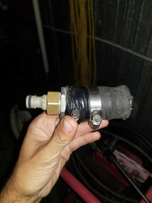

    I am not sure that a hose in a bucket will work.. it will not prime the pump.. unless the bucket has a hole under it and is higher than the pump.. therefore use a special device like ours :
    simple yet effective way to connect water to the engine and do all sorts of things with it. don't put water pressure until you are starting the engine, because it will blow through the gasket or the seals.
