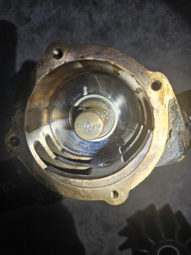

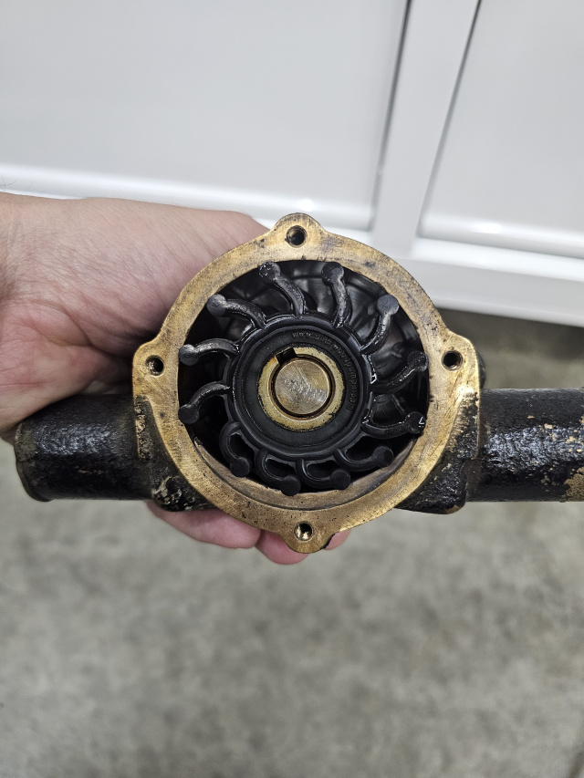

I have a 2003 Air Nautique 206 with the excalibur 330. My raw water pump is not working. I have read as many posts as I can find and have tried everything. I hooked a hose directly up to the water pump to eliminate the strainer and all, still no water flow. I unhooked the hose on the backside of the water pump and I have no water coming out of the water pump. I installed a new impeller and still no flow, old impeller didnt look bad. I don't see how this water pump can physically be installed backwards. Not sure if it is supposed to work this way but I did remove the water pump and filled it to make sure it wasn't leaking internally and it would not hold water. It would just flow through the water pump. Maybe that is normal but it doesn't seem right to me. I am at a complete loss where to check from here or what to do.

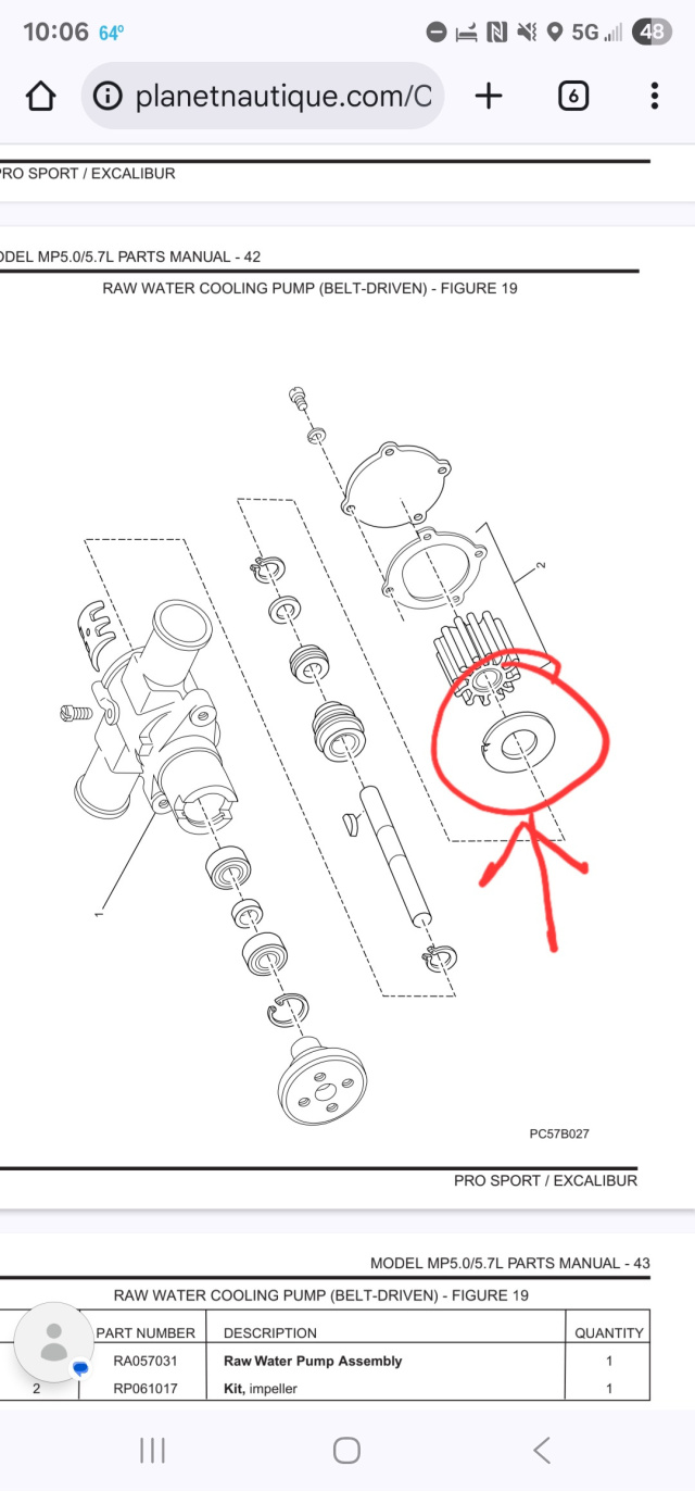

It is possible that you might have the wrong impeller. Early Excaliburs (non-serpentine belt) should use RP061017. That one should be used through 2004, but be sure your engine has two belts if you use this one. If it has one belt (serpentine), use the one below.
Later (serpentine belt) Excaliburs use RP061022, which is smaller and would not pump water on the non-serpentine engines. Are you sure you didn't install the wrong one? It should be a very tight fit.
It is the 2 v-belts not a serpentine belt. I did use impeller RP061017. I would say it was snug but definitely not tight. I was surprised how easily it went in compared to my old mastercraft. Is it possible the inside of the water pump is just worn and needs replaced?
That looks correct to me. I know that if there are ANY air leaks upstream of the impeller it will struggle to pull a vacuum. I had all kinds of trouble with that one season. I had to get it up on a plane to force water through the impeller and then it would be fine. Almost like a priming process. Also if I let is sit for a while and then idle it for a long time sometimes it will get hot, like the water it running out over time. The minute I get it up on a plane it's fine. Any damage/wear to the impeller will cause this also.

All of that looks correct. If you have a hose connected straight to the pump, even without the engine running I'd imagine you'd get a little water through the pump just from the water pressure on the hose pushing past the impeller.
Only thing I have to add is make sure the inner metal hub of the impeller hasn't spun in the impeller itself causing it not to spin the actual impeller when the engine is running.Jason
