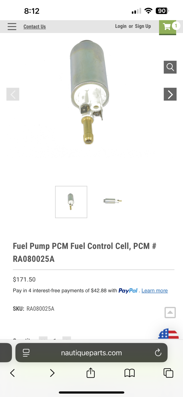

    These are on back order for several weeks from PCM. Anyone have a cross reference to this fuel pump? I don’t want to loose the last part of my boating season. Appreciate the help

    I have used a GSS340 like this- https://www.highflowfuel.com/fuel-pu...2EdGt7fhKSyWuC The problem comes in that there are a lot of fake chinese ones out there buy from a reilable source.

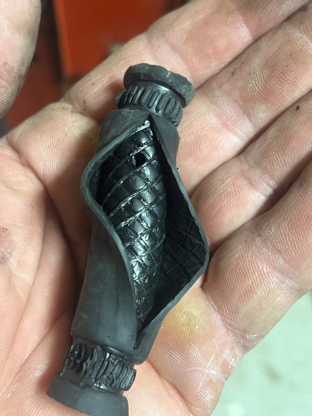

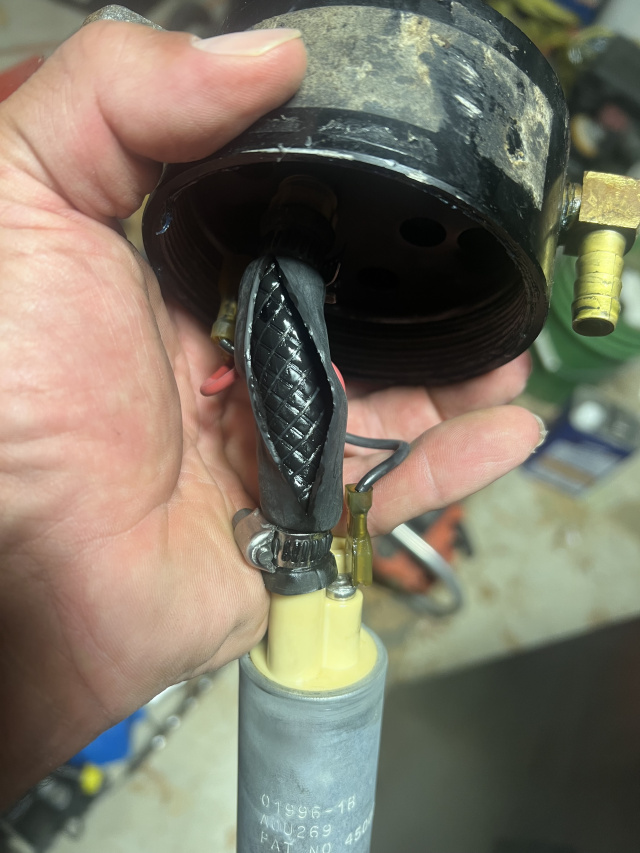

      Thanks Gary! I think I’ll wait until they get back in stock as I discovered my fuel pump is actually not the issue. I decided to open up my FCC the pull the pump and found the short fuel line from the pump had ruptured. I just inspected it 3 months ago when I replaced the filter so I didn’t think it was the hose. They are known to fail. Just to be certain the pump was good I hooked 12v up and it fired up just fine. Curious if this is a special fuel line or can I get it at the auto parts store? Thanks

        https://nautiqueparts.com/internal-fuel-hose-for-fcc/ I tried the auto parts store and had difficulty with a proper match
        also worth mentioning that there is an upgrade wiring kit for wiring on FCC. Epoxy around wiring pass through breaks down and causes fuel leak. https://nautiqueparts.com/repair-kit...trol-cell-fcc/

          Appreciate the feedback Jay. Called around today and nobody carries submersible fuel line. Also good call on the upgraded wiring kit. For $40 that’s cheap insurance. Ordered both items today. Thanks again
