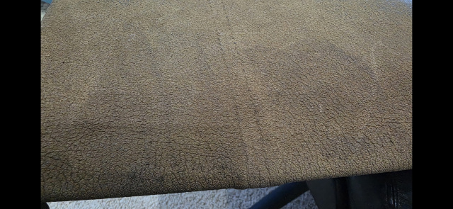

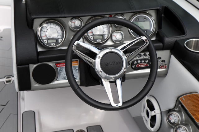

    Hey all,
    I aquired a 2008 Super Air Nautique 230 that I am trying to get back in shape. One of the next projects is refurbishing the dash and I have no clue where to start. I was hoping to replace the pieces but of course they are no longer available. Does anyone know if a different replacement is available and will fit or better, if there is a way to refurbish what I have. I do have all the panel pieces. It is some type of foam material. Thanks!

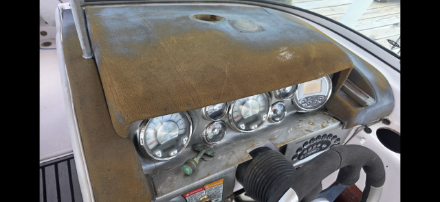

    Is it just discolored or is the top layer worn through?
    • kcautodoc
      • Jul 2025
      • 16
      • Santa Rosa Beach, Florida
      • 2008 Super Air Nautique 230

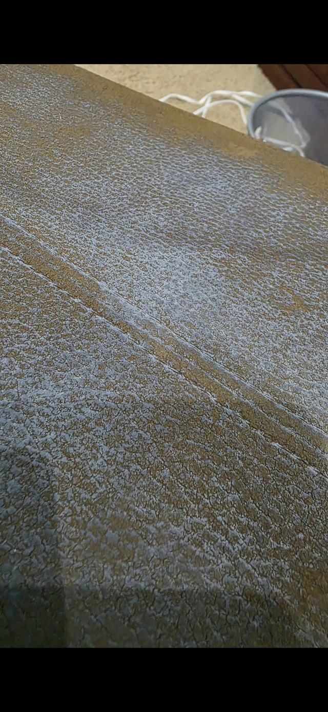

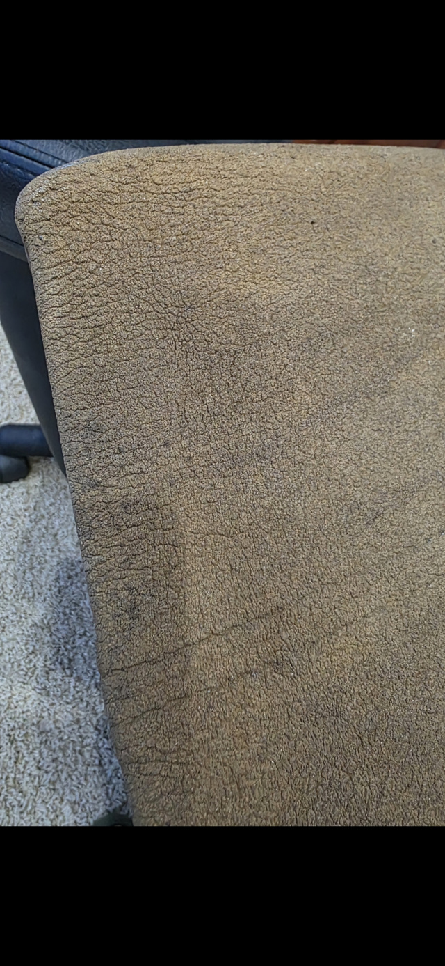

      It's discolored and the surface feels hard and crusty but it stays together if I bend or push into it. I don't need it perfect but I would like to have a nice surface on it even if it loses the stitching look.

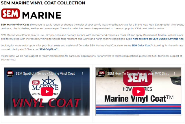

            Looks amazing. What was the process that you used for the dash pieces? I emailed SEM for specifics but have not heard back. I don't know if I just treat it like vinyl or the EVA foam needs a different base coat.

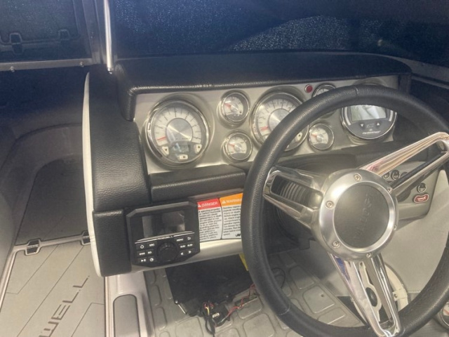

              Personally if i were in your situation, i'd do a test on one on the smaller pieces first.
              All the pieces will come off the dash, most are just held in place with extreme duty hook and loop attachments.
              Remove them from the boat.
              Wash scrub with dawn and a scrubbing brush ensuring you clean every nook and cranny.
              Let Dry
              Once dry, thoroughly wipe over with rubbing alcohol at least twice again ensuring every single part of the piece is clean and free of any contaminants.
              Applying the coating is simple follow the instructions ... do not take short cuts do as the can (s) say.
              Our color change has been in the boat for over 5 years in the harsh Australian sun. ( we put over 200 hours per year on the boat ) it is still as good as the day we appiled it and looks OEM.. no one can tell it has been refurbished or that it didn't com from the factory that way. Click image for larger version

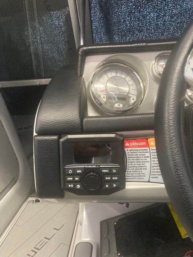

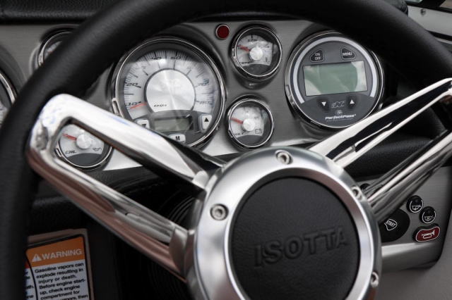

                        kcautodoc did you ever hear back from SEM regarding product recommendations? I'm really interested what they may say regarding color. My vinyl is gray as is most of our interior trim, so I'd be reluctant to go with black. ALSO, looking at your original image you have removed the dash vinyl/foam pieces around the steering wheel which I'm having issues with. All the others came off easily. Do you recall what you did to remove those?
                        Spud do you recall how the vinyl/foam around the steering wheel column and the small piece on the far left are attached?

                          Both of these pieces are attached to SS plates that have bolts welded to the and do up with nuts from behind!
